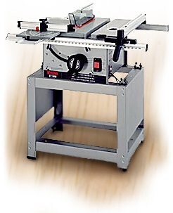

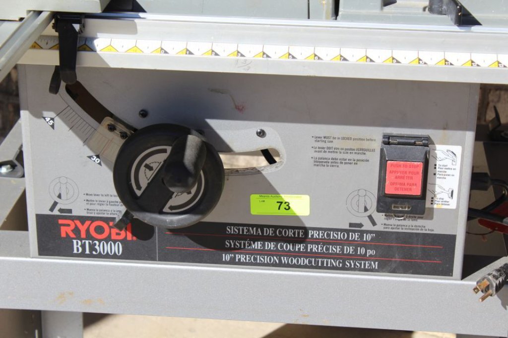

    Classic BT3000
    the sliding miter table sliding base is the giveaway; the square stand and the red Ryobi logo and "BT3000" in the lower left, in the black strip that says 10" PRECISION WOODCUTTING SYSTEM in three languages on the right and the red switch and the recognizable closed black elevation handle. Silver rails
    Click image for larger version  Name:	4b63df5bcf6447db7d3d4313fee26c06.jpg Views:	0 Size:	12.9 KB ID:	853295 Click image for larger version  Name:	image_23669.jpg Views:	0 Size:	17.5 KB ID:	853304 Click image for larger version  Name:	73-1.jpg Views:	0 Size:	101.7 KB ID:	853297 Click image for larger version  Name:	Artists BT3000.jpg Views:	0 Size:	40.8 KB ID:	853314

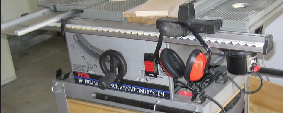

    the majority of BT3000 looked like the above, there were some very early ones that were slightly cosmetically different in the text 10" PRECISION BENCHTOP WOODCUTTING SYSTEM and open black handle as shown below: Also some with a recalled red and green two-pushbutton power switch.
    Click image for larger version  Name:	Early BT3000 front.jpg Views:	0 Size:	54.5 KB ID:	853310

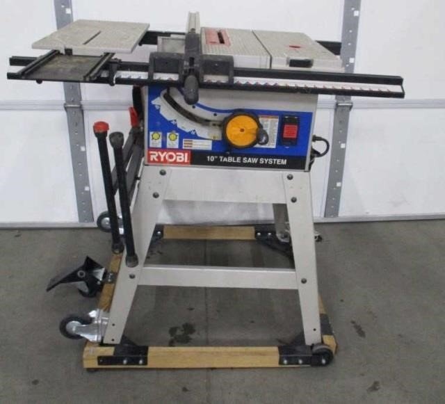

    classic BT3100
    splayed gray stand, Red ryobi logo and 10" Table Saw System on the black and bottom and blue trim on the face. The yellow and black elevation handle. The black sliding miter table base.& black rails
    Click image for larger version  Name:	images (9).jpg Views:	0 Size:	8.4 KB ID:	853298 Click image for larger version  Name:	img (3).jpg Views:	0 Size:	45.2 KB ID:	853299

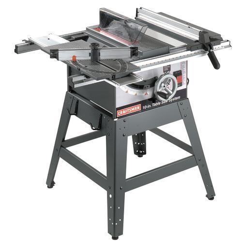

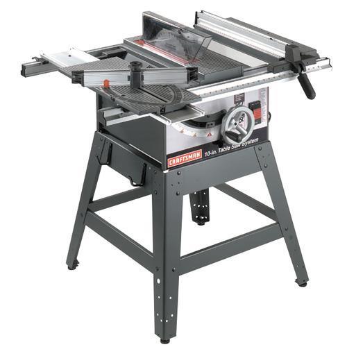

    Craftsman 22811
    Gray trim, splayed base, Craftsman Logo, 10" Table saw System label on bottom, smooth silver open handwheel, silver rails
    Click image for larger version  Name:	Craftsman 22811 (2).jpg Views:	0 Size:	26.3 KB ID:	853303

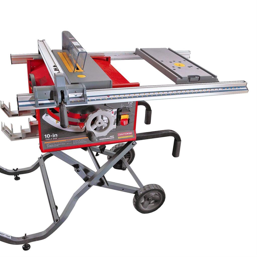

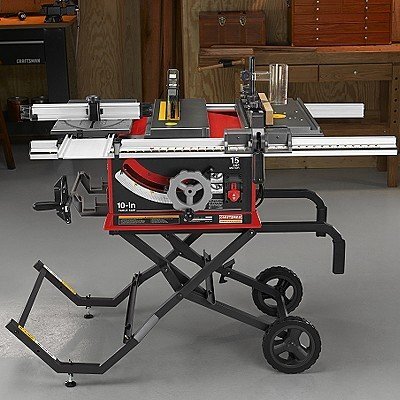

    Craftsman 21829
    Prominent Red trim and cabinet, gravity rise base. the sliding Miter table, gray plastic knurled open handwheel, extra long silver rails. (the pic on the right is missing the Sliding Miter Table)
    Click image for larger version  Name:	Craftsman 21829 (1).jpg Views:	0 Size:	45.2 KB ID:	853300 Click image for larger version  Name:	Craftsman 21829 (3).jpg Views:	0 Size:	95.3 KB ID:	853302

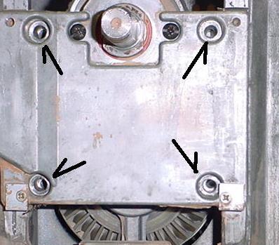

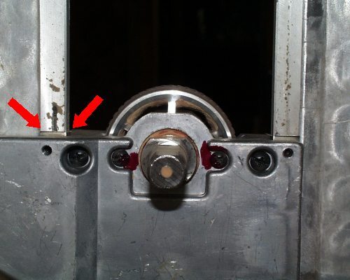

    The last thing, if its a BT3000, make sure the shims are in place, otherwise you have a lot of work in store.
    This is the BT3000 with the blade removed looking at the end of the arbor and the bracket that slides the motor assembly up and down to raise the blade. The red shows the tops of the shims they have a little fold over that keeps them in place. You can see them if you raise the blade and peer behind the blade with a flashlight. After you get the saw keep the area clean and paste wax the two vertical ways you see here that they ride on. Wax all three sides of the ways and on both sides of the opening.

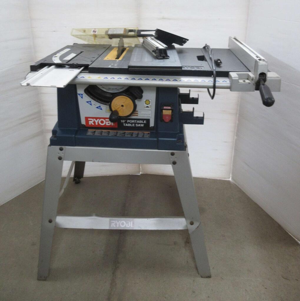

    There are a few Ryobi models with a sliding table but not true BT3 clones. These have plastic molded bases which makes them easy to spot if you do see the sliding miter table, and they are labeled 10" PORTABLE TABLE SAW. YOU DON'T WANT THESE.
    Click image for larger version  Name:	cd94fbabde496020afbf0afb965aad96.jpg Views:	0 Size:	88.0 KB ID:	853309
