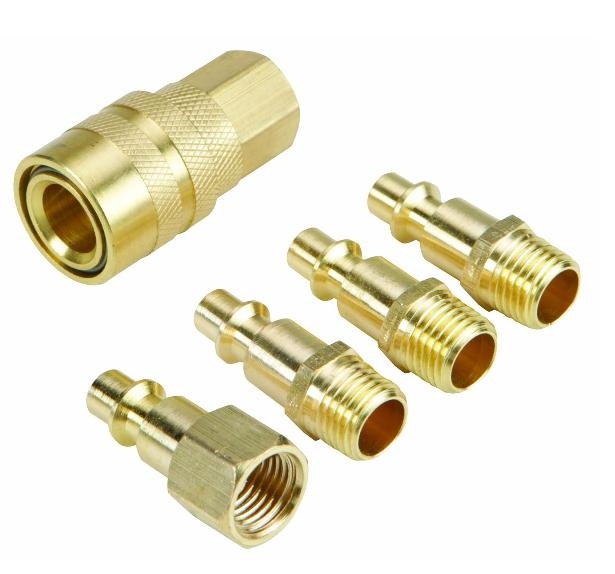

    Example of QD fittings at Harbor Freight -
    http://www.harborfreight.com/5-piece...set-68237.html
    The above picture has one female QD to female 1/4"NPT, three male stud to male 1/4" NPT, and one male stud to female 1/4" NPT.
    Note the male stud and female QD, the "sex" depends on the part that mates with each other. Depending on the hose and or the tool, the NPT fitting is usually a 1/4" male or female NPT. There's actually then four types of fittings:
    Female QD with 1/4" male NPT
    Female QD with 1/4" female NPT
    Male stud with 1/4" male NPT
    Male stud with 1/4" female NPT.
