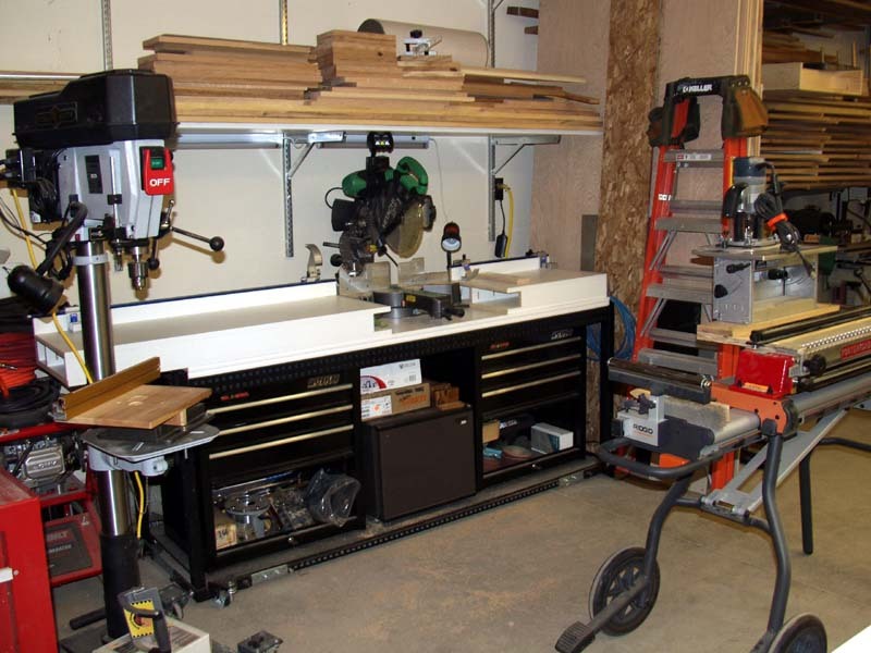

    I own this saw. It is a good one. Nice shallow depth for a 12" slider (vs. other saws of a similar price point). I now use mine on a stationary bench. It was $409 at Amazon when I bought it in early 2008. It has a vertical grip which some people like - I find it comfortable with both hands. it is also a soft grip handle.
    I like the LED light optional attachment of the DeWalt's better than the single sided laser of the Hitachi C12LSH. The LED casts a shadow line over the blade and you can see each side of the blade down to the individual teeth.
    The miter and bevel angles are also displayed via the LCD panel. It works well enough for me. Most times I do not use it though. Just an extra IMO.
    The detent plate is stainless steel. The handles to adjust the micro bevel also work well. Right and left positive stops are also plenty.
    The motor is 15amp and seems very powerful. Does not stop as fast as the Dewalt I own but still nice.
    Blade changes are easy enough but not tool free. The saw includes a box wrench.

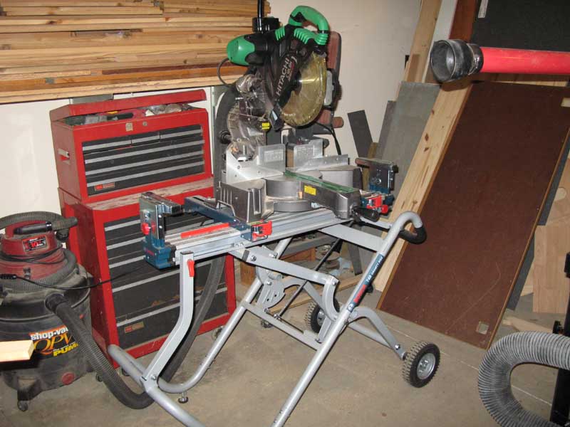

    The saw is heavy. I had it on a Bosch T4B gravity rise stand. The mounting hole placement in the saw base made that mounting kid of goofy. It would not line up its fence with the extensions of the base. I would recommend that saw be used on a different stand (maybe a Ridgid MSUV) or be mounted on a sub table and then mounted on the T4B stand. Ideally I like it in the shop on a miter saw table setup.
    One caution though - I had some damage in shipping on mine. enough to get 20% off and I had to get a new handle from Hitachi. This saw is NOT well packaged so be prepared for some rolling in shipping if the carriers are not careful. Inside the big box is the saw and just a couple pieces of cardboard holding the saw in place.
    You will like this saw, especially if you can buy it around $450!
