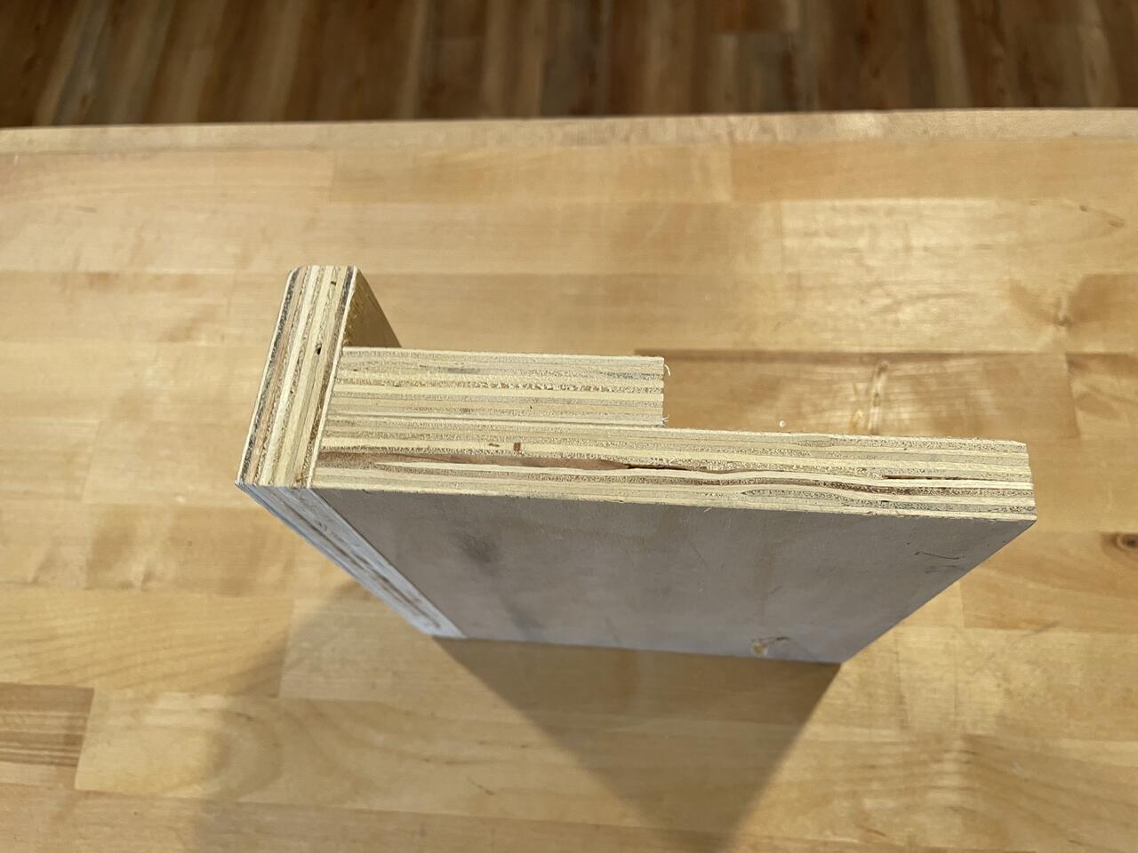

    Building the fence was a straightforward process. The documentation required that the fence be .75 inches thick and 2.25 tall for the swing stop to function properly. I cut the face of the fence from .75” birch plywood and mounted it at right angles to 3 and 6 inch stacked pieces of the same plywood.
    Fence Cross Section
Name:	fence cross section.jpg
    Then added leftover laminate to the face which left my fence face slightly over .75” but that hasn’t been an issue. Installing the top track was where the only issue came into play. The individual segments of the track need to be perfectly aligned. I had one joint that was offset by less than a half millimeter and the stops hung up every time it was moved over the joint. Correcting the alignment was time consuming but worth it. It would be nice if the individual section of track could have keyed alignment of some sort to make and keep the alignment. The fences ended up at about 3250mm or 10’ 8” both to the left and right of my miter saw saw table ends. That yielded nearly 12’ of cutting capacity to either side.

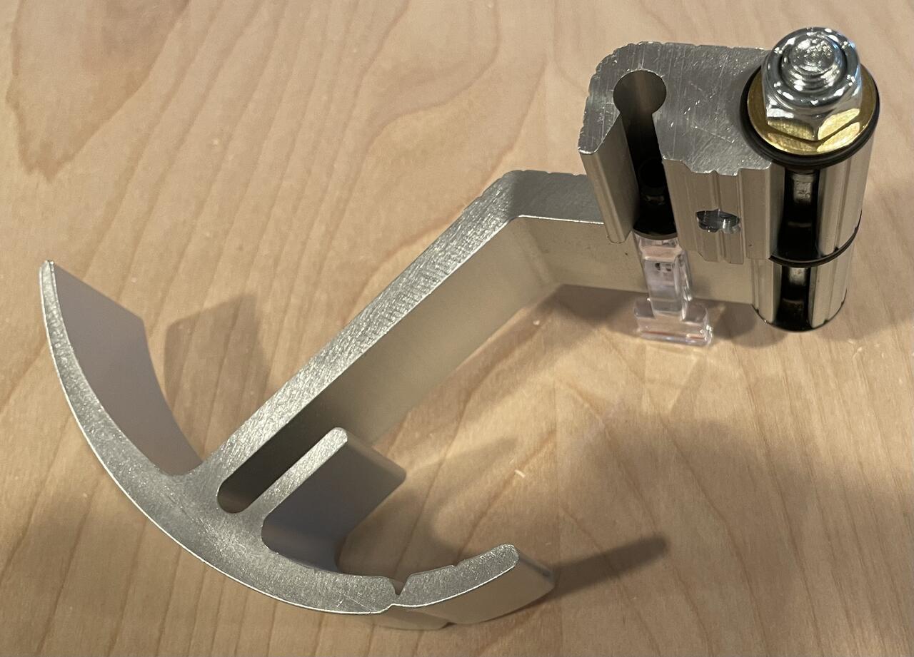

    The bottom of the swing stop rests in the t-track and the front aligns with the lip of the top track to keep it square to the track.
    The swing stops slide on the track easily but can be a bit finicky to adjust. If you get them too loose, it is difficult to keep the stops square to the track, and if it is too tight the stops don’t move easily. It needs to be snug enought that the front of the stop mounting block doesn't ride up over the edge of the Top Trak. Once you get the feel for it though setting the stops is quick and accurate. Each stop has a cursor that is adjustable +- about three sixteenths of an inch. The cursor is clear and makes it easy to read the tape below. A nice design feature is that it raises and lowers with the swing stop making it easy to clean dust off the back side so you always have a clear view.

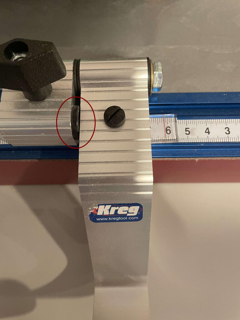

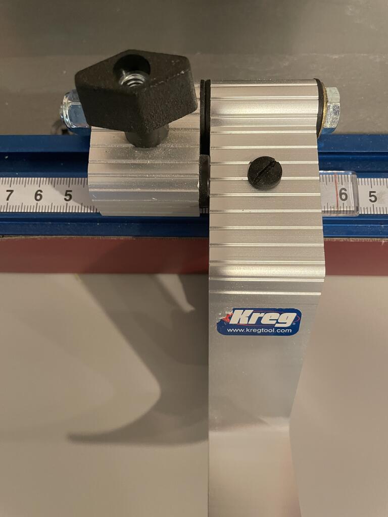

    One problem with the swing stops that took a bit to figure out was that they need to be configured to be either left or right. Depending on how it is configured, pushing one way gives almost no deflection and pushing the other way can give about a sixteenth of an inch or more with only moderate pressure as the pivot point flexes.
    The stop pictured below is configured to be to the left of the saw. Pushing the arm of the stop to the left compresses it agains the plastic stop. Pushing to the right opens a gap at that stop and allows significant deflection. The stops are shown configured both ways on the Kreg site, but no explanation is give either on the site or in the relatively scant documentation.
    No deflection

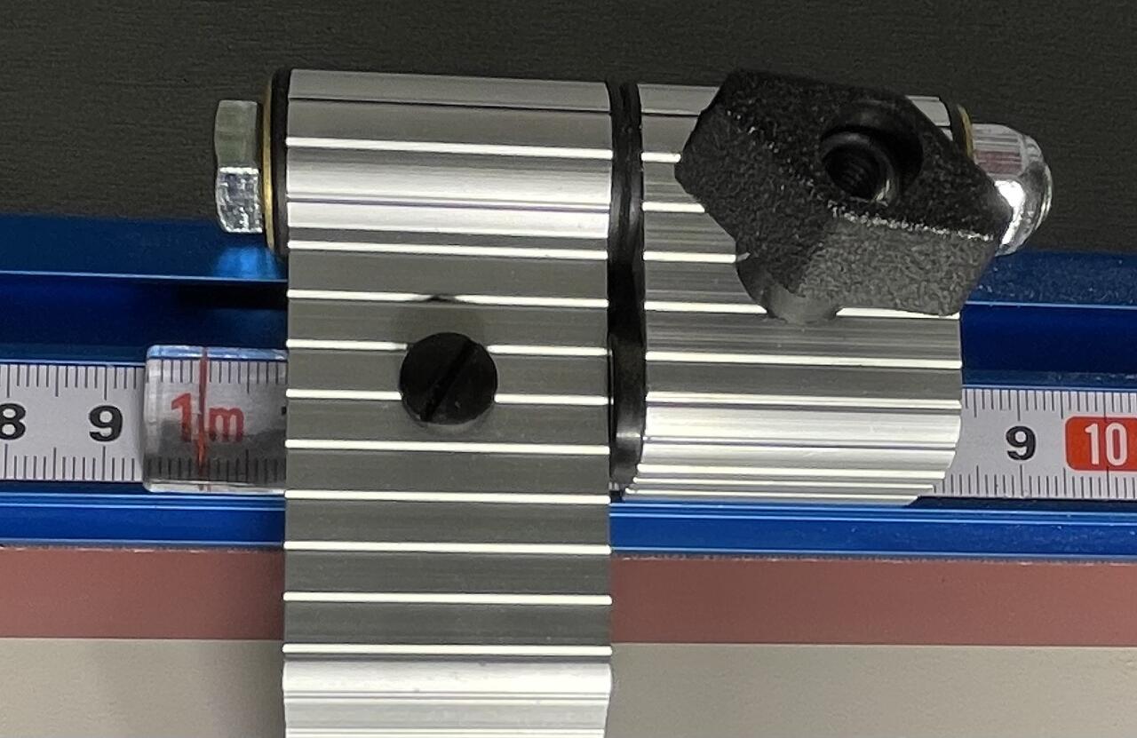

    Gap opened upnext to pivot point, moderate pressure with one finger. Notice the angle of the cursor
