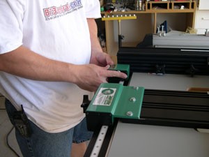

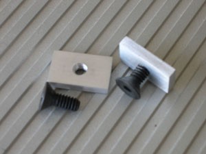

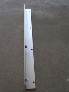

    I found the Saw Train installation process very straight forward. The Jointech rails mount to the BT3's rails using a pair of specially machined brackets. (fig. 1) These brackets allow the Saw Train to attach to the BT3's existing rails, but do not require any custom modifications to Jointech's original rail design. This accomplished two very important objectives. First, it allows the BT3 owner to retain the Sliding Miter Table and did not require Jointech to design and manufacture custom rails just for the BT3. Such a redesign would have made the development of the Ryobi Saw Train cost prohibitive. In order to compensate for the profile of the front rail, Jointech includes two plastic "donuts" that act as shims under the front rail. (fig. 2)

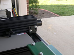

    After the brackets are installed, it was time to mount the Saw Train's rails. BT3 owners will feel real comfortable installing the Saw Train's rails because the process is very similar to the way the BT3's rails mount to the saw. Jointech provides aluminum t-nuts and machine screws (fig. 3) to attach the rails to the bracket. (fig. 4) The rails are very easy to slide onto the brackets and they attach very securely. (fig. 5)

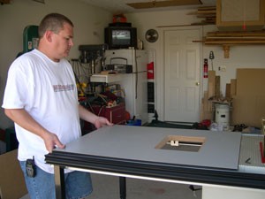

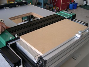

    The STL-1 telescoping table legs give the rails a very good amount of support. (fig. 6) With the Jointech rails successfully mounted to the BT3100, I installed the STT-2736M 27" x 36" melamine table. (fig. 7) This is one outstanding extension table. It is 1 1/8" think MDF that is laminated on both sides and edge banded. Additionally, it comes with a 9-1/4" x 11-3/4" cutout that will accommodate any one of Jointech's five router plates. The table mounts to the rails using six very sturdy machined L-brackets. Four of these L-brackets mount to the Ryobi rails (fig. 8) and two mount to the specially machined aluminum mounting brackets. (fig. 9)

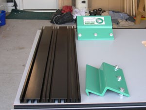

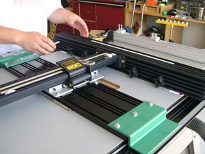

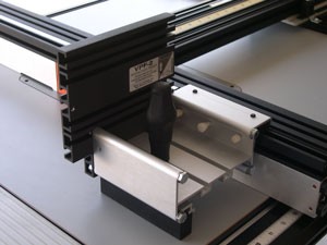

    After attaching the brackets, rails, telescoping legs, and extension table to the BT3100, it was time to move to the Sliding Bridge Assembly. (fig. 10) The Sliding Bridge Assembly slides on the rails and attaches the Clincher Machine (fig. 11) to the saw. It is important to square the Sliding Bridge assembly to the blade, so to accomplish this I put the BT3's rip fence on the saw (since I knew it was square to the blade) and then used a piece of MDF with two perfectly parallel edges to square the Sliding Bridge Assembly. (fig. 12)

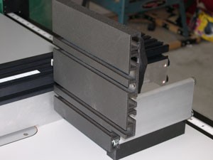

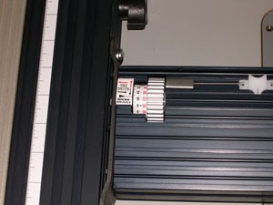

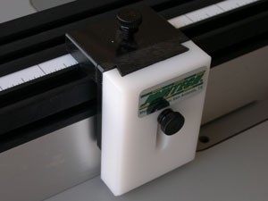

    After squaring the Sliding Bridge Assembly I moved to attaching the Smart Fence. (fig. 13) The Smart Fence attaches to the Clincher with two screws and nuts. The Smart Fence then slides on the rails on two front and rear fence brackets. (figs. 14 & 15) After Installing the Fence Brackets I squared the fence to the blade using the same piece of MDF that I used to square the Sliding Bridge Assembly to the blade. I mounted my Hitachi M12V to the included router plate (fig. 16) and dropped it into the hole provided in the extension table. (fig. 17) The installation was now complete. (fig. 18)

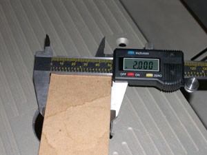

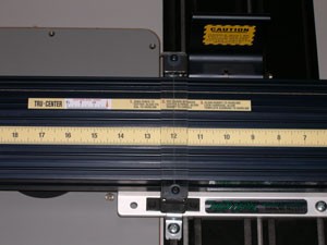

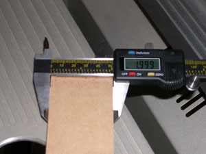

    At this time I have not had a chance to complete a full project using the Saw Train but I did do some test cuts with some ¾" MDF. I "zeroed" the Smart Fence to the blade and then placed the 12" mark on the tape measure on the Clincher directly under the Anti-parallax Cursor. (fig. 19) Using the Micro-adjust Thumbwheel (fig. 20) I moved the Smart Fence 2" away from the blade. I ran a scrap of ¾" MDF through the saw then using my Harbor Freight digital calipers, I measure the piece. (fig. 21) Again using the Micro-adjust Thumbwheel, I moved the Smart Fence one click towards the blade and ran another test piece. Once again the digital calipers measure the results. (fig. 22) Granted, tolerances this minute are not necessary when working with wood, the accuracy and repeatability demonstrated by this test speaks volumes for the quality and construction of the Saw Train system.

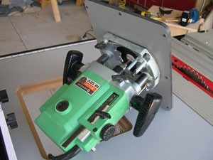

    My overall impression of the Saw Train is that it is a very well designed and well built machine. By integrating the router table into the table saw's extension table, the Saw Train doubles at a precision router table fence. Included in the Saw Train kit are 60 joint making templates that are normally included with the Jointech Cabinetmaker's System. The Jointech Clincher and Smart Fence make easy and precise work of cutting through and half-blind dovetail joints, box joints as well as several complicated joints like double-double box joints, double dovetails, and Jointech's exclusive "Boxtails". Also included in the package is the Vertical Push Fixture II (figs. 23 & 24), and a stop block. (fig. 25) The Vertical Push Fixture securely locks into the Smart Fence's dovetail slot for making end-grain cuts. By design, the fixture locks into an extruded dovetail slot on top of the Smart Fence. This design makes it impossible to tip over or kick out during use as opposed to a fixture that hangs over the fence. Provides smoother, accurate control while holding work square to the fence and table.

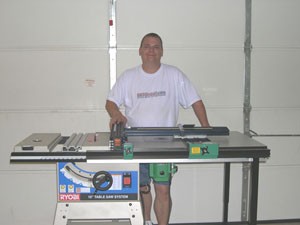

    In conclusion, I am very impressed with the Saw Train System. As a longtime owner of a Jointech Cabinetmaker's System, I have been eager to retrofit my Clincher and Smart Fence onto my BT3100. Now that I have the Saw Train System on my BT3100, I am eager to tryout some ideas I have been cooking up for some products. Though the cost of the Saw Train initially seemed steep, once I took into consideration all that the kit included as well as the full capabilities of the system, I feel that the system is a good value. If you have questions regarding the Saw Train System or if you are interested in purchasing one, visit the Jointech web site.
