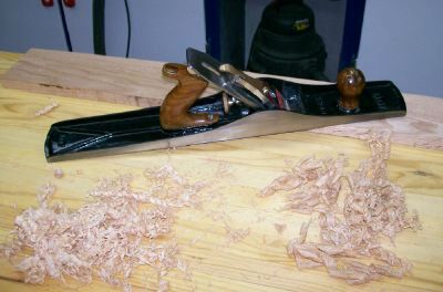

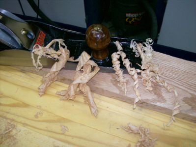

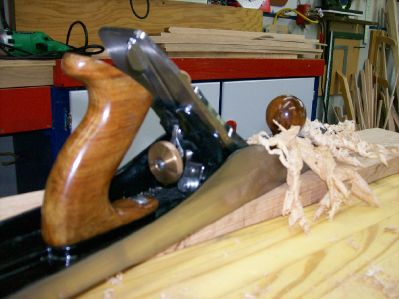

    Will I keep the plane as my keeper? Yep.. as today it is as good as any other with the way it cuts. But... only after I basically re-surrected the plane from the "dead" with over 12 hours work. It was free and now it is useful as opposed to useless when I took it out of the box.
    Fine shavings... medium shavings are illustrated below.. after a lot of work. That's all I would have ask for in any plane. Sometimes you just have to weigh the value of the journey.
