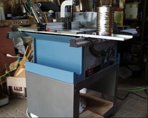

    3. Next, I never liked the plastic holders provided on the sides of the saw base for storing the miter fence and rip fence. I find them too stiff to use regularly, and since sawdust drifts down between the main saw table and the SMT on the left, and the accessory table on the right, it collects on whatever is left in the clamps, anyway. So I removed the plastic clamps (I'll use them later for hanging tools on the wall) and in their place I built boxes from 1/2" plywood on either side of the saw. Since the plywood was an inexpensive grade and not particularly attractive; I finished it with some leftover latex paint. The color is called "Old Blue" and rather easy on the eyes, I think. Here's what the left side box looked like before I mounted it on the saw.
    Left Side Box for BT3K
    And after it was mounted on the saw:
    I attached the boxes to the saw frame using a single bolt through the center frame hole (where one of the plastic clamps was formerly installed). To make it easier to install and remove the mounting bolt for regular inspections and maintenance, I glued the bolt's washer and nut to the underside of the frame with some epoxy. I also placed some thin adhesive rubber padding on the curves of the boxes, to protect the painted finish from the miter and rip fence when they're stored there.

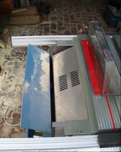

    As you can see, I built the boxes with angled roofs; their purpose is to catch sawdust drifting down from the table and direct it into the gap between the box and the saw, into the dust-collection pan below. Nothing will catch 100% of the dust, I suppose, but this does a pretty good job, as seen in the next photo (shown with sliding miter table removed):

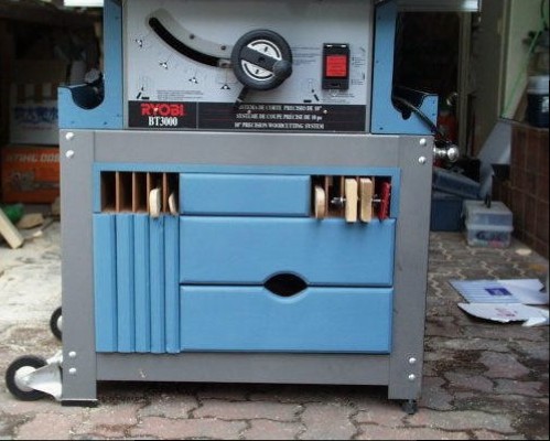

    4. Finally, I made a lower cabinet also mostly from 1/2" plywood, with 1/4" plywood drawer bottoms. The entire thing is dadoed and rabbeted together, and the dimensions match those of the steel frame so closely that it's almost scary. I could practically hear air hissing out as I slid the= carcass into the frame after it was done. For the drawer faces, I used pieces of pine and fir I had left over from my CD-Cabinet project last year. To match the side holders I'd built earlier, I painted the drawer fronts the same "Old Blue" color, although I used a tan color on interior parts.
    Main Cabinet
    (This photo was taken just after completing it, so I haven't yet put drawer pulls on the top drawer or the blade racks.)

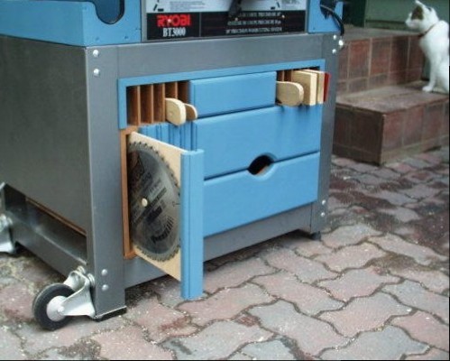

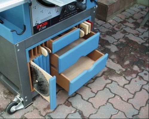

    The cabinet has 10 narrow slots that I use for storing feather boards, extra throat plates, and smaller push sticks. Of the three drawers, the upper one is rather shallow (only about 10 inches deep), a necessity in order to clear the dust pan that dips down toward the back of the saw right above it. I plan on using that drawer to keep saw and router wrenches, the rip fence micro-adjuster, a small try square and related tools.
    Perhaps the most original (or gimmicky?) thing about the cabinet is the blade holders. Each of the vertical pine faces is grooved to hold a 6 mm piece of finish plywood. In turn, the plywood pieces slide in dadoes cut in the carcass of the cabinet. In the center of each piece of plywood is a short (about 30 mm) piece of 15 mm dowel pounded through a 14 mm hole. I store extra blades on the dowel arbors, and hold them in place with 14 mm rubber faucet washers.
    Saw Blade Racks Slide in Grooves
    I'm still experimenting with the means of holding the blades in place, however. If the rubber washers prove too insecure, I may drill small holes near the ends of the dowels and insert cotter pins to hold the blades on the dowel arbors. One could also cut grooves in the top of each "arbor" and let the blade simply rest there by gravity. Each of the five blade holders holds one blade on either side, so a total of 10 blades can be stored, although I think I'm going to add some additional dowels to one of the holders to hold the chippers of my Freud dado set as well.
