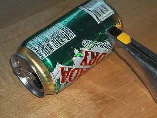

    Step 2: Cut out a 2" circular section from the middle of the can. Cut the circle to make it a strip. Be careful, the aluminum is very thin and sharp. The knife can be dangerous, too.

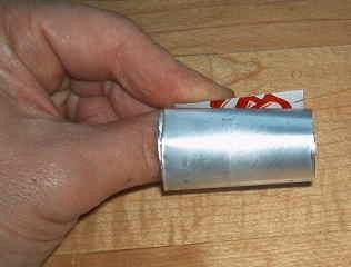

    Step 3: Roll the strip of aluminum "inside out" and release so it will lay flat on its own. About my thumb's diameter worked for me. If requested by email, I will send a full-scale picture of my thumb back.

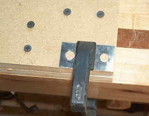

    Step 7: Screw four deck screws through the scrap wood, but missing the shim stock. Align and clamp the stock shim with the outer edges of your wood/aluminum/wood sandwich. Using a 23/64" brad point drill bit centered on the stock shim holes, drill through both holes and through the shim stock. Alternatively, mark the center of the holes, remove the clamp, and drill down through the shim stock.
