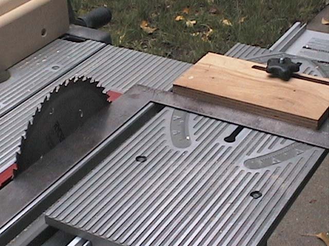

    Click image for larger version  Name:	ms-jigat0002.jpg Views:	1 Size:	90.2 KB ID:	834255
    I use a similar attachment method for my jigs. An attachment block is fixed to the bottom of the jig. The block consists of a piece of plywood with a wooden dowel glued into it to serve as a pivot pin. There is a hole for a hex head bolt to pass through as a clamp.
    I don't usually require that the jigs that I attach to the table be moved in and out. In fact often I want to prevent that movement of the jigs. The pin on my attachment block is fixed, so that the block and therefore the jig cannot move in and out. I would like the jigs to rotate, however. Rather than drilling a simple hole for the clamp bolt, I route a slot along the attachment block to allow the rotation. A sketch of a typical attachment block is shown below.

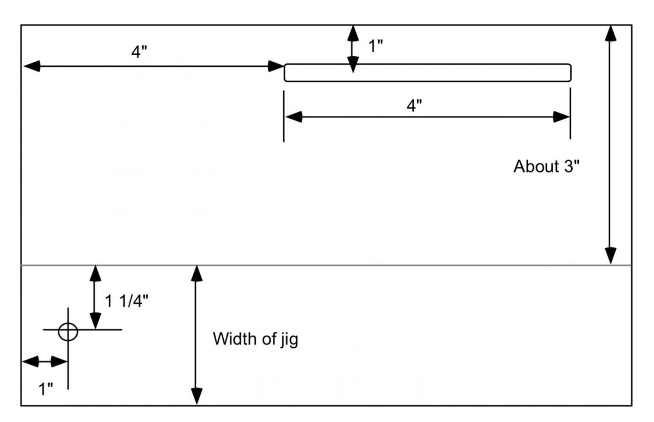

    Click image for larger versionName:	ms-jigat0005.jpgViews:	1Size:	46.5 KBID:	834259
    Making the Attachment Block.
    1. The first thing to do is determine the rough dimensions of the attachment block. Measure the width of the jig you'll be attaching. You'll need a piece of 1/2" or 3/4" plywood about 10" long, and wide enough to accommodate the jig plus room to turn a clamp handle (say about another 3"). Cut a rectangular piece of plywood this size, identify the front edge, and mark the approximate jig location on it. 1 1/4"1"Width of jig1"4"4"About 3"
    2. The next step is to drill a hole for the pivot pin. The pivot pin should be located about 1 1/4" in front of the back edge of the jig, and at least 1" from the side of the attachment block. Drill a through hole at this location. If you have a 10 mm drill bit, that is fine. I don't, so I drill the hole with a 25/64" bit. Cut a 3/8" wide slot about 1" from the back edge of the block and parallel to it. Begin the slot 4" from the side of the block with the pivot pin, and make it 4" long.

    A weakness of the design is that the depth of the attachment block and clamp bolt prevents the jig from being moved back to a forty-five degree angle. You'll have to do a little more work to give your jig that full range of movement.
    I need to give a little explanation of my photo on page 1 at this point. If you compare it carefully to the descriptions and sketches below, you’ll note that there is a gap between the bottom of the handle assembly and the attachment block in the photo. That is because I disassembled the jig to take the photos. Since I had it apart, I decided to provide a little thicker runners. Before I could complete the modification, it started to rain. My saw was outside for the light, so I had to take the photo and get it in. I hadn’t redone the handle assembly to fit the thicker runners. Sorry. Do as I say, not as I had done.

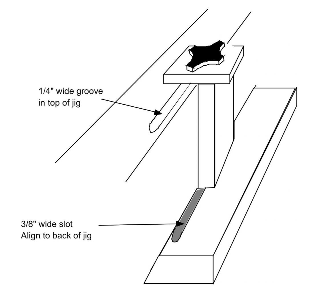

    Click image for larger versionName:	ms-jigat0006.jpgViews:	1Size:	56.4 KBID:	834260
    16. Route a 1/4" X 1/4" groove in the top of the jig, centered 1/2" in from the back of the jig. The groove should be directly above and as long as the 3/8" slot in the attachment block. 3/8" wide slot Align to back of jig1/4" wide groove in top of jig
    17. Reattach the modified attachment block to the jig. Run a 5/16-18 bolt through the attachment block, long enough to extend at least 1 1/2" above the top of the jig. Assemble the clamp on the jig as shown, with the tenon in the 3/8" slot. Place the two dowels in the groove in the jig. Add a washer and knob to the end of the bolt. 3/4"Same as jig depth + 1/4"3/8" through hole Align to groove1/4" dowels1/4" dowels extend 1/4" from face Fit to groove in jig top1 1/2 "2"5/8"1/2"Leave 3/8"wide x 1/4" long tenon: slides in slot to keep clamp aligned.3/8" X 3/8" groove the length of vertical piece
