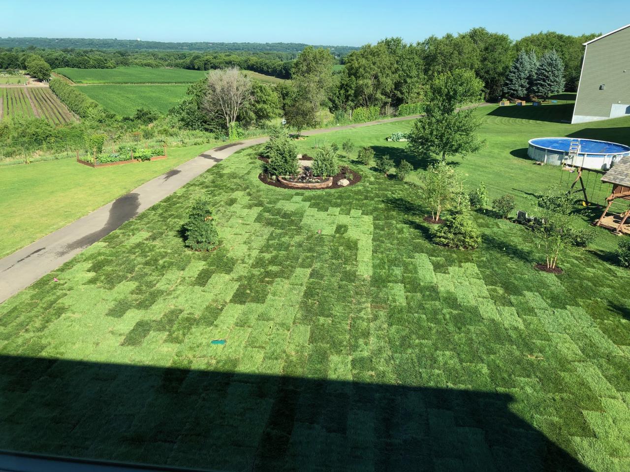

      The last lawn of the neighborhood was installed on Friday at our house and I spent yesterday wet and muddy getting the sprinkler system adjusted. Now I can finally get the permit for the deck, and once that's done I can finally start on the new shop.
      Last lawn of the neighborhood is installed

        I'm sneezing just seeing all that green stuff.
          • 3756
          Dang what a view!
          What row crop is planted across the street?
          how does above ground pools hold up to the low temps
          what gras sod did you plant?

            capncarl The "crops" are part of Bailey Nursery but due to covid, they aren't allowing anyone but employees on the site. They look like lilacs but my binoculars aren't good enough for me to see the leaves. The pool gets drained for the winter and the liner is taken out. We had a neighbor when I was a kid that left their ingound pool filled over the winter and the subsequent ice cracked the sides. For the rest of my childhood if you wanted to use the pool in the summer, in the spring you had to help scrape out the old caulk and clean the cracks with a wire brush so Mr. Fritz could re-caulk the pool for another season.

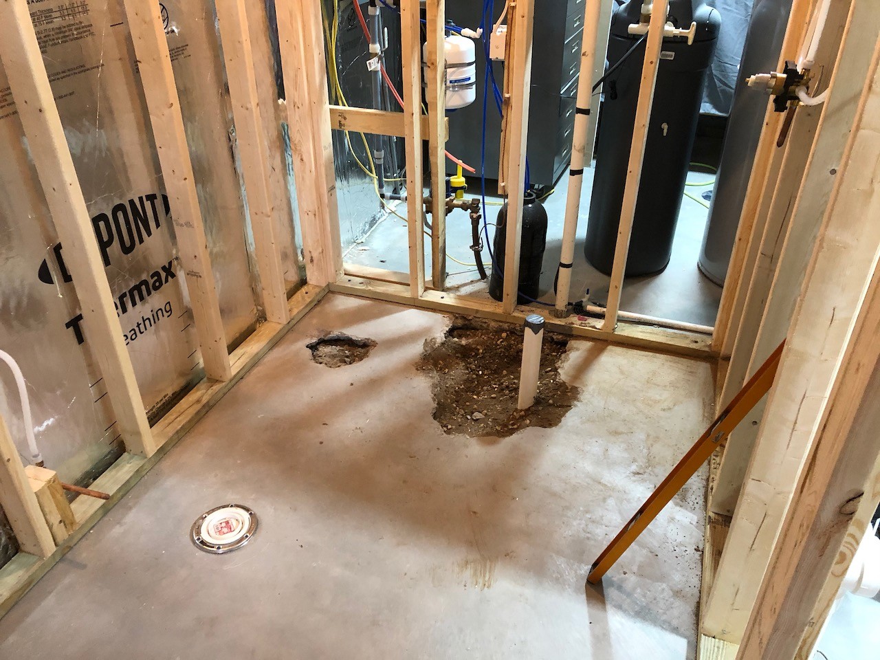

              This is what happens when the builder buries the shower drain under concrete. The plumber found it ... eventually.
              Holes in concrete floor looking for the shower drain

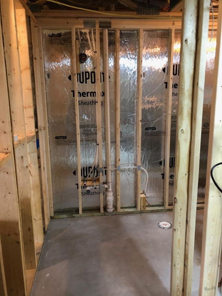

              Finally the most exciting part for me since for the first time in my life, I won't need to go to another building to use the restroom. The bathroom plumbing
              Bathroom plumbing rough in
