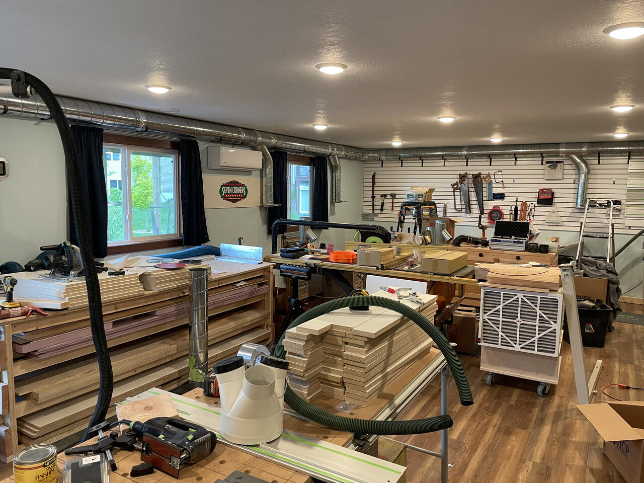

    It's been busy at work and lots of weekends so not much progress lately. I got the dust collection ducting installed today and yesterday. 8" main trunk with 4 6" drops. Still a way to go until it is usable. I'm hoping to get the cabinets under the slatwall which will be the miter station installed tomorrow.
    The spiral pipe I bought at Menards is cone shaped. 7 15/16" at one end and nearly 8.5" at the other. I had to recrimp a number of my fittings to get them to go into the narrow end.
