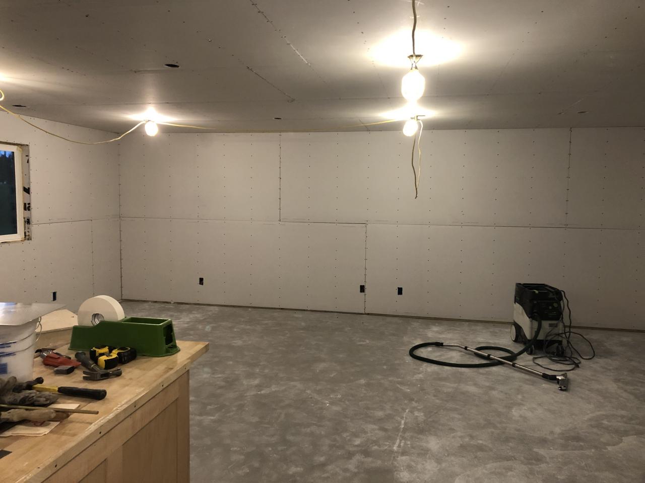

                Drywall was finished yesterday and the inspection passed today including the mildly insane requirement that screws be placed every 6". There has to be a story as to why the city requires that many screws. I finished hanging the drywall last week with screws at each edge and in the center of every stud and then spent the entire weekend filling in the field. Mudding and taping start tomorrow and no more inspections required until the final.
                I also suffered a complete math failure and ended up with 19 extra 12' x 1/2" sheets. I realized when I was done that I calculated the walls for 8'sheets and ordered 12' sheets. Now I need to get the excess back to Menards.
                New shop drywall complete and ready for taping.

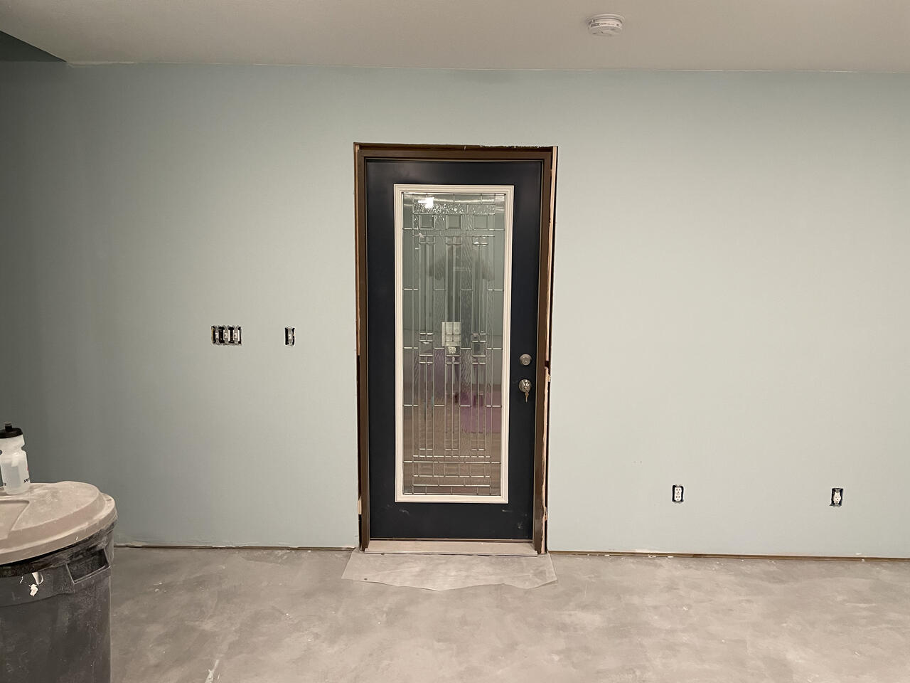

                    After almost three weeks finally ready for primer and paint.

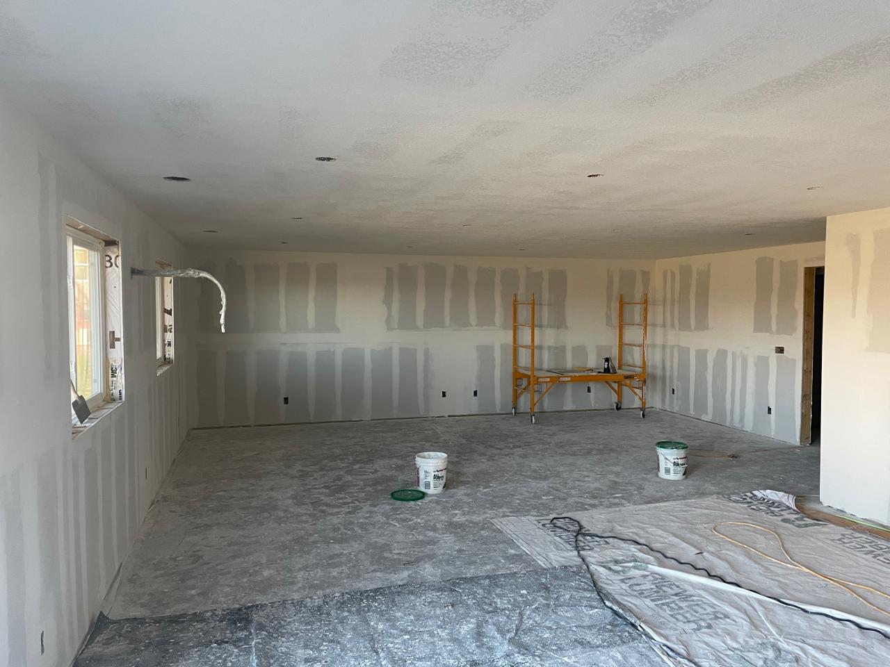

                        Is that an optical illusion or has the floor sloped that much?
                          • 3126
                          #42
                          It is an optical illusion due to my stellar photography skills. The floor is level +-1/8 inch.

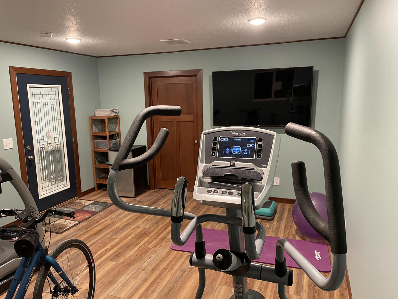

                            Well, a couple of months after the last update and everything going sideways for a bit, I'm finally back to working on the shop. Finished priming, correcting flaws in the drywall and painting in early December. Then my wife ordered a Tonal fitness system and said it was going to be installed the first week of February so the fitness room had to be ready so ...
                            Stopped work on the shop and started working on the fitness room and the closet, bath, and hall since everything in the basement was now in the shop space anyway. Then Menard's sent me an email that they were having their last 11% rebate of the year, so I ordered doors, flooring, bathroom fixtures and piled all that in the shop.
                            Here's the fitness room finished except for trim on the window. I need a woodshop to build that.

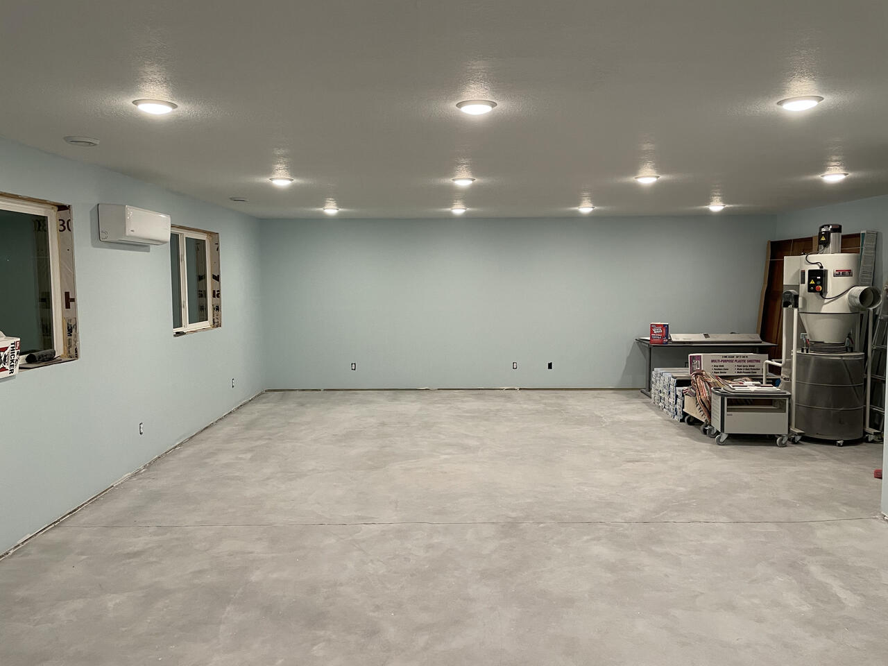

                            Finally, here's the shop space with actual lighting, mini split heat and a/c and ready for flooring. I decided to go with LVP, the same that's in the fitness room. My wife thought I was nuts when I dumped sawdust all over the dining room floor to see how slippery it was going to be. I just need to fill the expansion gap with a flexible filler before I start the the flooring and I'm ready to go.

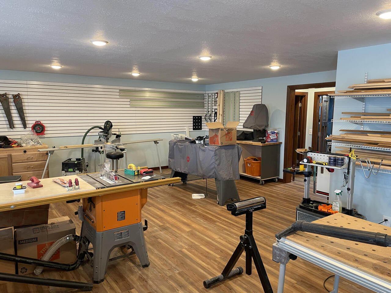

                                Finally unpacking the shop, but a long way to go. Got the slat wall installed and sheet goods rack built this weekend. I lowered the top of the sheet goods rack a bit so it will double as a work surface.
ID:	843341 Click image for larger version
                                Next projects in the shop are going to be cabinets under the slat wall for a miter station with 3.5 meter fences on either side and then getting the dust collection piping installed.
