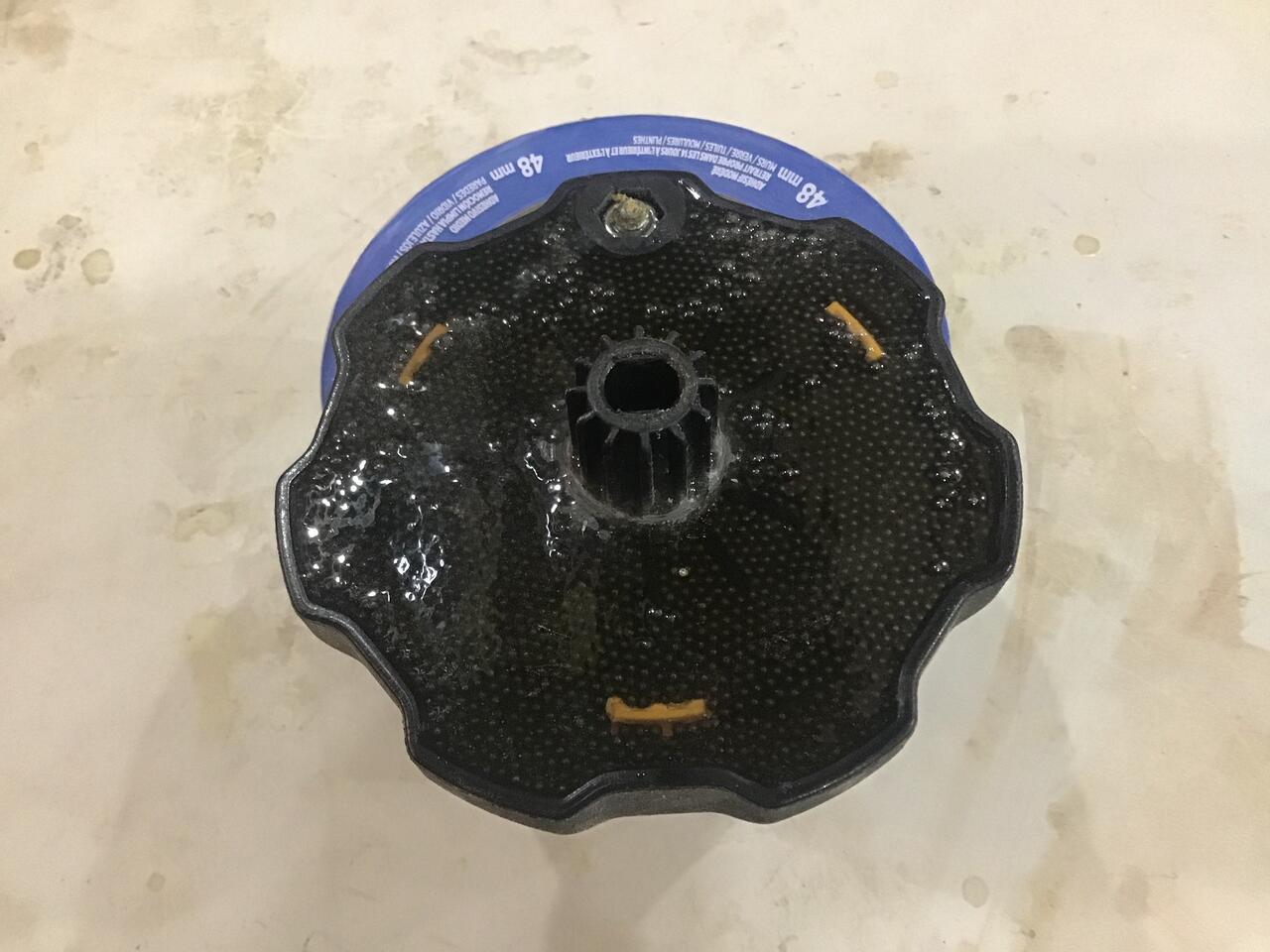

    Some plastic knobs from my bandsaw and CMS filled with the matrix.

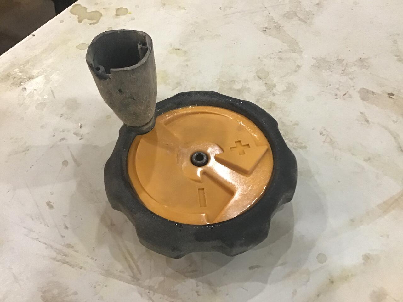

    A two part table saw tilt/elevation crank strengthened with the mix.

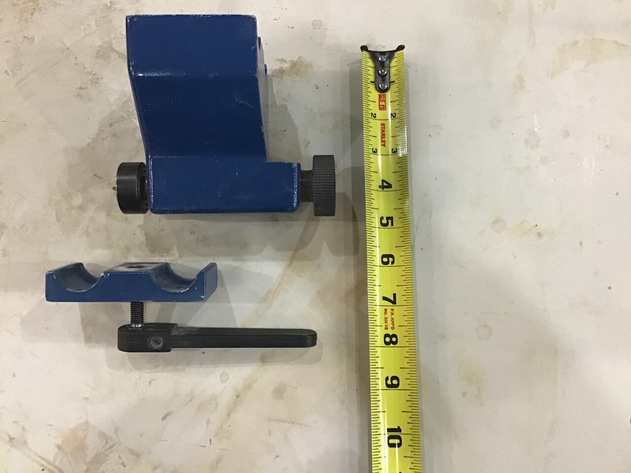

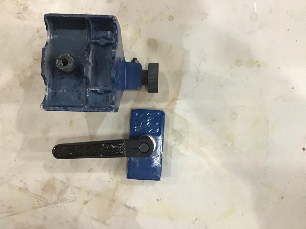

    A 12 oz. die cast aluminum lathe tailstock filled with 5.5 pounds of the matrix. Also the bottom clamp and plastic locking lever which received the infill.

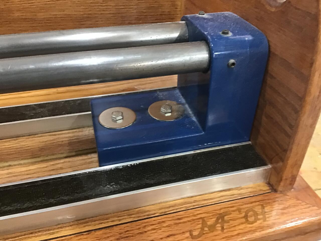

    The lower bed rails of a shop built lathe filled with the matrix.
