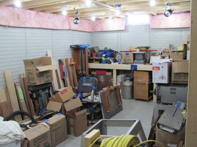

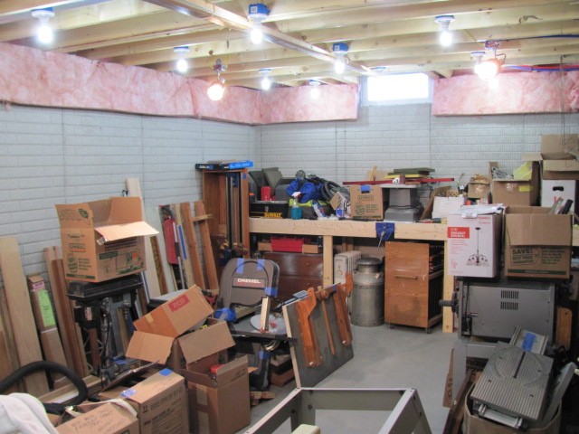

                My 12'x22' basement shop is lit with 17 daylight 780 lumen LED screw in lamps. They are arrayed in 4' spacings such that they are 4' apart in three rows the length of the room. The center row is staggered from the outer rows. With this arrangement, there are very little shadows and they are faint at best. Since the ceiling is so low (8'), I can get away with this level of lighting. The entire array cost me less than $78 for the boxes, bases, and lamps. I also have four 300 watt incandescent floods in movable mounts for color balancing finishes. SWMBO says it's brighter than the Vegas strip in there, but I'm getting older and the high brightness helps with degeneration.
                Click image for larger version  Name:	NewShopLEDs.JPG Views:	0 Size:	87.0 KB ID:	838730
                Click image for larger version  Name:	NewShopFloodsLEDs.JPG Views:	0 Size:	88.8 KB ID:	838731

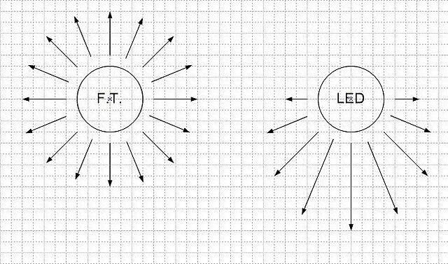

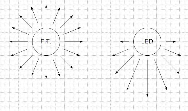

                              Dave, T12s need reflectors because the light comes out of the bulbs in all directions including straight up; all the light that goes upwards is not 100% reflected so some is lost.
                              OTOH, the 4 ft LEDs vary in construction but most have all the light emitter chips all mounted facing downwards through a white diffuser so very little light goes up. I would say most is radiated in a pattern down and to the sides. So, they don't really need reflectors; they won't do much if you keep your T12 fixtures and populate with LEDs and new wiring but I guess they look pretty if you retain yours.
                              LED tubes are not the same radiation pattern as T12 fluorescent tubes.
                              Viewed from the end Fluorescent tubes radiate equally in all directions. LED tubes have all the chips aimed downwards and radiate in beam pattern. Lumens is a measure of total light output. For F.T. vs LED with the same lumens the LED will radiate stronger straight down; the F.T. relies on reflectors to redirect the light downwards where its more useful. Frosted Diffusers serve to soften the shadows as the LEDs would be point sources; it also helps helps radiate some more to the sides.
