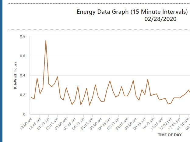

      Just was curious as to how much the workshop costs to operate going full blast.
      As an experiment (and because I have 15- minute online kWh usage readings from the light company)
      Late one night I turned on the shop lights and all the lights, the radio, the air compressor (cycling ), the overhead lights, the task lights on the machines, the air cleaner, the Dust collector at about 1:13 AM and ran it until 1:31 AM
      Click image for larger version Name:	power use.jpg Views:	0 Size:	45.5 KB ID:	838824
      Click image for larger version Name:	power use chart.jpg Views:	0 Size:	44.6 KB ID:	838825
      The 15 minute kWh readings from before and after were.210, .269, .757, .310, .282; the .757 value covering the time from 1:15 to 1:30.
      So my baseline of running stuff in the house was approx .267 - some indoor and outdoor lights, the central heater circulation fan coming on now and then, fridge cycling on and off, two or three computers, TV (wife watching) plus clocks and various small electronics. So my quarter hour shop consumption added about .490 kWh
      That means the power drawn was 1.957 kW and in an hour I would have used basically 2 kWh. So at my present rate a shop hour would cost me around 20 cents of electricity. That doesn't include running any power tools But generally that would be more intermittent than continuous so it would not add much.
      In retrospect the DC was probably about 1500 W (13 A) and the lights 360 W (9 x 40W) and the Air cleaner 100 W. Makes sense.

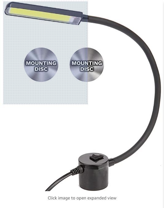

            I have 5 four-ft. LED dual tube fixtures and 2 four-ft T8 dual Fluorescent fixtures. Its pretty well lit in my garage shop, but I have found that having LED task lights on goosenecks is very helpful for close work.
            I have three such task lights, one each on the router table, the bandsaw and the drill press, they are very bright and help a lot. Magnetic bases and being light make them really easy to position. Longer goosenecks are available.

            price has gone up, there are a bunch like it. I replaced older, less bright task lights about 1-1/2 years ago.
            Oh, here, I got this one, too, quite a bit cheaper.at $17.
            https://www.amazon.com/gp/product/B0...e?ie=UTF8&th=1
