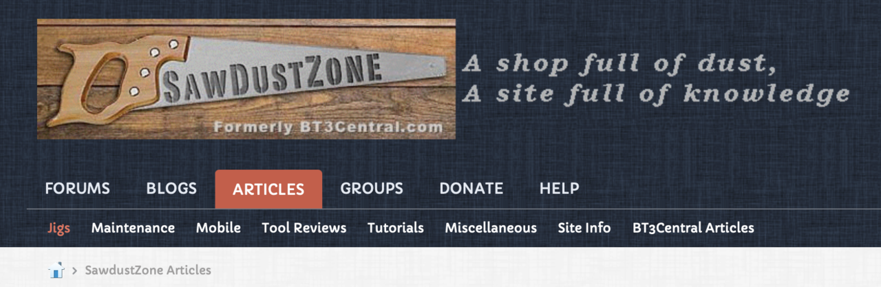

    • 3122

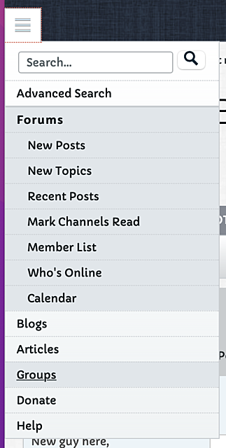

    Cl​ick on Articles in the menubar, then Jigs and you should find a bunch. I don't recall a picture frame jig, but then again there are many things I no longer recall.
Name:	Screen Shot 2022-03-06 at 8.37.33 AM.png

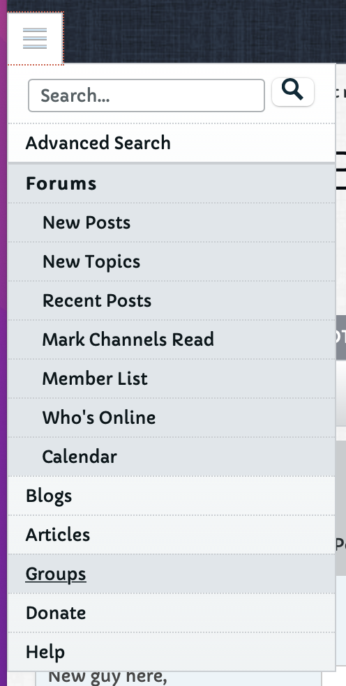

    If you are on a mobile device, click on the menu block in the upper left corner of the screen to get to the articles.

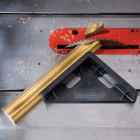

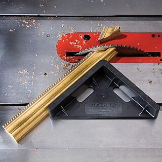

          I'm actually in the midst of making a 45 degree miter jig somewhat along the principles of this (but for the BT3 Sliding miter table (SMT) and not using the miter slot) - you make a very accurate 90 degree and use it to cut complimentary angles that don't have to be perfectly 45 but always match to make a perfect 90 degree corner. Eliminates that 0.12 degree error that adds up to a whole degree going around the whole frame (8 times).
          Click image for larger version  Name:	31593-01-1000.jpg Views:	0 Size:	35.7 KB ID:	848894
          I usually post pictures of my works and jigs in process.

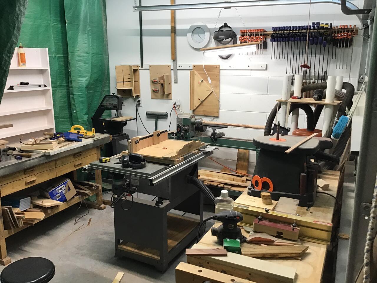

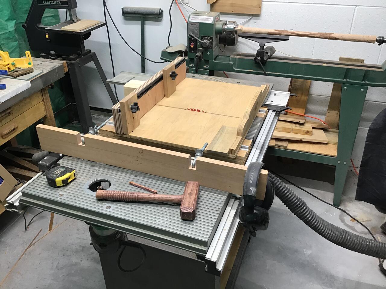

        • Dedpedal
          • Feb 2020
          • 256
          • Palm Coast Florida

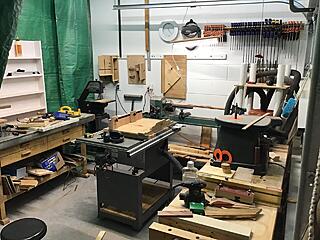

          I make jigs based on my home built miter slots. Once they are square and parallel to the blade it’s just like making jigs and sleds for a traditional table saw. Click image for larger version

            Nice job on the miter slots. And that is one seriously beautiful lathe, but I might be biased :-)
