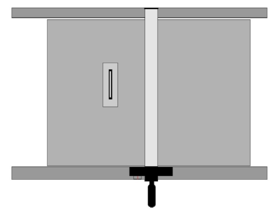

    Here's a simplified view of the BT3 saw from above, showing the throat plate surrounding the blade, the fence assembly and the fence rails.
    Whilst most will recognize the importance of having the fence parallel to the blade, the reason for this might not be obvious and bears further (later) explanation.

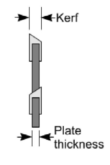

    The “kerf” of a blade is the amount of material it removes from the stock, or, in other words, the width of the cutting teeth (and therefore, the cut). The saw plate thickness is less than that of the teeth, as can be seen in this diagram, which provides relief between the stock and the blade. There are other parts of the blade that assist in its efficiency, but we are not concerned with them in this explanation.
    Click image for larger version  Name:	rg-kickback 0002.jpg Views:	1 Size:	14.0 KB ID:	834537
    The blade profile pictured here is an Alternate Top Bevel (or ATB), so called because each alternate cutting tip’s bevel is on the opposite side, as shown. The bevel angle is usually 15 degrees and although two teeth will span the width of the kerf, this configuration will leave a slight “V” in non-through cuts.

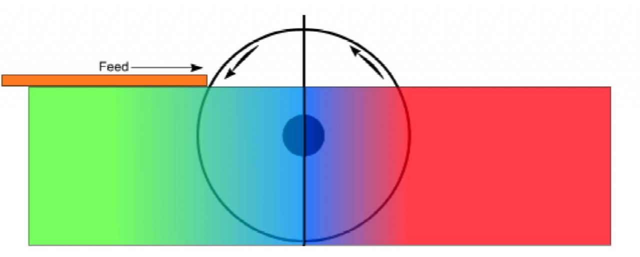

    No matter what profile the blade teeth have, the kerf will be wider than the saw plate. This allows the plate to run free within the kerf already cut into the stock as it is passed through the blade. If the saw plate were as wide as the cutting teeth, then the whole face of the saw plate would be in friction contact with the sides of the cut. This would generate a great deal of heat, which in the early part of the cut would be inconvenient, possibly marking the stock.
    Click image for larger version  Name:	rg-kickback 0006.jpg Views:	1 Size:	29.0 KB ID:	834540
    However, once the stock has passed the “center” of the blade (the vertical black line in the above diagram) and therefore the center of rotation, the “back” of the blade would then lift the stock upwards as soon as it overcame the weight of stock and/or any downward force applied to it. Once the stock weight (and/or force applied) has been overcome, the friction of the blade upon the stock will act just like a clutch in stick-shift, gaining a grip on the side of the cut by friction and propelling the wood in the direction of travel of the blade. This, unfortunately, is upwards and towards the front of the blade and - therefore - towards YOU!
    The circumference (perimeter) of a 10-inch saw blade is 31.4 inches. If the saw blade travels at 4,800 revolutions per minute (rpm), then the teeth are travelling at 150,720 inches per minute. To put that another way, that’s 9,043,200 inches per hour, or 142.72 mph! Even allowing for the fact that some of the blade speed will be lost through load, that’s still 120mph if 15% of the speed is lost – usually, an over-estimate. It is not surprising to realise, then, that any piece of stock propelled by a blade moving at that speed has the potential and inertia to travel a great distance and become a very dangerous projectile.
    Thankfully, saw plates are not as wide as their cutting teeth and - in a perfect setup - will run freely within the width of the kerf of the cut and remain cool. The trouble is that “perfect setups” don’t happen automatically, or naturally. Some saws may be perfectly set up right out of the box and may also remain so for their entire working life. I haven’t found one or heard of one yet that has done both!

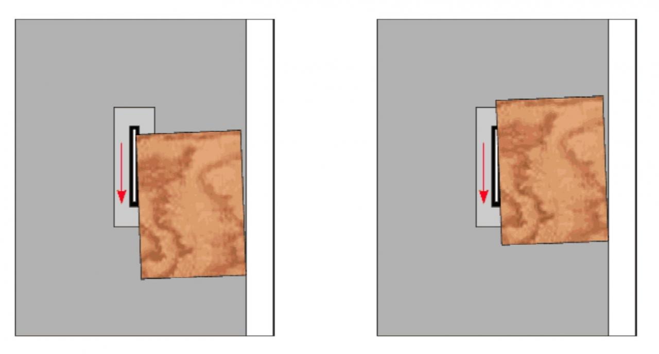

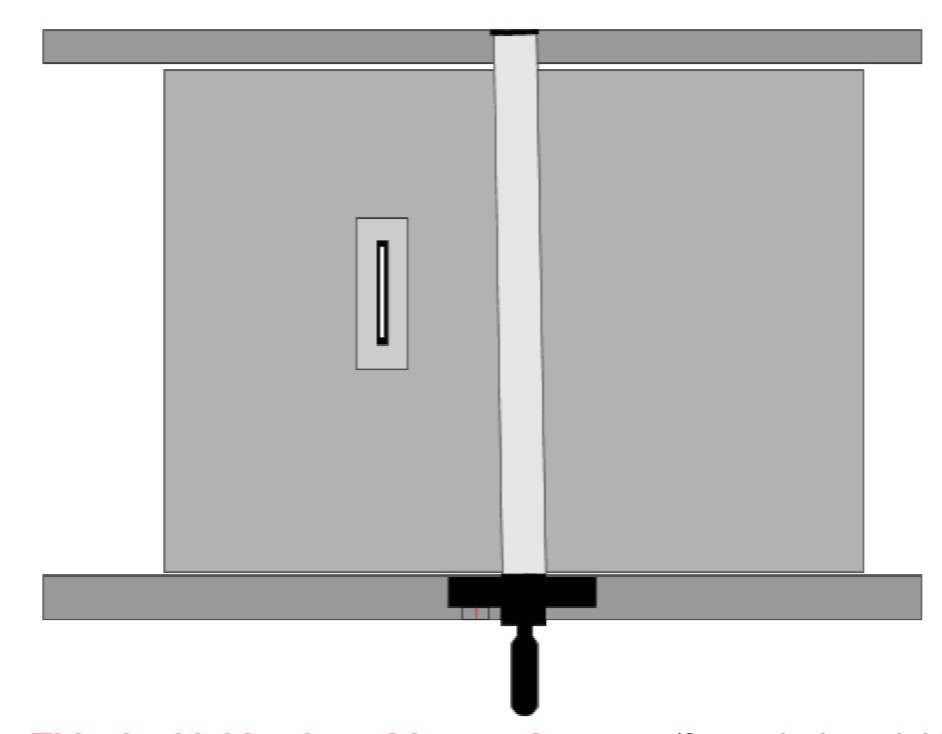

    Look at this diagram:
    Click image for larger version  Name:	rg-kickback 0013.jpg Views:	1 Size:	31.4 KB ID:	834550
    The fence is not parallel to the blade – it is skewed towards it at a slight angle.As the stock is fed into such a setup, it will become pinched between the fence and the blade and the further it is pushed through, the worse the pinching effect will be. A square piece of stock will not pass through a smaller opening!
    This is kickback waiting to happen (fence-induced kickback) - the stock cannot pass cleanly through the blade and will be forced sideways into the back of the blade by the fence. This is why it is ESSENTIAL to make sure that your fence is parallel to the blade.
    Some woodworkers adjust their fence so that it “leans away” from the blade, even by just half the thickness of a business card. This removes the potential for such fence-induced kickback, whilst not adversely affecting the workpiece.

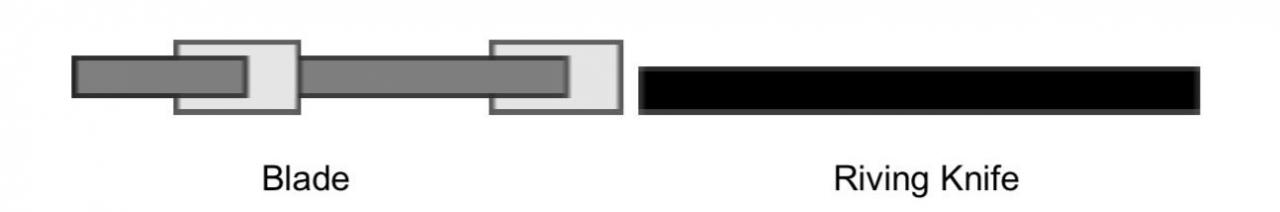

    Riving Knives
    The riving knife is a device that will greatly reduce the possibility of kickback, provided that it is properly adjusted.
    Click image for larger version  Name:	rg-kickback 0007.jpg Views:	1 Size:	16.0 KB ID:	834544
    If your riving knife is the same thickness as the blade kerf, adjust it to be in line with the blade. If your riving knife is thinner than the kerf, adjust it so that it aligns with the fence side of the kerf, as shown in the above diagram. The purpose of the riving knife is to prevent sideways pressure on the blade from stock which is passing through. Once the leading edge of the workpiece reaches the knife, it also serves to guide the cut and prevents the up- running teeth at the back of the blade from unnecessarily scoring the kerf.

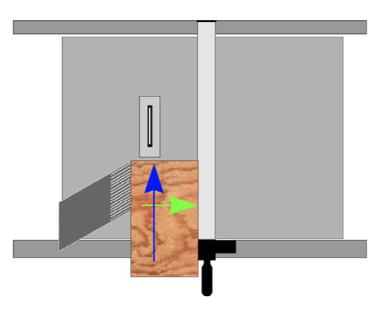

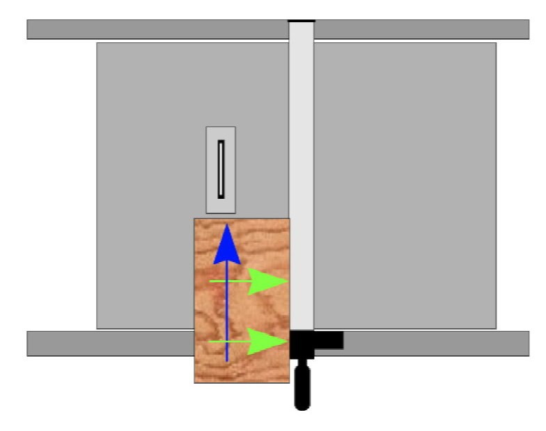

    When feeding stock, ensure that it is held firmly against the fence by pressure in the direction of the fence (the green arrows). Once a good contact has been established with the fence, feeding can begin (blue arrow).
    Click image for larger version  Name:	rg-kickback 0009.jpg Views:	1 Size:	33.4 KB ID:	834545
    A featherboard can greatly assist in keeping stock tight against the fence, but can only be used horizontally in front of the blade.Featherboards can also be used by clamping them vertically to the fence, where they will provide a downward force on the stock.
    If you allow the stock to twist or skew, as soon as it reaches the back edge of the blade, the up-running teeth will launch it at you, in the direction of the blade rotation (red arrow).

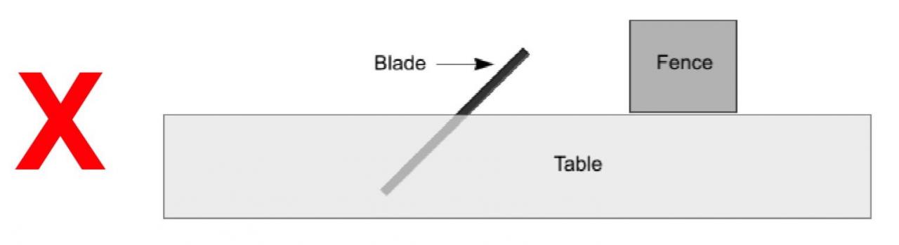

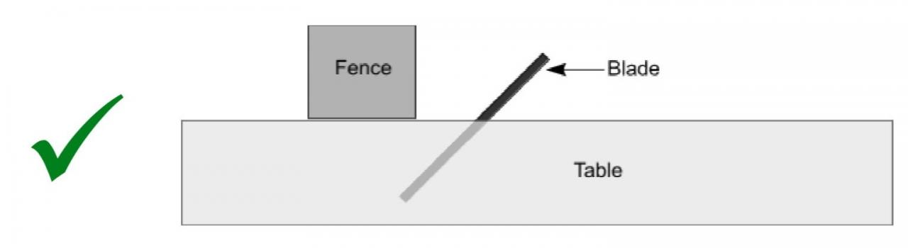

    Never tilt the blade so that the workpiece is trapped in the angle between the blade and the fence. This is a condition that has a very high potential of causing kickback:
    Click image for larger version  Name:	rg-kickback 0011.jpg Views:	1 Size:	19.7 KB ID:	834548
    Move the fence to the left-hand side of the blade, like this:
    Click image for larger version  Name:	rg-kickback 0012.jpg Views:	1 Size:	17.5 KB ID:	834546
