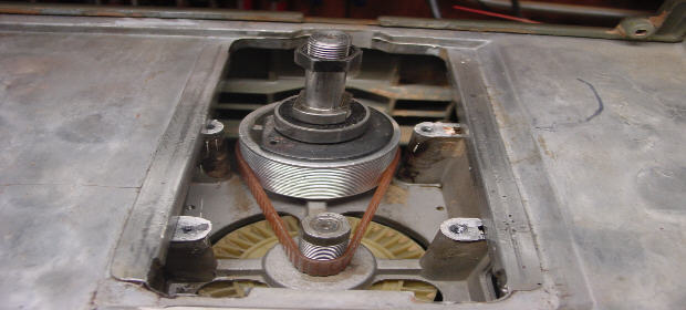

    Having to R&R the belts two and a half times I think I have found an easy way.
    First time I did it by Ed’s way, I made the conduit tool and it work pretty good the first time. I still thought there might be an easier way. I remember reading a post by slick_rick where his daughter thought of using a wrench to rotate the arbor. I tried it and it worked. But not having a ten year old at hand, 3AM, things were a little tight with both hands in there. So here is my final solution.

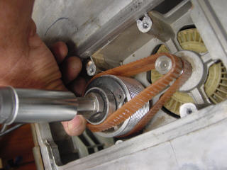

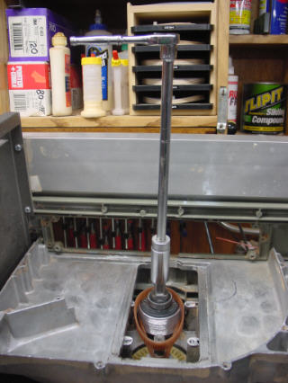

    First put the arbor nut on the arbor.
    Use a 19MM deep socket with a long extension and rachet. This gets your one hand out of the way

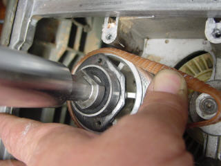

    Now rotate the arbor counter clockwise and deflect the top edge of the belt downwards onto the arbor to catch the grooves.

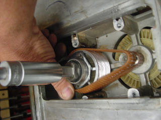

    Continue to work the belt around and checking the belt at the motor shaft.
    Once the belt is in place work in down by deflecting the top edge of the belt.
    You will probably think I am a glutton for punishment because I had to R&R the side panel, dust cover, guide holder and belt to do this post. Total time was 20 minutes, including taking the pictures with one hand.
