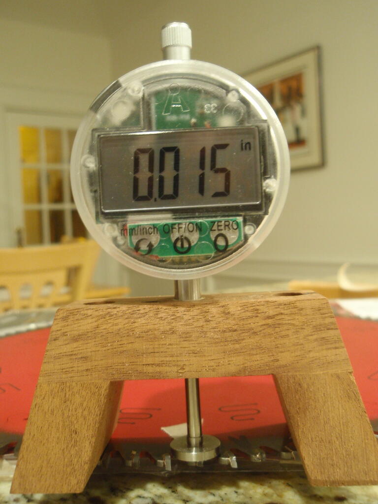

    I think I found the bent tooth. 0.015 above the others. I found another tooth .003" high.
    Most of the teeth were within +/-0.0015 above the others surrounding it.
    Bent tooth.
    Click image for larger version  Name:	PA241374.jpg Views:	0 Size:	82.7 KB ID:	856584
    Typical good tooth
    Click image for larger version  Name:	PA241373.jpg Views:	0 Size:	86.1 KB ID:	856585
    would it be hard to break that tooth off completely at the brazing?
    Can I use diamond files to take a few thou off a tungsten carbide tooth?
    I've never considered grinding on TC before,
    I think that's the only one on this side. I found it by running my finger lightly on the carbide edges and finding one that seemed higher than the others, and checking with the dial gauge. I don't want to have to measure all one hundred tips tho.

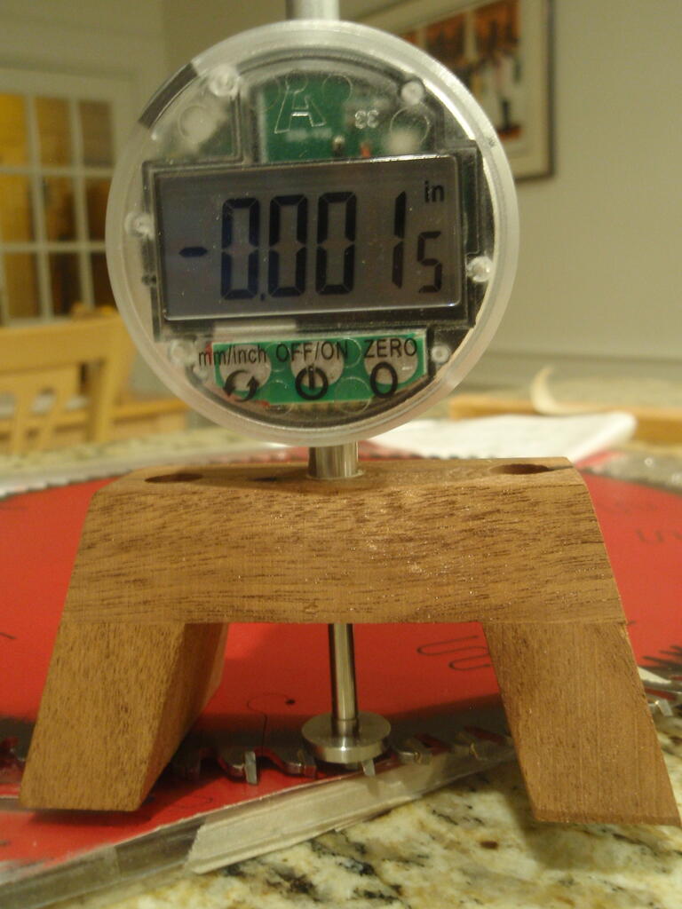

      I spent 35 minutes cajoling two teeth, one .003" out and the other .015" out of alignment
      Before:​
      Click image for larger version  Name:	image.png Views:	0 Size:	855.2 KB ID:	856685
      So it wouldn't move around, I Clamped it to the bench supported with a can up to the edge where the tooth met the plate so it would bend there and I bent them with long nose pliers just to the side of the carbide tip (to avoid cracking it) and with a skinny block of wood and a mallet positioned over the one tooth I was working on.
      Click image for larger version  Name:	image.png Views:	0 Size:	1.14 MB ID:	856679
      Click image for larger version  Name:	image.png Views:	0 Size:	1.44 MB ID:	856680
      Click image for larger version  Name:	image.png Views:	0 Size:	1.41 MB ID:	856681
      Click image for larger version  Name:	image.png Views:	0 Size:	1.36 MB ID:	856683
      After:
      Click image for larger version  Name:	image.png Views:	0 Size:	870.6 KB ID:	856682
      Got them to 0.000 and -0.0005 so that's pretty good. All the other teeth I checked measured between +/-0.0015" (1.5 mils) on the good cutting side of the blade. Used "calibrated" efforts so it went a few mils at a time.

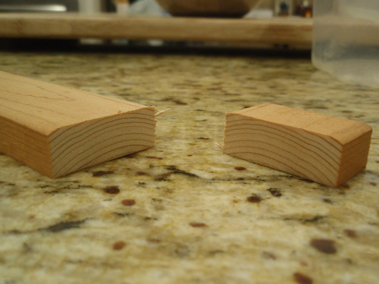

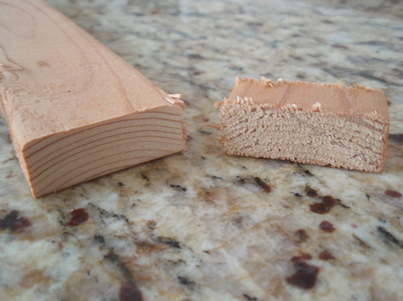

          Before:
          Click image for larger version  Name:	fetch?id=856579&d=1698184634.png Views:	0 Size:	802.9 KB ID:	856691
          After bending teeth straight:
          Click image for larger version  Name:	PA311372.jpg Views:	0 Size:	99.4 KB ID:	856692
          I think I fixed the cut smoothness. There is still a bit of tearout on the backside that my new blade does not do. In the end, this blade has one broken tooth ground off, has been sharpened, and the shop found and straightened or ground down one or more teeth bent to the left, and I straightened 2 teeth that were bent to the right.
          Click image for larger version  Name:	image.png Views:	0 Size:	172.0 KB ID:	856693
          I am not sure what you can do to make the rehabbed blade cut as well as the new regarding tearout... I went through three other quality brand blades before finding this Diablo that has minimal if any tearout on the backside when new.

                    So anyway after doing something bad to this blade I have a sharp blade, cuts almost like new but with a teensy bit of tearout at the back on my miter saw. I ended up spending nothing but a fair amount of time measuring, complaining then working on it my self over four weeks.
