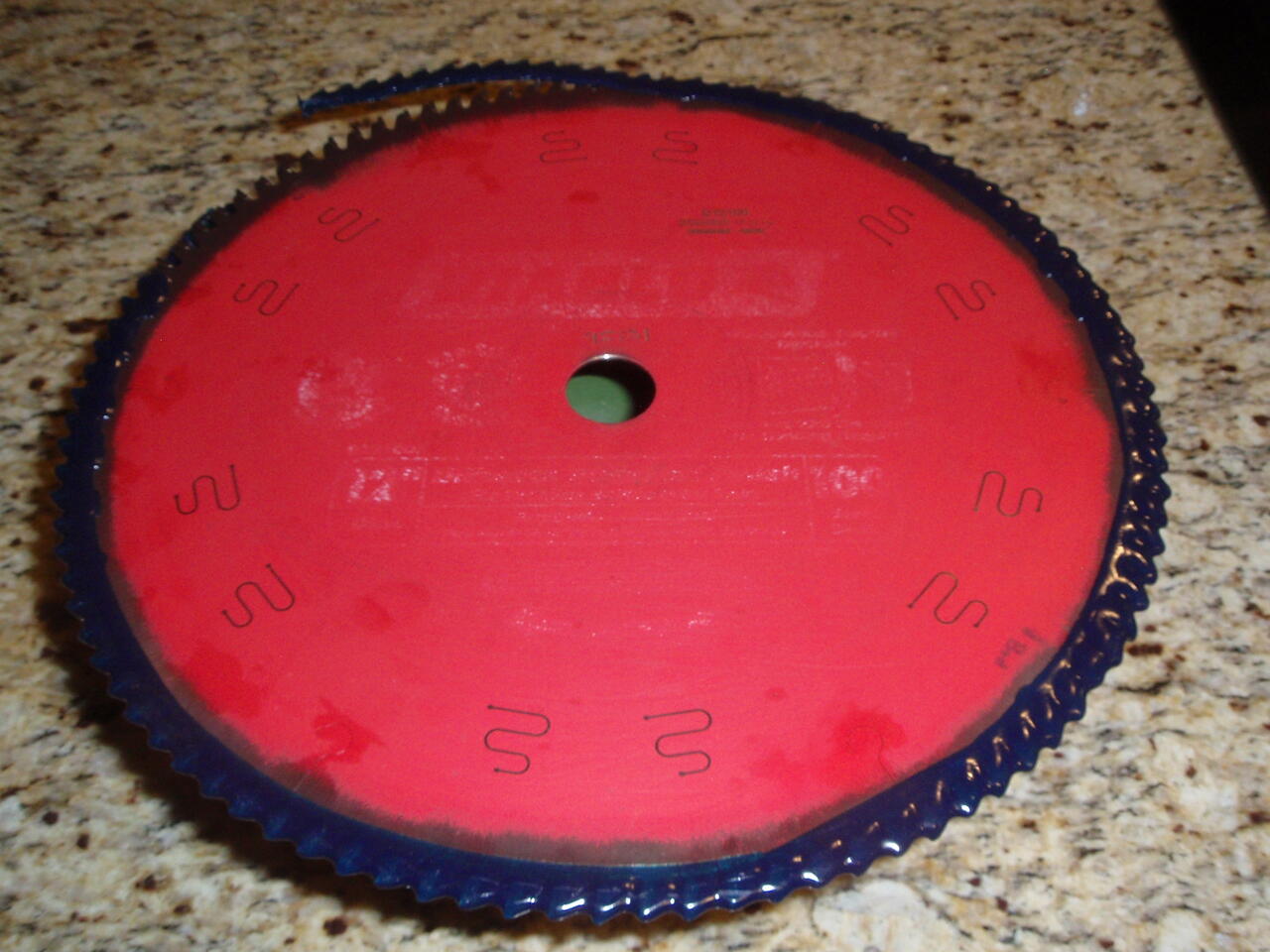

    Miter saw been splintering and making rough cuts whereas it used to give polished cross cuts with the Diablo D12100X 12" ATB miter saw blade.
    On inspection found a broken tooth​ The other teeth look and feel OK but this one is rough around the edges. Almost directly opposite the broken tooth (49, but not 50 teeth away) is a slightly bent tooth. My dial indicator says its .009" bent to the side.
    Click image for larger version  Name:	P9161335.jpg Views:	11 Size:	85.2 KB ID:	856187
    Have the tooth replaced? Resharpened? $29 for sharpening not sure how much for the tooth. Two years old

    Maybe I did this when cutting some Aluminum. Should have put on the cheapo blade that came with the saw. HiATB blades are fragile at the tips. Was too lazy for one cut. From now on just TCG non-ferrous metal cutting blades for aluminum!.

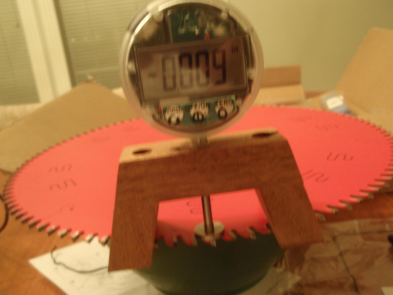

    So anyway after doing something bad to this blade I have a sharp blade, cuts almost like new but with a teensy bit of tearout at the back on my miter saw. I ended up spending nothing but a fair amount of time measuring, complaining then working on it my self over four weeks.

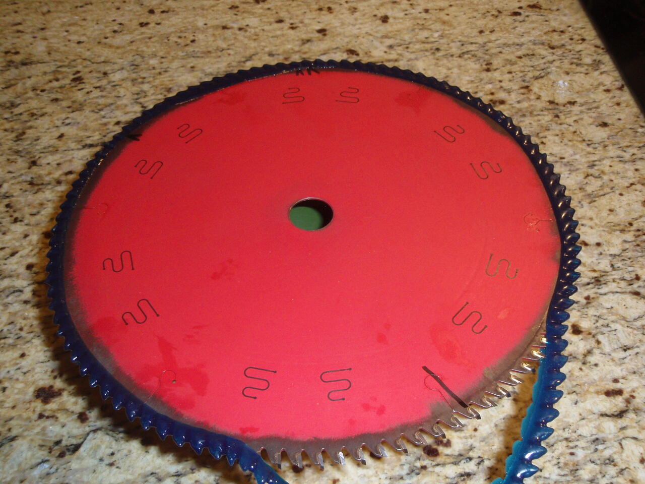

                Click image for larger version  Name:	image.png Views:	0 Size:	1.65 MB ID:	856405
                Had black rubber coating protecting all the teeth (I started to peel it off before the pic)

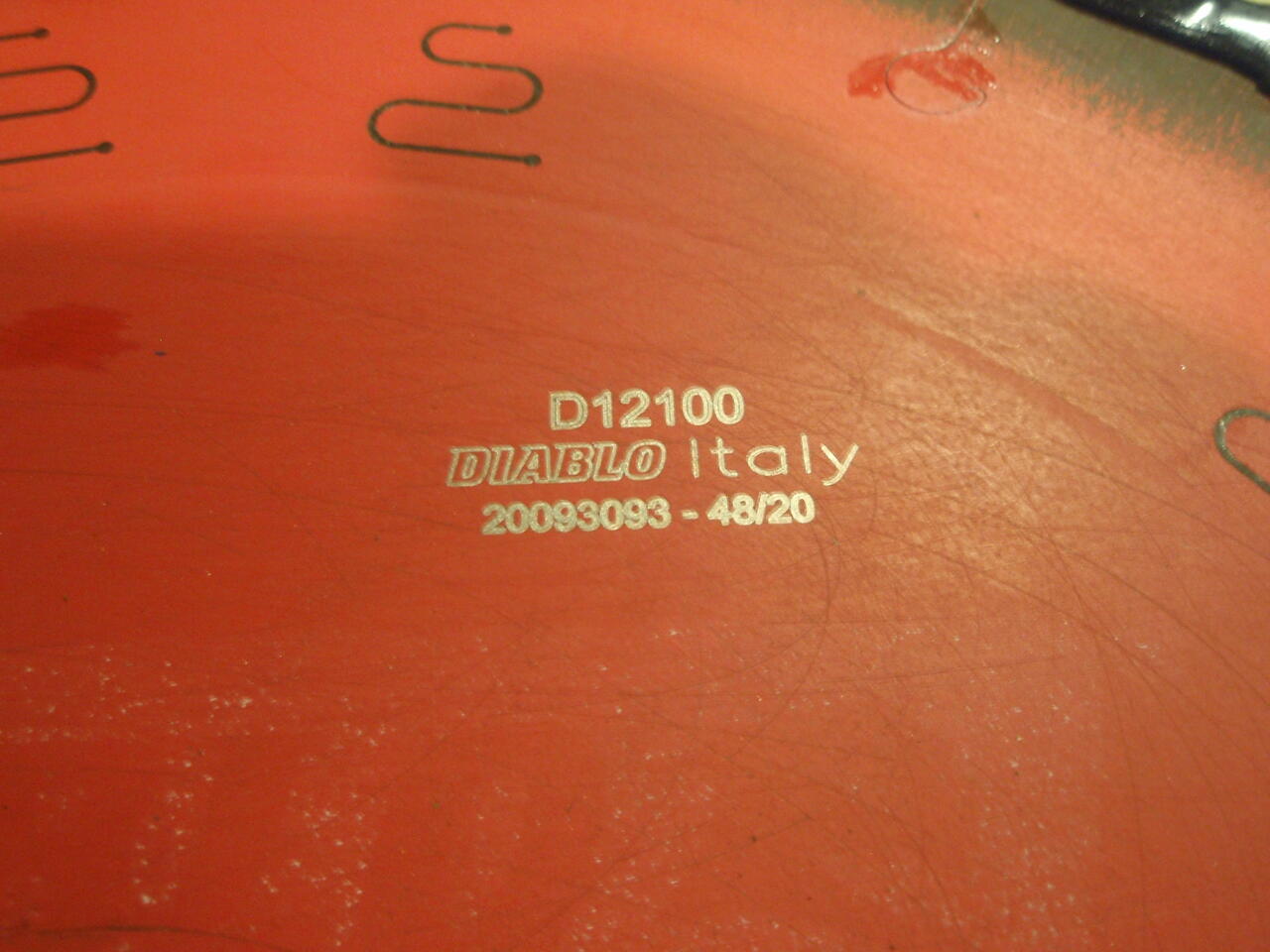

                Whatever they did they took of all the painted printing that said diablo
                Click image for larger version  Name:	PA041353.jpg Views:	0 Size:	135.5 KB ID:	856401
                As it comes from the factory paint job that was still there when I sent it in,

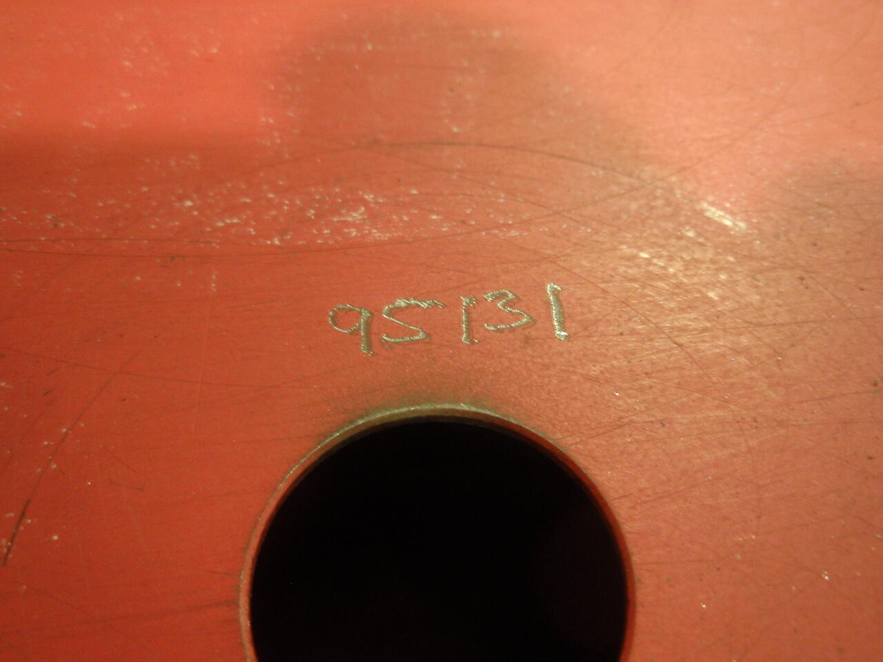

                They couldn't wash off the laser engraved serial no
                Click image for larger version  Name:	PA041354.jpg Views:	0 Size:	97.5 KB ID:	856398

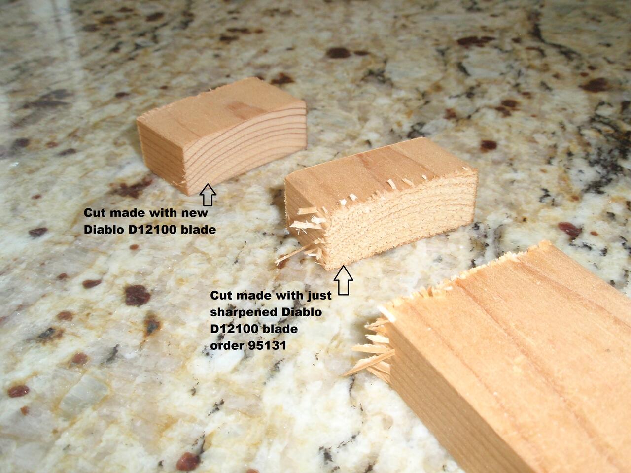

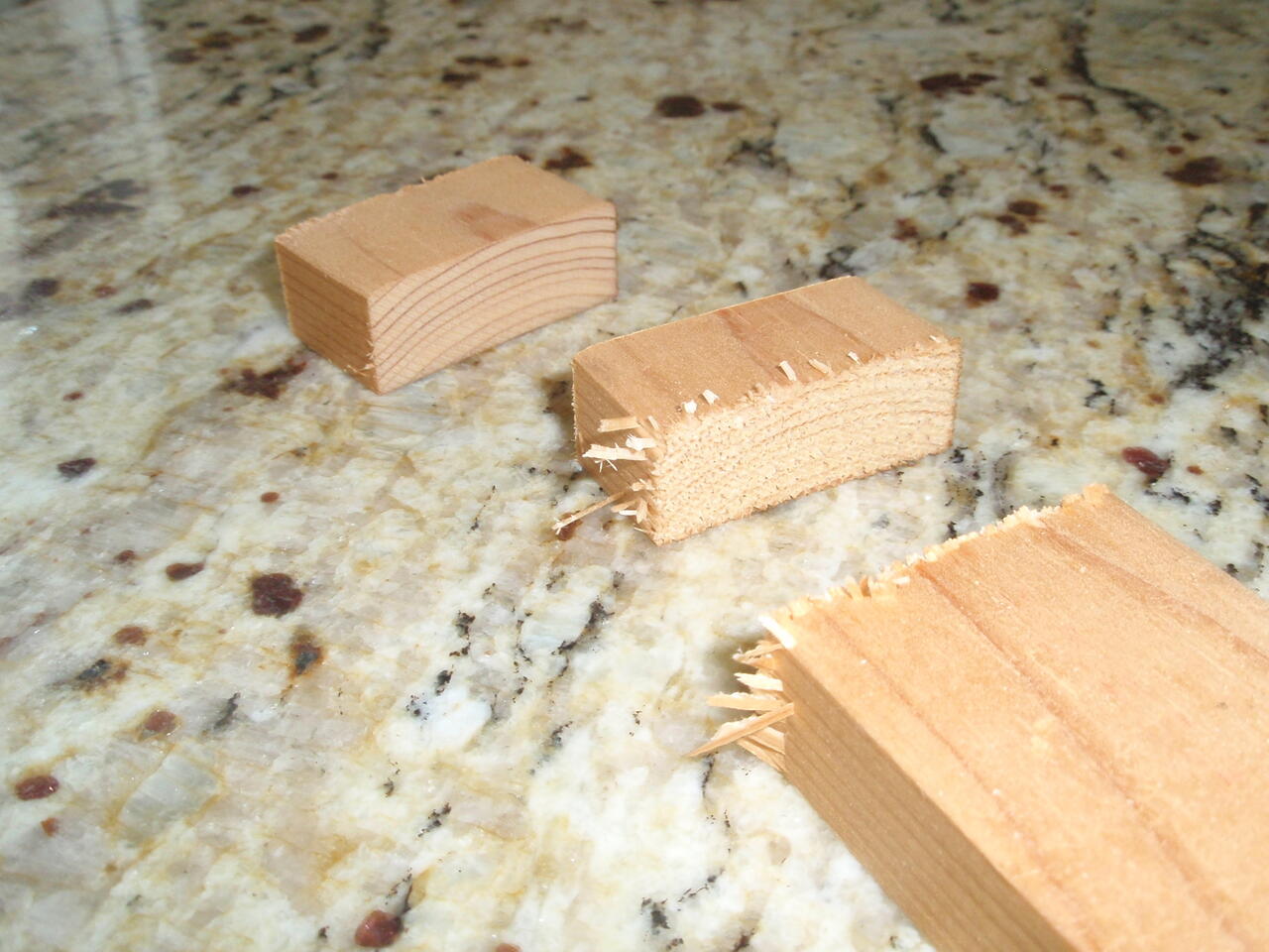

                  Bad news - sharpened blade cuts like crap
                  Click image for larger version  Name:	PA041366annotated.jpg Views:	0 Size:	146.3 KB ID:	856423
                  The cut at the top was made by my new diablo blade, same model as the sharpened blade. Polished, clean, little tear-out.
                  The lower cut was made by the just sharpened blade. Not a smooth cut and huge amounts of tear-out.
                  I think I need to take it back.

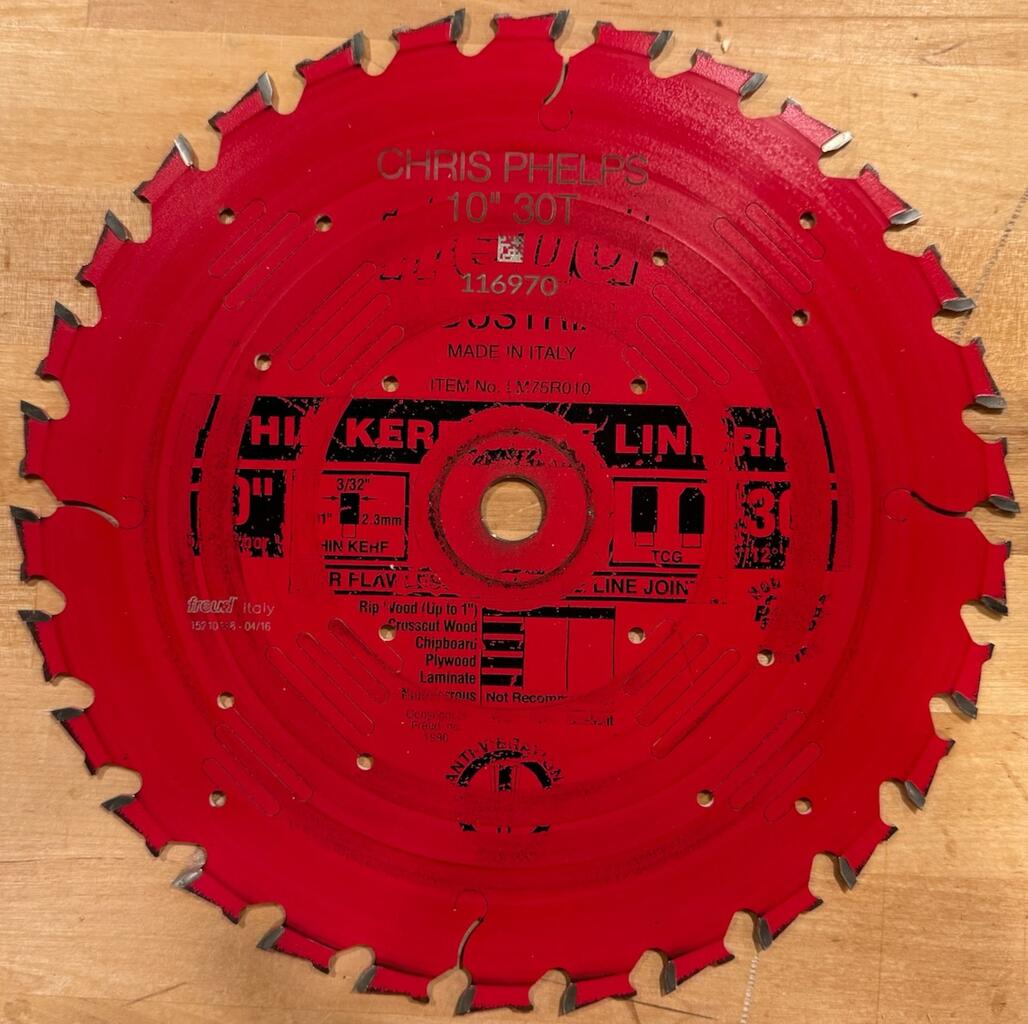

                    The heavily used blade below has been sharpened multiple times by Quinn without any of what I would classify as damage shown on your blade. Not that it matters, but they also engrave the blades, but in a much tidier manner.
                    Diablo 10" 30 tooth rip blade after multiple sharpenings.

                          I think the way I screwed up this blade was cutting an aluminum extrusion. It was a thin extrusion but the blade was HiATB which are very sharply beveled for prescoring the grain and have very fragile pointed teeth.
                          I should have used a TCG triple chip grind...or maybe a FTG.

                            Back from the sharpeners (again). Latest result they fixed the bad tooth on one side but not the other side... getting a really rough cut and splintering on the right side of the blade while the other left side is butter smooth.
                            Apparently they fixed the problem on one side, but not the other, even though I told them it cut roughly on both sides.
                            Talked to the guy, he's refunding my money. I guess neither of us want to deal with it. anymore.
                            Although he told me earlier they can fix minor problems, he now says that they are a sharpening shop, not a blade repair shop.
                            I think I see the bent tooth and he has a point, I damaged the blade (more than I thought) and they were willing to file down one bent tooth but not two.

                              That is plum disgusting! Beauty and the beast of cuts! That bad cut is absolutely awful!
                              LCHIEN commented
                              The left side cut is not perfect, either.... my new blade does not tear out the back of the cut like this one does.
                              Anyway, this blade is going in the scrap heap after I take a quick look and see if I can identify the offending tooth that is apparently out of line. One bent tooth a few thousands to one side makes a 100T blade into a 1T blade, effectively.
