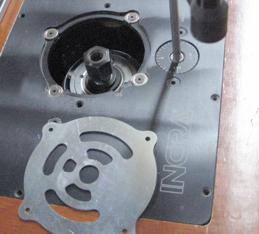

    I guess my chief comment then is building a table around this top may make it harder to upgrade in the future. Beware of getting stuck down this path because it was cheaper.
    That is why I suggested making the cabinet deeper front-to-back, adding filler strips around the existing Ryobi tabletop... and using screws to attach everything. That way the whole top can be replaced when compatibility with rectangular insert plates is desired. At least the Ryobi table is fairly wide; many "benchtop" router tables are significantly smaller. For comparison, Rocker's highest-grade cast iron router tabletop is 32 x 24 inches; tables designed to be added between a table saw fence support rails are often 27 x 16 inches. So that Ryobi table is as wide as many free-standing router table setups, and wider than many table saw mounted router tables. Even the expensive Saw Stop cast iron table for their bigger saws is narrower at 30 x 16 inches. Using a pair of filler strips plus the Ryobi table quickly brings it to 32 x 24 inches so a cabinet sized for that will be compatible with commercially available tabletops or a shop-built equivalent. Just leave sufficient width and height below the table for the router, a potential dust collection box, etc. for future upgradeability.
    As for dust collection... I agree: fence mounted shop-vac ports work well when profiling the edge of a workpiece - guided by the fence itself and/or a bearing on the bit. But when using the router table to make grooves in the face of a workpiece, the workpiece covers the cut so vacuuming through the fence is pointless. Making a dado/groove cut typically results in sawdust being blasted (really blasted!) off the left side of the table. This link Rockler's table dust chute has a picture that clearly shows the blasting. I don't know how effective this gizmo is; I'm linking to it for the picture of the blasted dust. I have the Incra lift in my router table... as I posted earlier, once you have "above the table" bit height and bit change capability you'll not willingly give it up. The Incra lift uses magnetically attached insert rings. An upgrade is the "Clean Sweep" rings for the Incra lift: these have banana shaped slots around the bit opening. So you have "below the table" dust collection capability while maintaining workpiece support close to the bit. They work rather well. When making dado/groove cuts I get little "blasted" material. I built a box underneath the table, similar to Rockler's Dust Right Router Table Dust Bucket, connected to a dust collector (not to a shop vac) which draws through the Clean Sweep rings.
    Click image for larger version  Name:	Incra_Lift_dust_collection_insert_4341.jpg Views:	0 Size:	291.5 KB ID:	854888
    My Incra lift and a sample Clean Sweep insert.
    mpc
