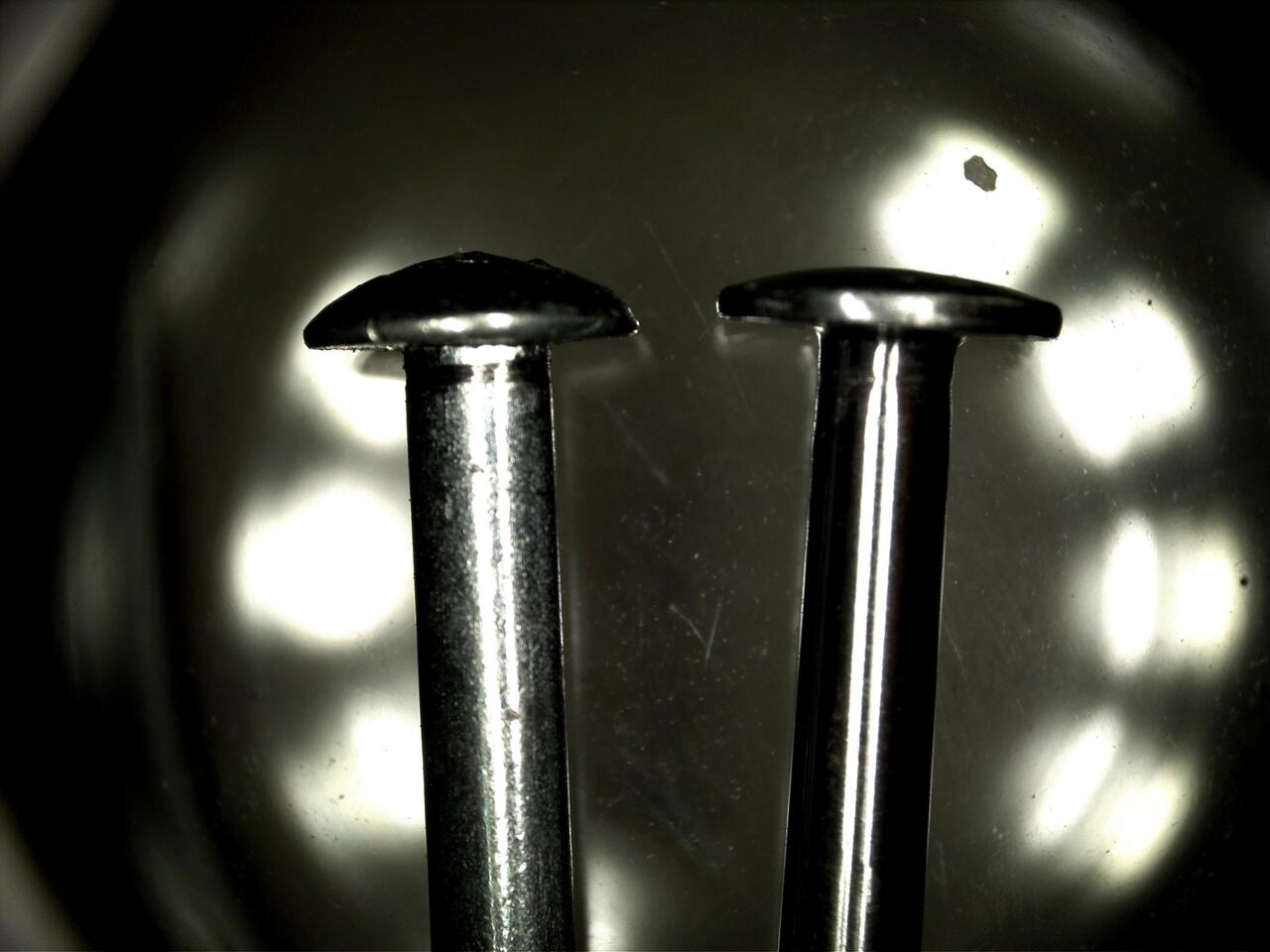

    Polishing wheel axles.
    unpolished typical axle from the kit on the left, after deburring and polishing through 5 grits on the right

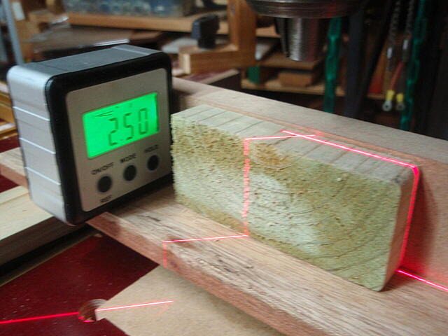

    Precision tilt jig for cambering PWD wheels 2.5°
    https://www.sawdustzone.org/forum/di...ision-tilt-jig
    Click image for larger version  Name:	fetch?id=847443.jpg Views:	0 Size:	113.9 KB ID:	847456

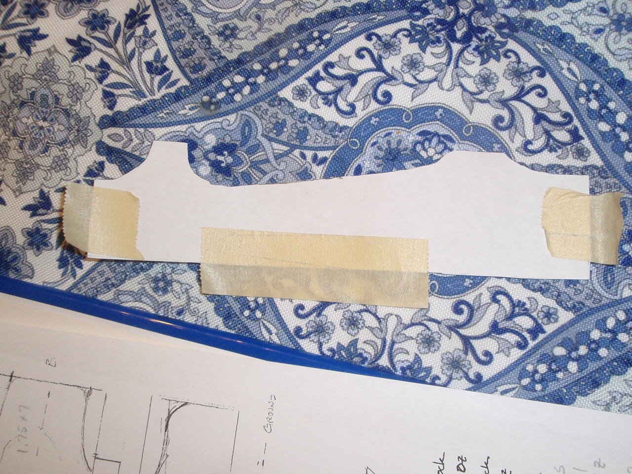

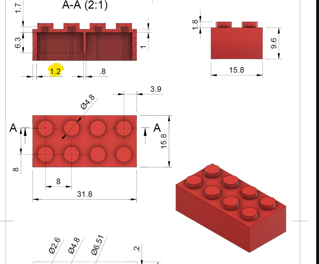

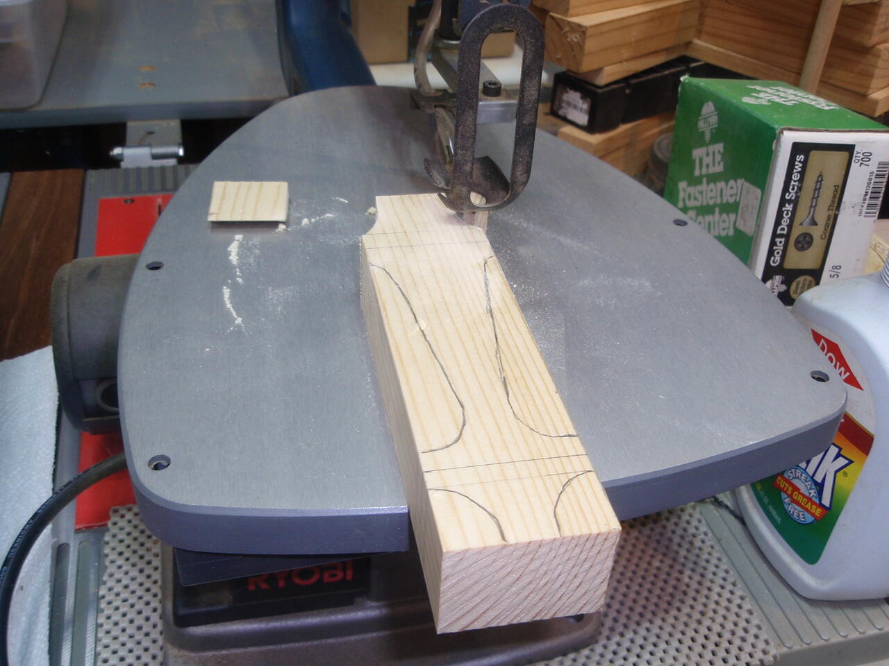

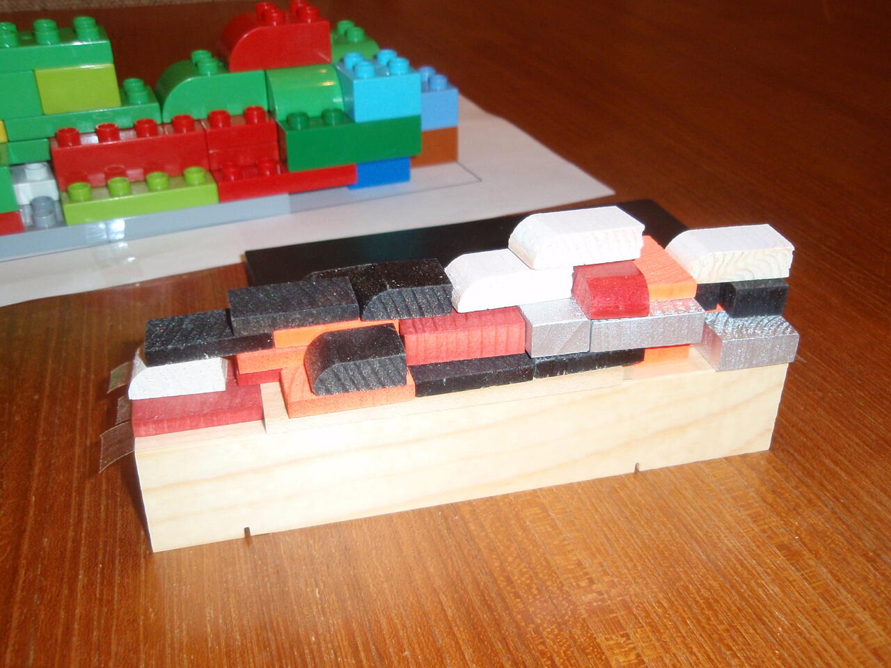

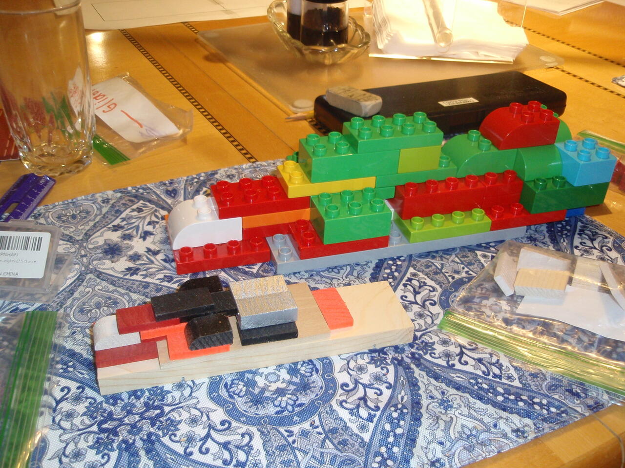

            Younger Grandson's car. Something he built of Lego he wanted to transfer the design to the car.
            Made a bunch of scaled precision LEGO shaped pieces
            Click image for larger version  Name:	zusvr.png Views:	0 Size:	208.3 KB ID:	847592
            Click image for larger version  Name:	P1150679.JPG Views:	0 Size:	240.2 KB ID:	847589
            Some on-the-fly changes were made.
            Click image for larger version  Name:	P1180694.JPG Views:	0 Size:	147.2 KB ID:	847590

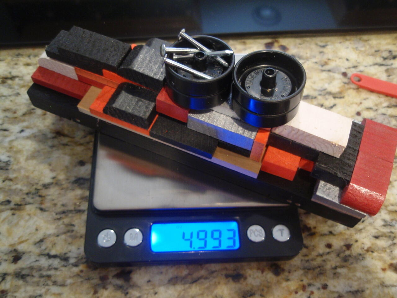

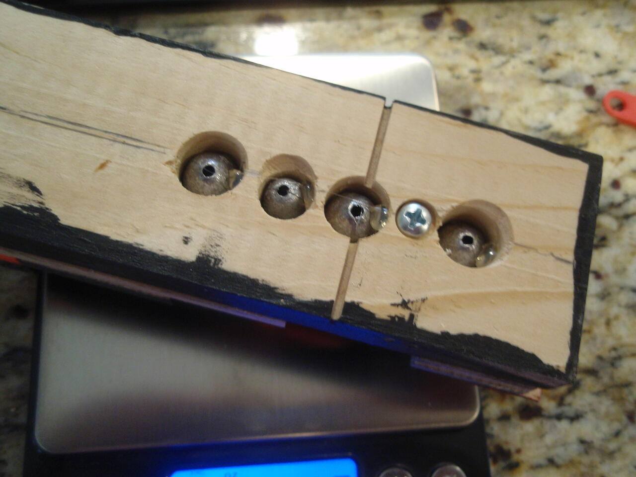

            Get up close to the allowed 5 Oz. three half oz fishing weights, a 1/4 oz weight and a #6 x 1/2" screw. (0.03 oz)
            Click image for larger version  Name:	P1190704.JPG Views:	0 Size:	102.6 KB ID:	847587
            Click image for larger version  Name:	P1190701.JPG Views:	0 Size:	134.3 KB ID:	847588

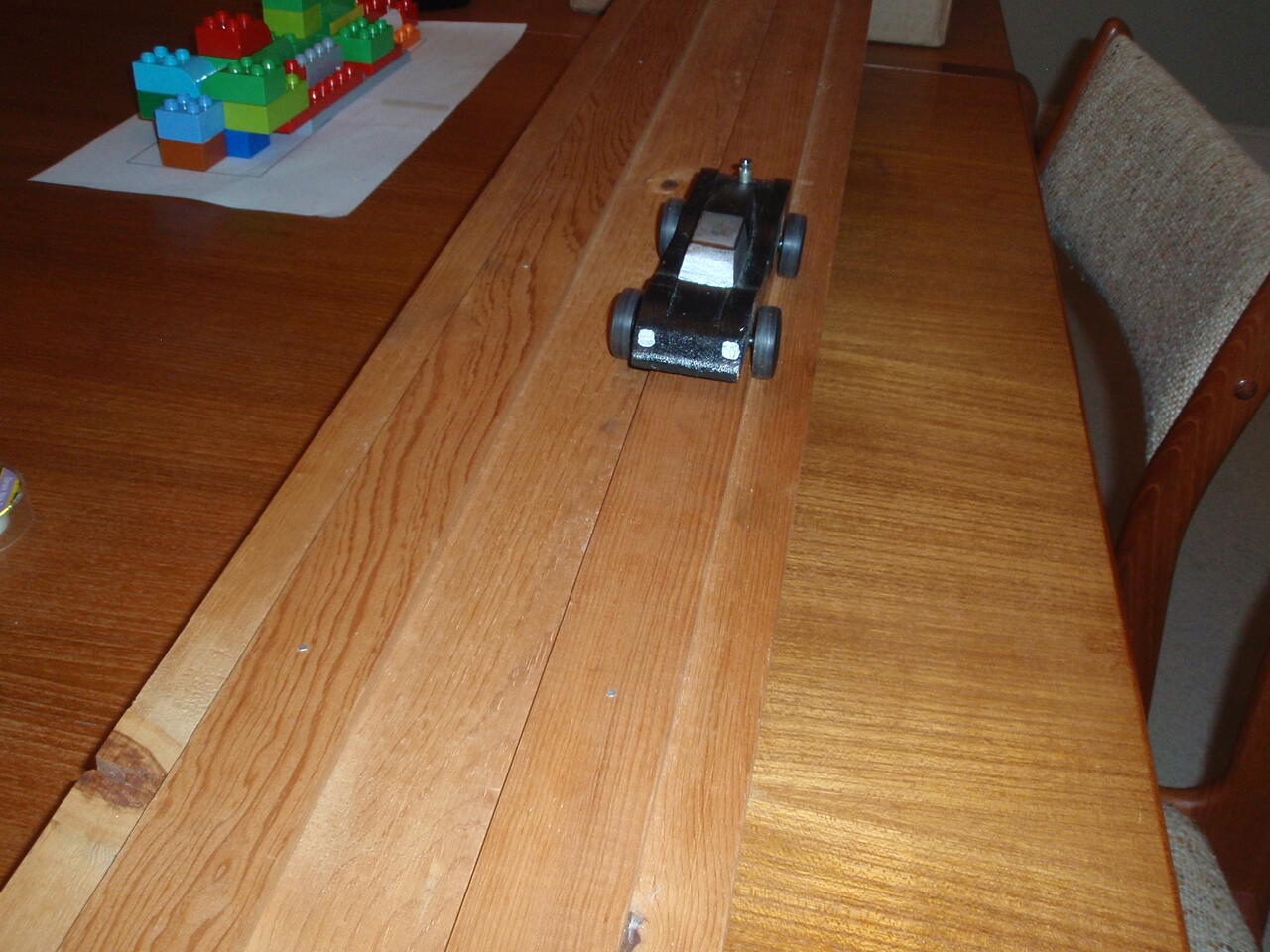

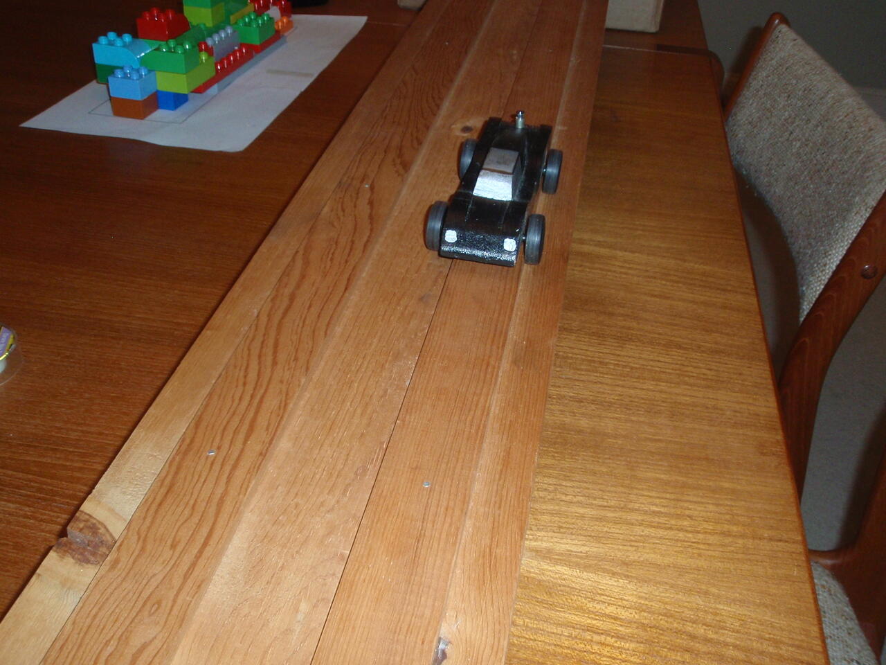

            Some wheel lube is still needed and testing. Got out the old test track and a previous car for comparison.
            Click image for larger version  Name:	P1190706.JPG Views:	0 Size:	151.5 KB ID:	847596
            Click image for larger version  Name:	P1190705.JPG Views:	0 Size:	176.5 KB ID:	847594

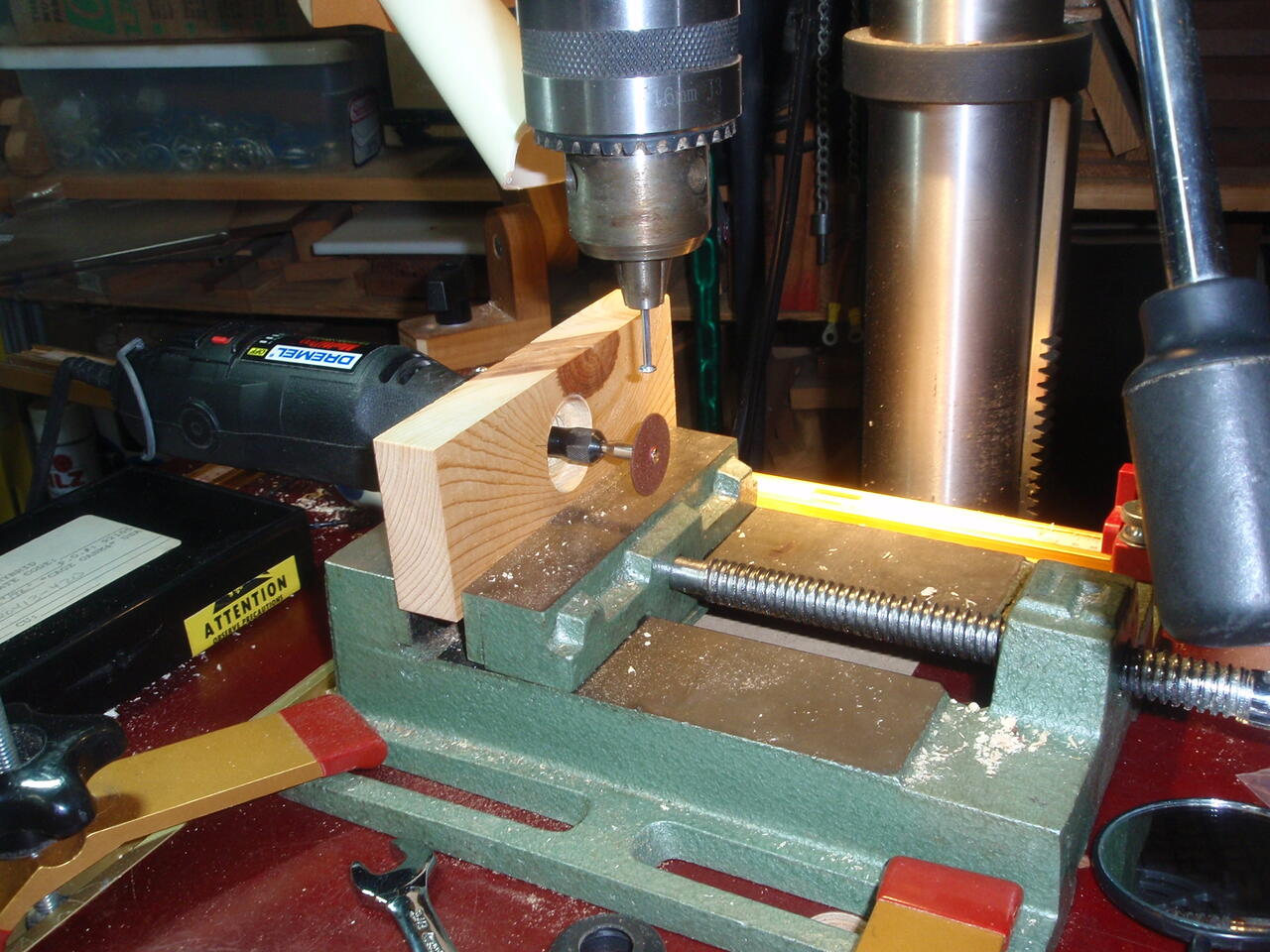

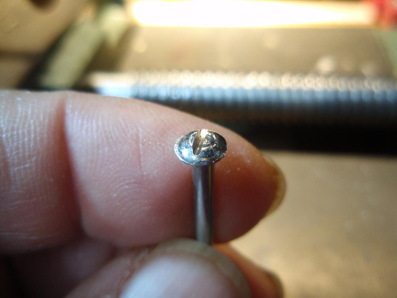

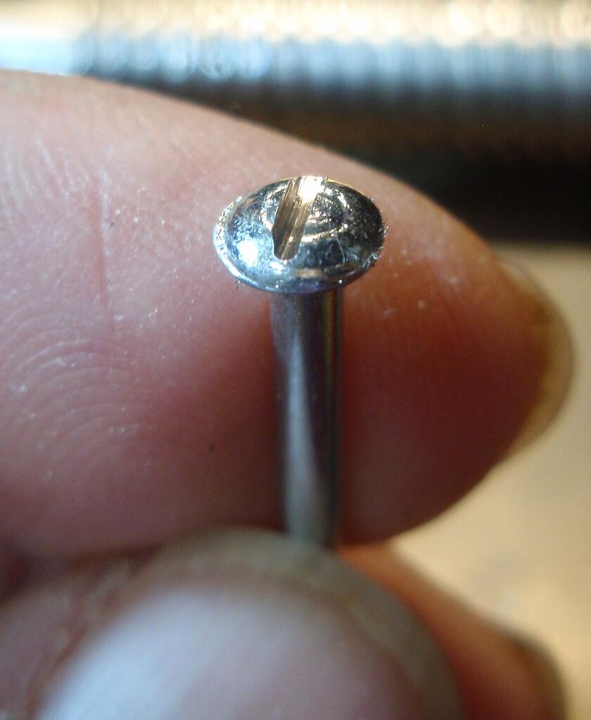

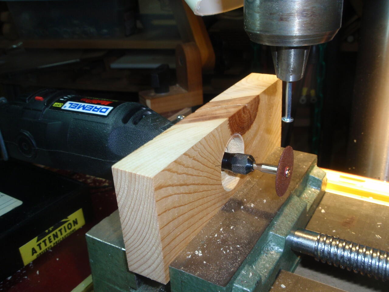

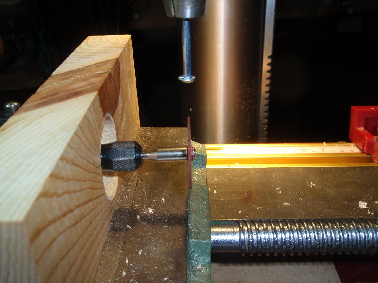

              Had to slot some nail heads so we could position/rotate the axles for best fine adjustment of steering.
              I'm not too steady free-handing a Dremel and a nail for this so I came up with the following setup.
              If you didn't know the Dremel tools have a threaded nose to mount it to things (it is under a removable trim ring) allowing me to fix the disc in a fixed location.
              I used the drill press to precisely hold and lower the nail head with steady orientation onto a spinning cutting abrasive wheel (Don't turn on the drill press!!!!)
              Click image for larger version  Name:	P1190707.JPG Views:	0 Size:	184.9 KB ID:	847634
              Click image for larger version  Name:	P1190709.JPG Views:	0 Size:	132.6 KB ID:	847632
              Voila!

              Tooting my own horn, I felt pretty clever. Worked like a champ!

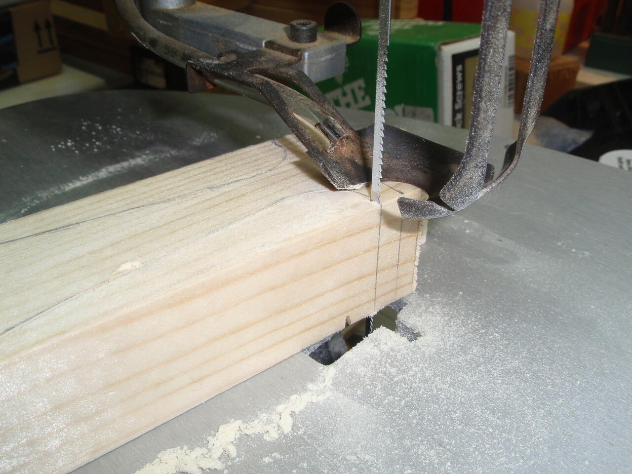

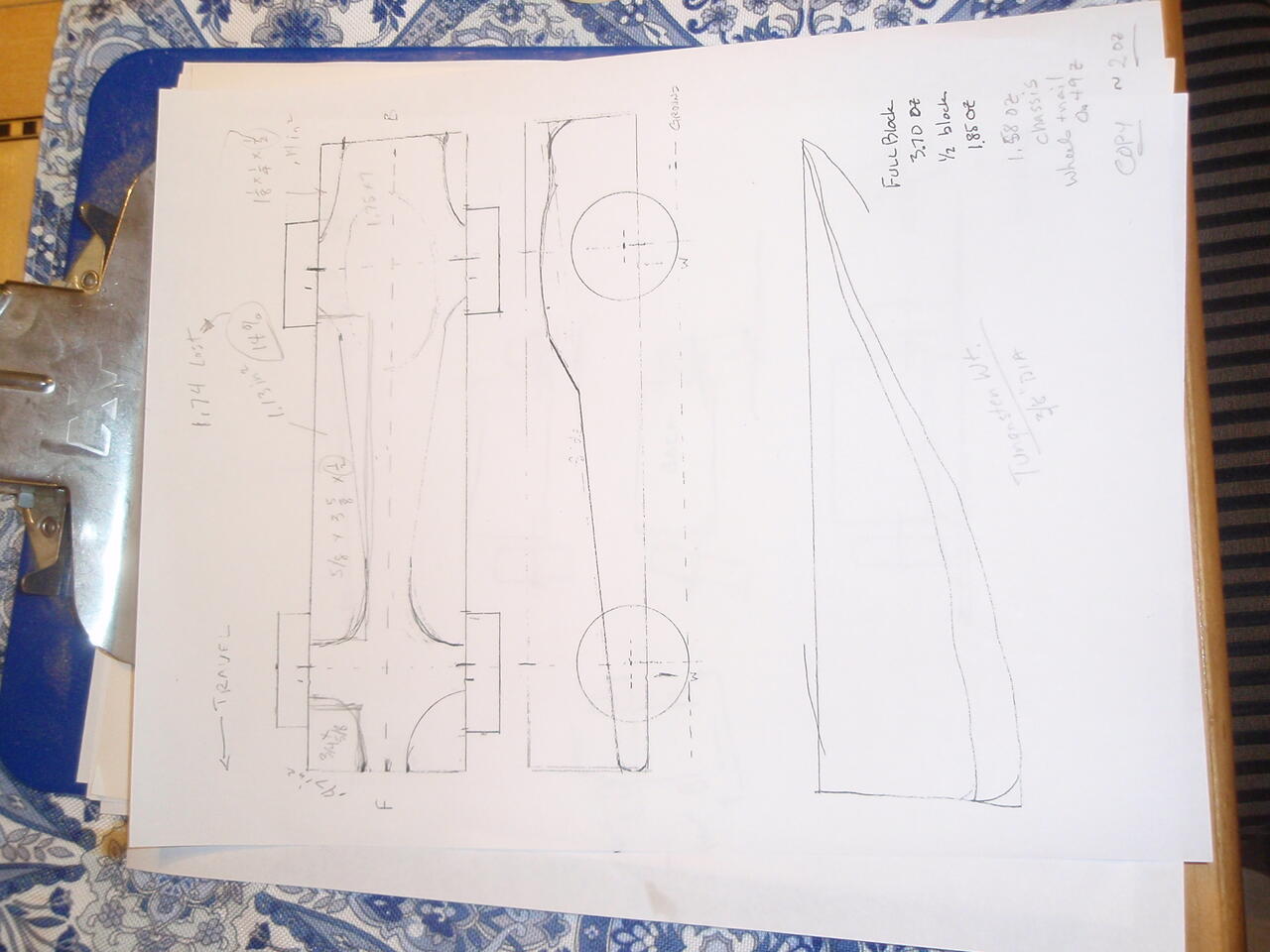

                • 22047

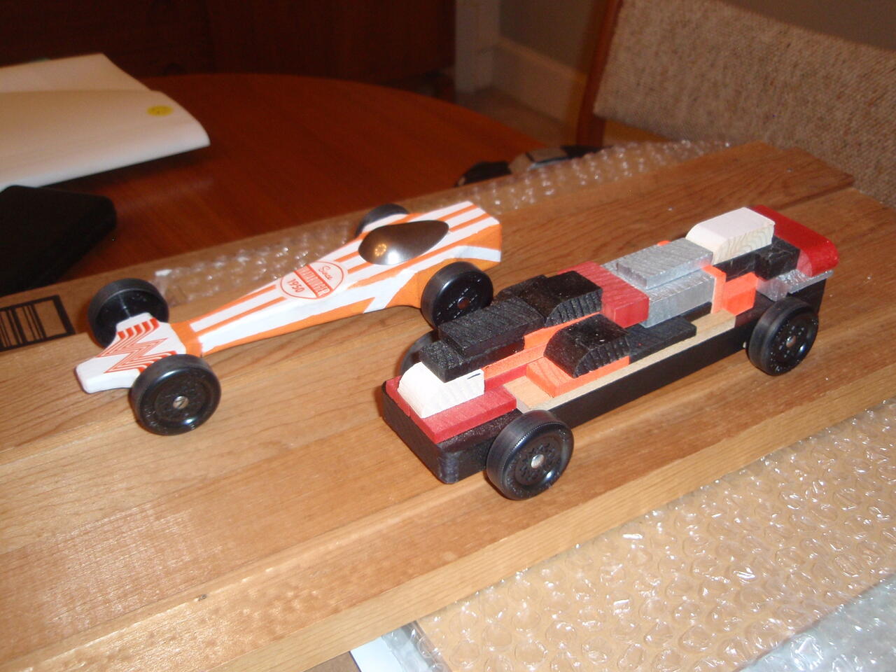

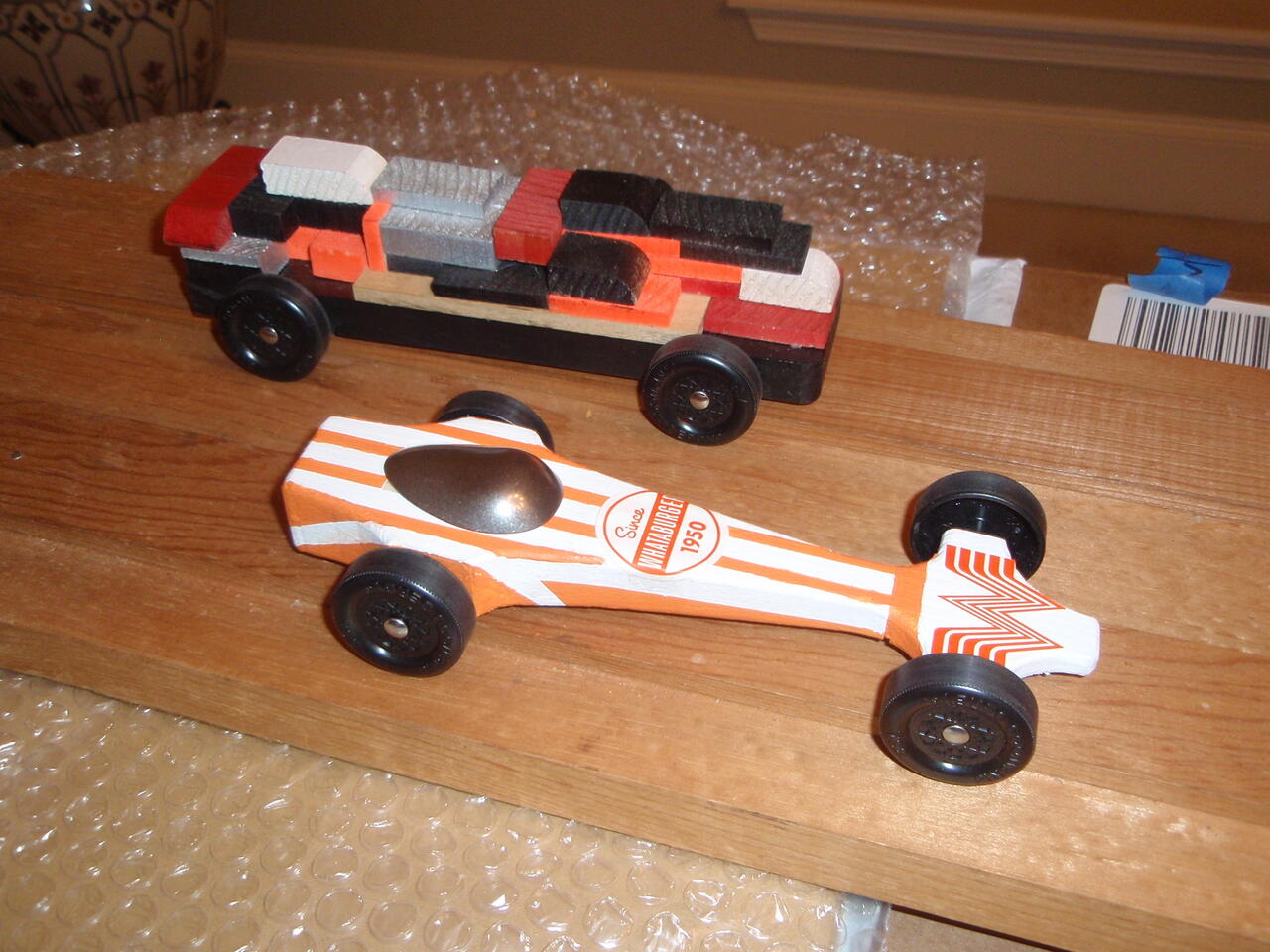

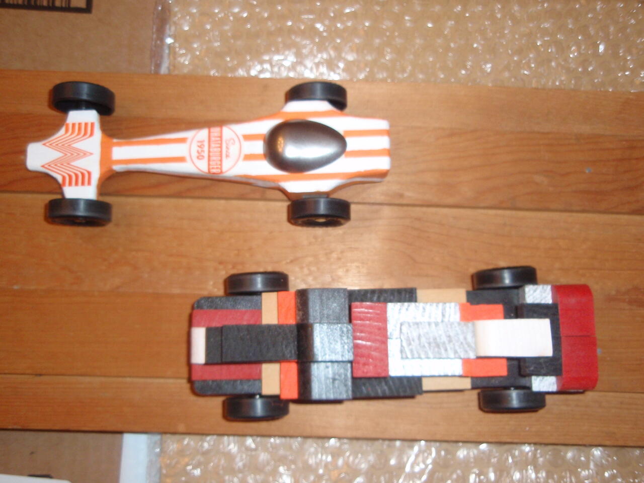

                Got everything pretty much completed, painted, weight corrected and tested and tuned a bit.
                Avoided last year's mini disasters by doing in the correct order... paint, drill axel holes, weigh instead of painting last which threw off the weight and lost the precision axle holes. But it required more back and forth coordination from the hardware teams and the painting/decoration teams.
                Those of you from Texas will know Whataburger. This is the Whatacar. The one on the right is Tiger Attack which is LEGO styled but OMG, no pips allowed he said. (which saved a lot of work!).
                Click image for larger version  Name:	image_27345.jpg Views:	5 Size:	148.7 KB ID:	847672
                Here's a gallery of pictures of the completed cars and boys.
                And a short (9 seconds) video clip P1200720.AVI you will have to download to see.

                        What do you mean you don't have screw slot files! Great looking cars. Hope they do well. I have had dremels for decades and never knew about the threads, thanks for the educational tip. Oh yeah I don't have screw slot files either.
                          • 3774
                          I like how you rigged up your own milling machine, creative. Agree, the boys will remember this forever.
                          Just a thought, do they allow the participants to 3D print the bodywork yet?
                          Some supply stores (like Hf) sell inexpensive machine vices with indexable x and y axis that are real handy for small shop milling jobs like this and making slots in metal and wood. Just Chuck up small cutter in the drill chuck and you are in business.
                          good work
                            • 22047
                            The threads on the front of the Dremel tool is a 3/4"-10TPI, hidden under a trim ring; I just used a normal metal working tap like the one below. On the Dremel tool its used for the router-like base attachment.
                            21/32" recommended drill is what I just looked up; probably 5/8" is fine for wood-I think that is what I used since I don't think I have a 21/32 drill.
                            https://www.amazon.com/gp/product/B0...e?ie=UTF8&th=1
                            I wasn't sure if you were pulling my leg about screw slot files. I had to look them up. They do exist.
                            I think my idea worked pretty well.
