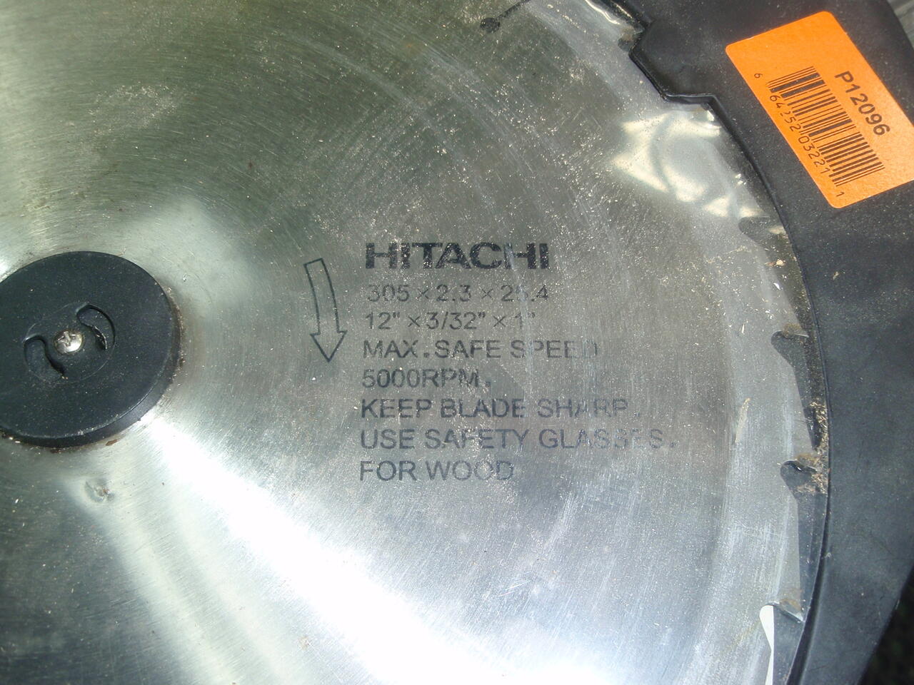

    I am sure the factory blade cuts, but its not a primo blade. thin kerf 12" with 32 teeth, looks like 15°hook angle.
    Note, Hitachi power tools is now Metabo HPT
    Click image for larger version  Name:	PB221145.jpg Views:	0 Size:	188.2 KB ID:	853056

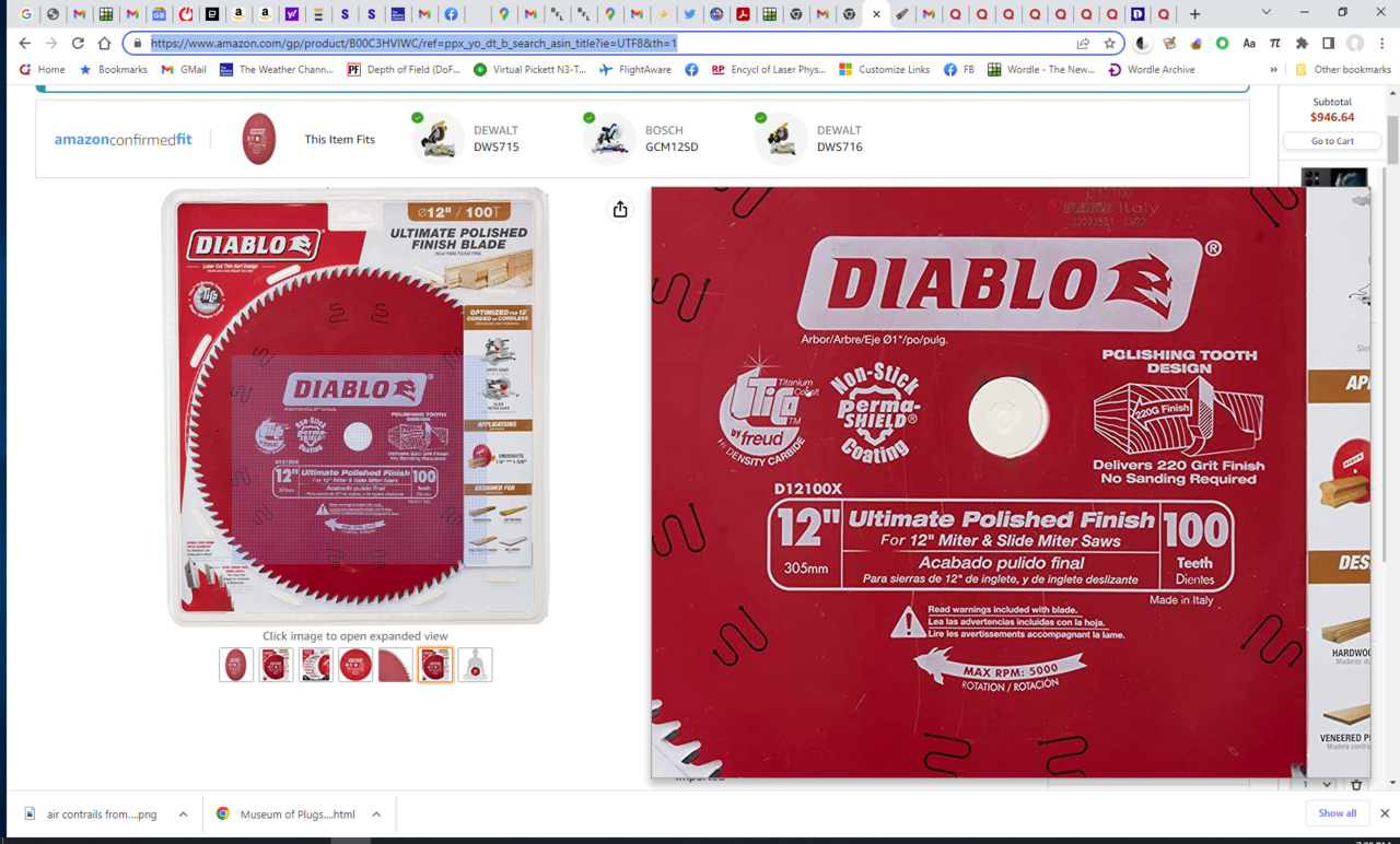

      https://www.sawdustzone.org/forum/di...er-saw-tearout
      Look at this thread. The Diablo 100T blade made a big difference.
      Still only $53 at Amazon
      https://www.amazon.com/gp/product/B0...e?ie=UTF8&th=1
      Highly recommend this 12" blade.

        I forgot about that thread. Yeah the Chicago Electric blade was beyond terrible. I can grab the blade off the old saw, but... why? It needs to be cleaned and sharpened by now anyway, might as well grab a new 100T Diablo and start fresh...

      LCHIEN I am really happy with what I had on the Chicago Electric, so I went ahead and ordered the 80t version. I am sure the 100t is great, just experience with the 80t.
