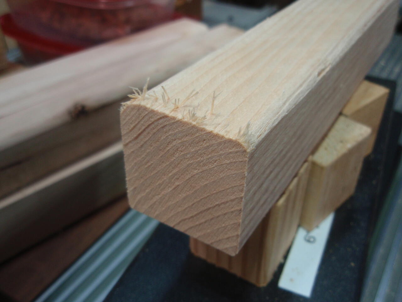

    I've been noticing on my mitersaw that I have been getting tearout on the backside of the cut. I don't recall this being a problem in the past, but maybe I've changed blades as I used to use a CMT 96T before I wrecked it and then for a while a DeWalt 100T blade.
    I have a 12" 80T negative hook angle Avanti Pro blade on my miter saw, the cuts are clean and smooth but the backside seems to have a fair amount of tearout.
    Varying the speed of the cutting stroke doesn't seem to help any.
    2x2 cut shown
    Click image for larger version  Name:	PB150463.JPG Views:	0 Size:	81.0 KB ID:	846101 Click image for larger version  Name:	PB150462.JPG Views:	0 Size:	84.5 KB ID:	846102

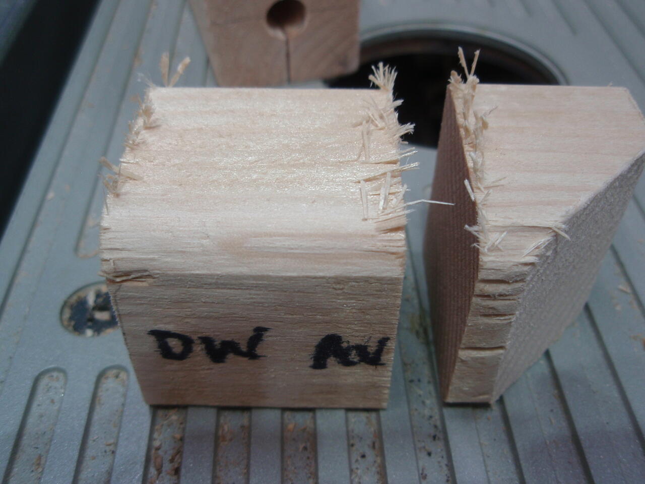

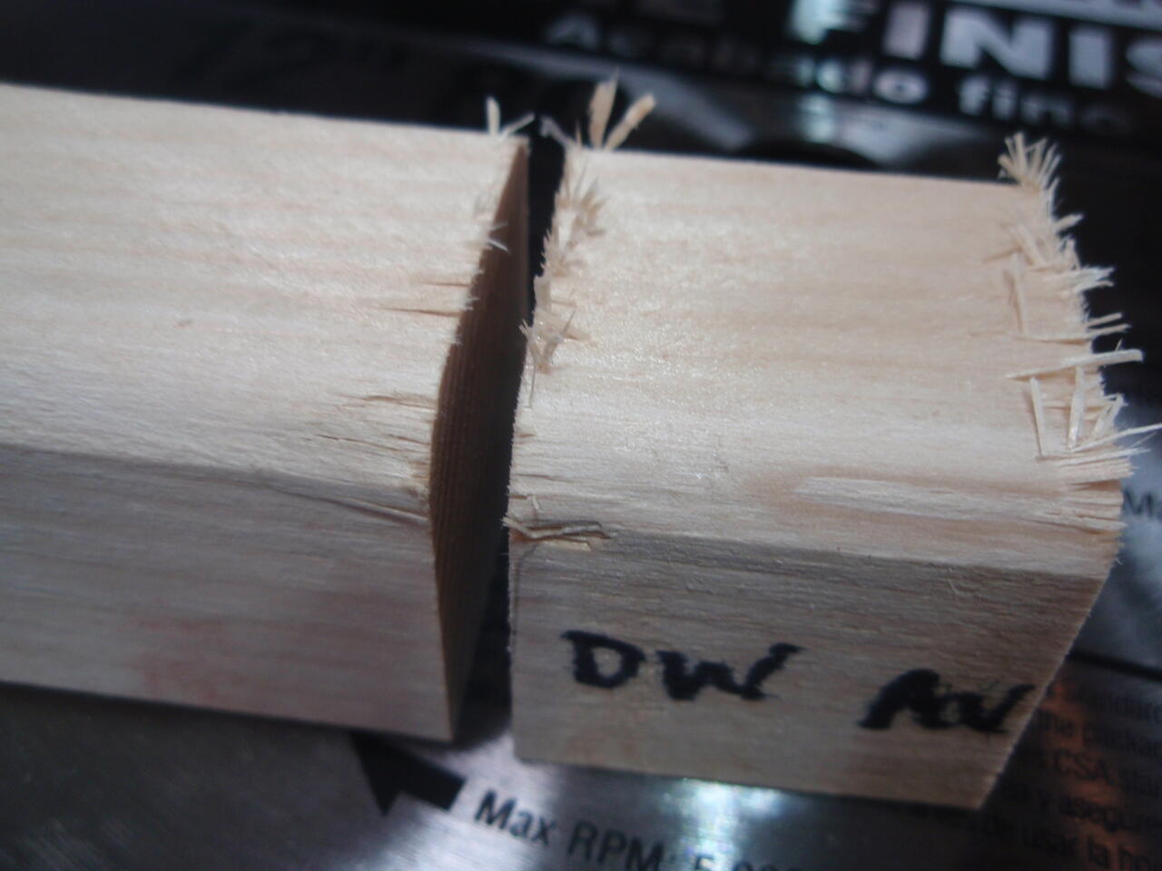

          Some more experimenting this morning:
          Click image for larger version  Name:	PB160470.JPG Views:	0 Size:	126.4 KB ID:	846123
          My $100 100T Dewalt blade does the same thing as the $15 80T Avanti Pro after swapping blades. However the more expensive, higher tooth count blade does have a noticeably smoother cut.

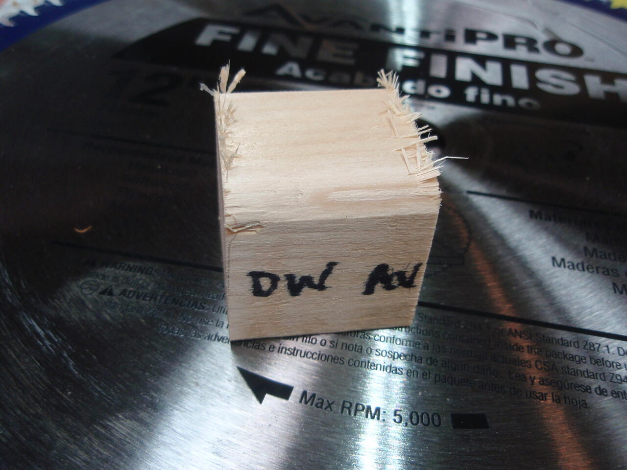

          interestingly, both sides of the cut have different amounts of tear out. I wonder why that is?:
          Click image for larger version  Name:	PB160471.JPG Views:	0 Size:	85.6 KB ID:	846122
          In the picture the side that is up was to the rear of the cut, i.e. the exit side.
          Maybe its really a function of the wood, as Hank says.

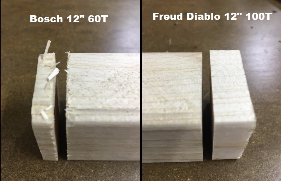

            This Amazon review of Diablo 100T shows a big improvement changing blades... 2x2 again
            Like me, he had unequal tearout, too.
            I'm looking for that right hand cut.
            Click image for larger version  Name:	Bosch 60T vs DIablo 100T.jpg Views:	0 Size:	124.9 KB ID:	846145
            Hmmm. Home Depot has that Diablo blade D12100X for $75. Amazon for $48.​ Very tempting...

              Good news. I did get the Freud Diablo D12100X blade. And it works great. Meaning the blade is the solution.
              Here are some cuts. The wood has been rotated 90 degrees to you so that the rear tearout in the miter saw is now on the top for easy viewing.

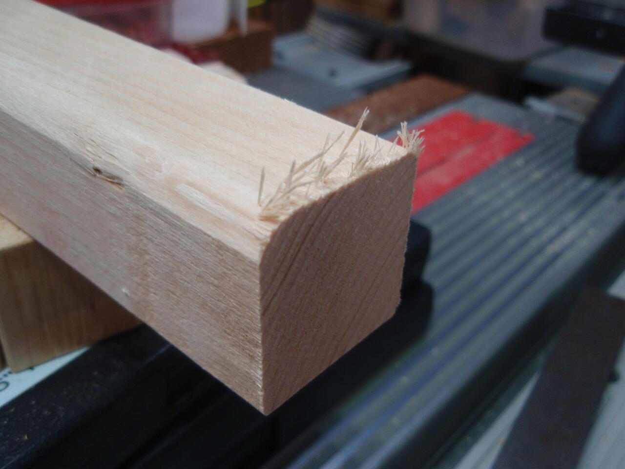

              The first picture shows the Avanti 12" 80T blade tearout on the right (really bad). And the Dewalt 12" 100T on the left, or at least half of it. I took this the other night.
              Click image for larger version  Name:	PB180484.JPG Views:	0 Size:	110.0 KB ID:	846177
              Here are two cuts I made tonight below. Different piece of wood, so I repeated the DeWalt cut. First I made the right cut with the DeWalt 12" 100T and there is tearout similar to the tearout the night before,
              The cut on the left is the new blade, the Freud Diablo D12100X with 12" 100T and a 7 degree hook angle. As you can see there is virtually no tearout.
              I jumped on it partly because Amazon had it for $48 and Home Depot and just about everywhere else had it for $70 to $75.
              So I am very happy. (but $50 poorer.)
              Click image for larger version  Name:	PB180483.JPG Views:	0 Size:	93.3 KB ID:	846176
              So basically I was able to duplicate the results of the Amazon user review and get tearout free cuts in pine with the Diablo D12100X

                That right cut is what I get on my Central Machinery 12" SCMS with the Diablo blade. Seriously consider going with one of them, you won't regret it.
                  LCHIEN commented
                  100 tooth version? I think they sell 60,80, 90, too.
