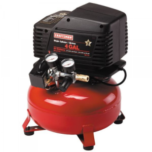

UGH Compressor died
    UGH Compressor died
    it trips the circuit breaker.
    If I just connect it momentarily, it hums really loudly but doesn't turn.
    Craftsman 4 gal oilless pancake compressor ( I think made by deVilbis for Sears).
    Yeah, so maybe starting capacitor bad or shorted? If not the cap them maybe the centrifugal switch is bad.
    What else should I check?
    I presume if the motor was shorted it would simply trip the breaker real fast and not hum like it does.
