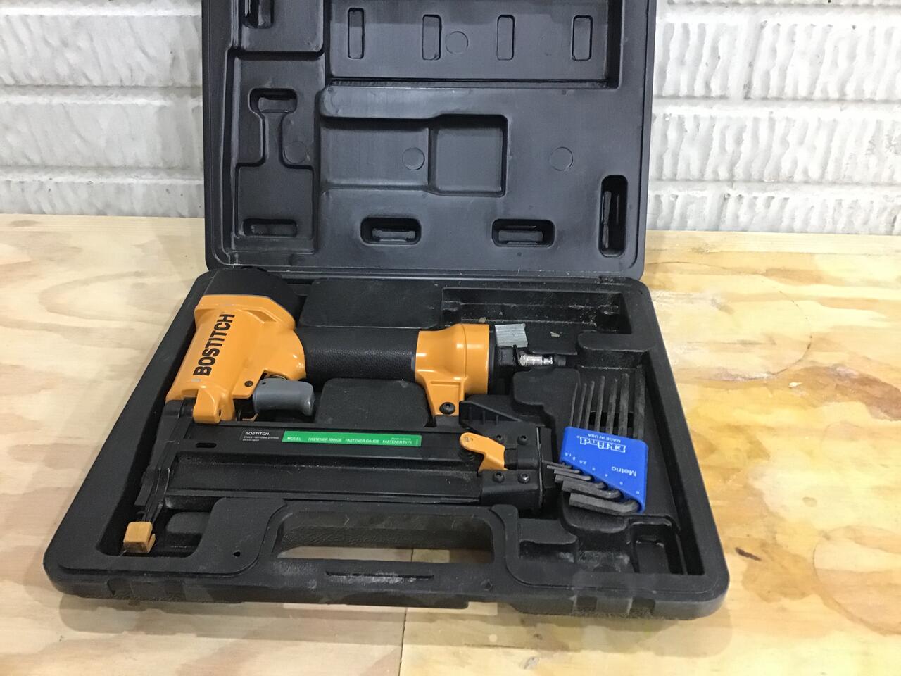

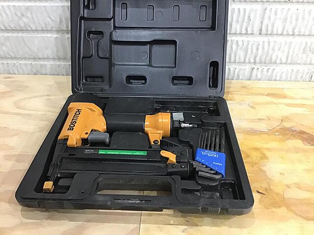

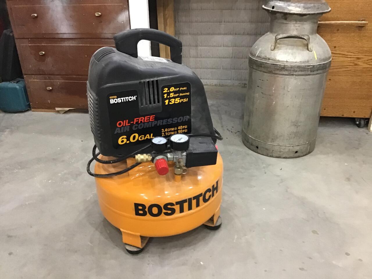

    I think you'll like it. If you only occasionally use one, the oilless, pancake models are a good idea since they occupy a small space. I bought mine in 2009 from Lowes because I was redoing all of the woodwork and doors in our previous home. It's a Bostitch model that came with an 18 ga. nail gun. It was on sale for $189 and has been trouble free. I do use the bottom tank drain each time I done with it and yes they are noisy. I think mine is louder than 73 dB. Note the high tech steel shop stool in the background.

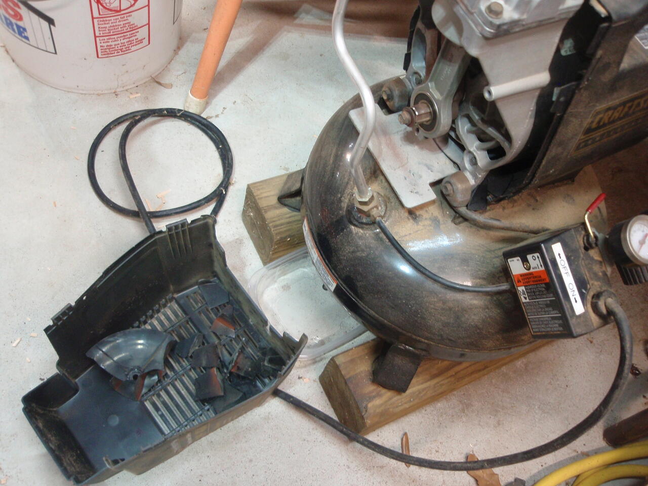

        Tore into the compressor a bit today. Just getting the shroud off was a pain. THe air filter element was missing. no telling how long I've run it in the garage with no filter.

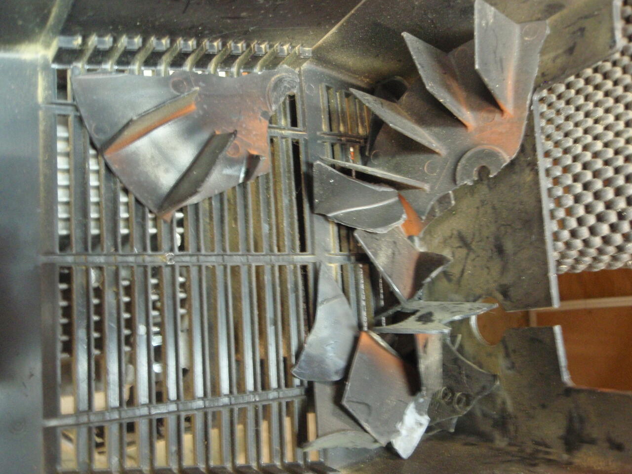

        So I heard some stuff rattling around... when I get the shroud off, I find the fan is shattered in pieces. AC-0108 same as the deVilbis, available for $9. After poking around on the internet I find this is a dead ringer for the DeVilbis 919-16735 which has some parts available. The parts lists and illustrations match and most of the part numbers are the same.
        But I find the rotor is stuck, it easily freed but it can only turn 270 degrees and its hitting something hard and won't make a full rotation. Probably why the motor stalled and tripped the breaker
        I think this machine has shot it's wad. It's toast. It's dead, Jim.
        May check in the morning and remove all the stuff from the shaft and see it the motor runs or not.
        Just hypothesizing maybe I left the compressor energized one day and it came on and the fan shattered, the unit overheated and there was some consequential damage.

        Why is it on 4x4's? To make it easier to drain into a container and not onto the floor. And to keep it from walking around the shop on its own when running which it did do.

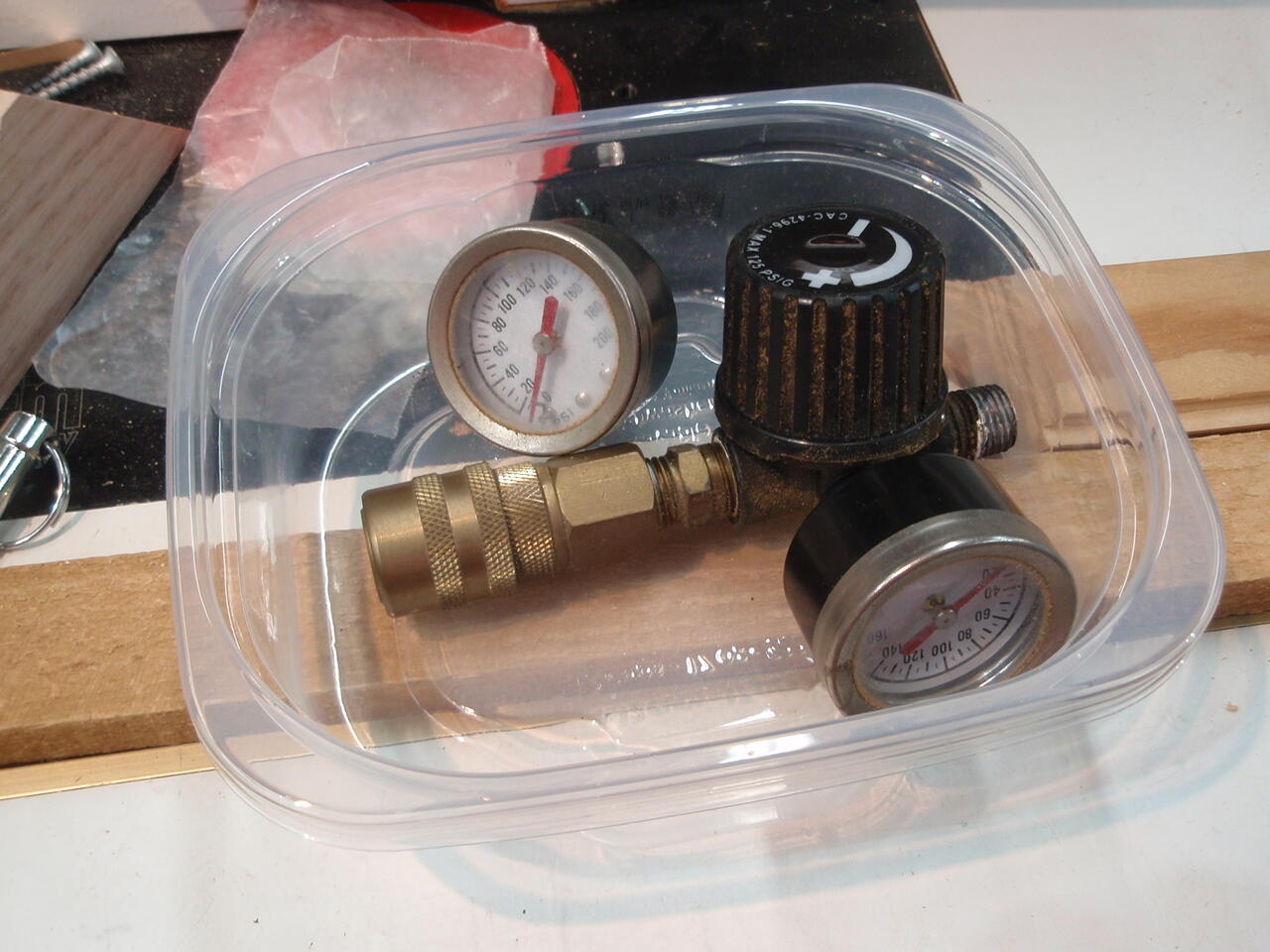

        Under the light of day the compressor motor is shot. Inside the cage I can see the plastic form is deformed and hitting the case. Turns freely but less than 180 degrees and hits hard on both ends of movement.
        Guess I'll salvage the gauges and regulator and power cord and ditch the rest.

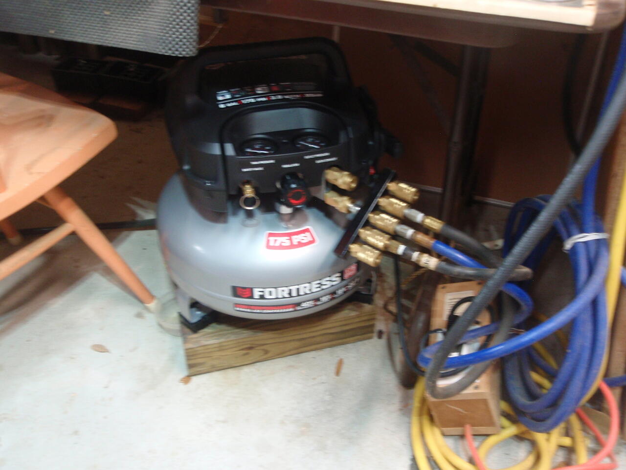

        The new HF Fortress powered right up. When I opened the drain valve it still had air pressure inside. I guess I let some Chinese air loose in Texas. Ran it open to atmosphere for 15 minutes to break in per instructions and then ran it to pressure. This one is 175 PSI tank pressure vs 135 I think on my old one. The sound is louder and higher pitched than the old which was somewhat less objectionable at a lower frequency. OTOH, the higher frequency does not carry outside the garage as much.
        Saw at Lowes today they had some Craftsman 6 gallon oilless compressors for $129 same as this one but the unit was a little lower power and less CFMs. But it did have a 1 year warranty - I hope I don't regret it. The HF only has a 90 day warranty.
        I do like the ball cock drain on the HF, its a lot easier to use. My old Craftsman Had a twist to close screw valve that was too hard to close tight enough by hand so I had to use a pair of pliers.
        Its holding pressure now and I'll hook it to my manifold a bit later. I have a five way manifold because it was the same price as the four on Amazon when I bought it.
        I have one hose by the door for outside work and tires. One going overhead to a retracting reel and one by the router/table saw.
        Oh! Do I need an extra accumulator tank? It will increase the time it takes to come up to pressure but it will be more air and less cycling. On the regulated side of course. I'm not replumbing a new compressor! 4 Gallon + 6 = 10. And it was only a 135 PSI tank anyway.
        Anyway, plugged in the manifold and all seems OK.
        New Compressor in its "home"

        Salvageable parts

            Post mortem on the expired Air compressor
            Observations
            1. found dead with tripped circuit breaker after having been left charged and energized overnight. Normally this should not be a problem, it leaks a little and will run for a short time every 30 minutes or an hour.
            2. Found that the motor hummed when plugged in briefly but did not run suggesting a bad start cap
            3. upon disassembly the cooling fan attached to the motor shaft was shattered into pieces. The motor and eccentric bearing with the piston attached would rotate freely about 90 degrees, but was hitting something the prevented full rotation... thus the motor was apparently stalled.
            4. Observation through the cooling slots showed a deformed and melted winding cage that was hitting part of the motor case, preventing rotation
            5. when installing the replacement compressor, the air manifold and distribution was found to be intact without significant leaks.
            conclusion -
            1. the motor got overheated.suggesting it ran too long without the fan.
            2. But the motor is "thermally protected" says so on the case so it should have cut off before parts melted. Sad because the fan is one of the few parts you can still buy.
            3. Should not have run for really long since the air system turned out to be intact... a major leak could have sent it into continuous running but there was no leak.
            So I don't know what caused the failure except perhaps it was 24 years old and the fan failure was a contributing cause. The thermal protection did not do its job.
            Otherwise Inconclusive.
