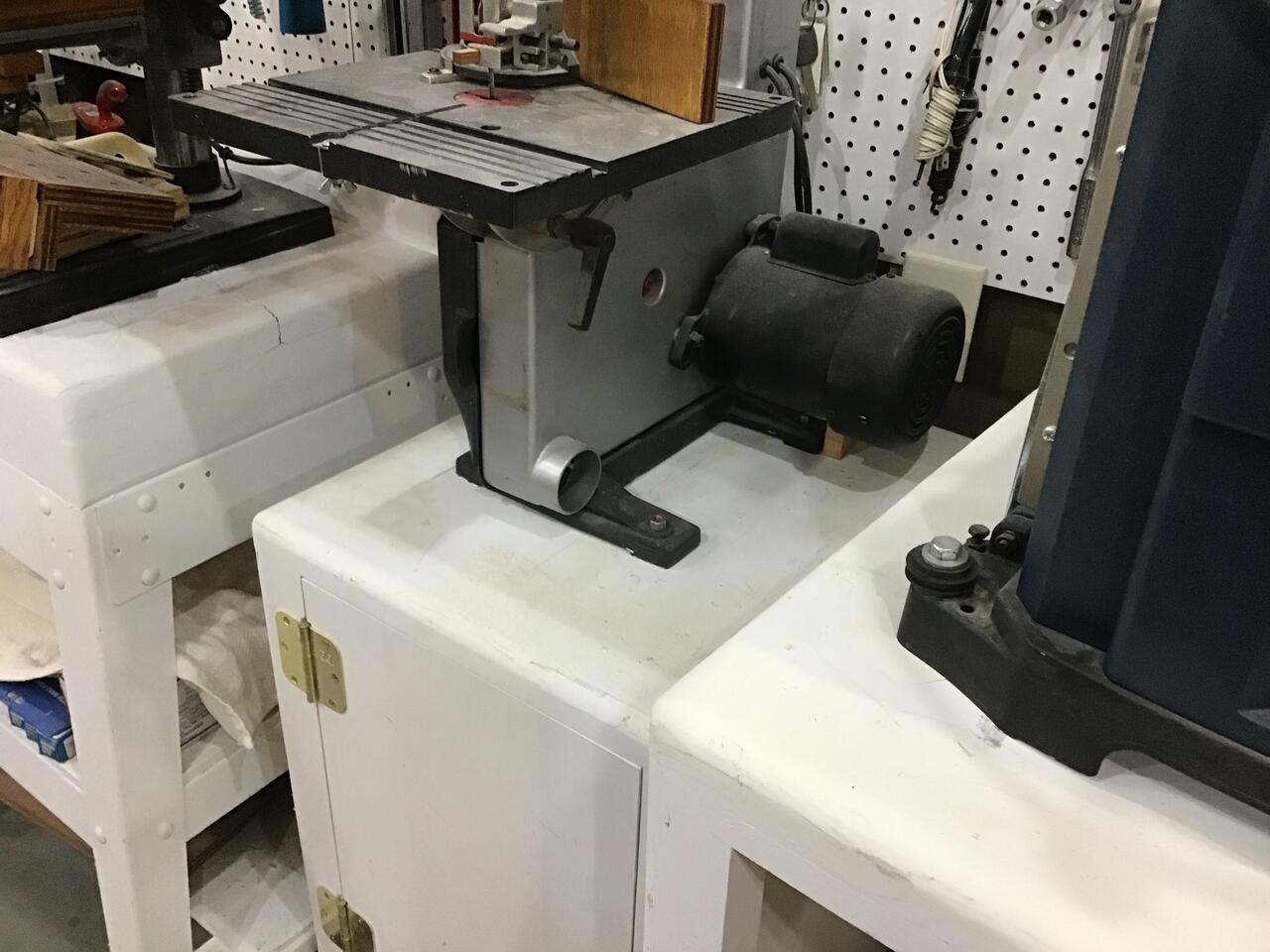

      The dust port on my bandsaw is located at the bottom "front" of the cabinet. The 2 1/2" port catches almost everything the blade produces. I occasionally open the door and vac out what little dust accumulates in the upper regions of the blade path. Oddly enough, the tire wiper never has much of anything on it. Click image for larger version

        Some, but sadly very few, of the 14" cast iron frame bandsaws have this configuration, and those that do, work well..

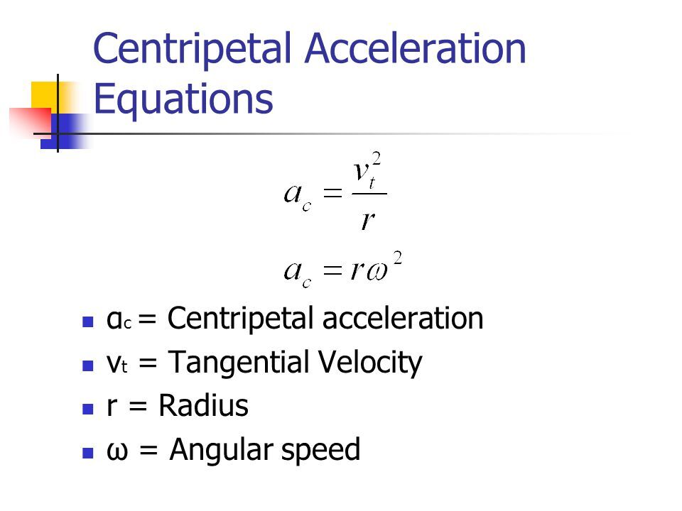

      Reread my post #1.0 in this thread. I added the calculation of acceleration flinging the particles off the saw blade as it rotates down from the cut and its about 90 G's. Not many particles are going to be coming up and around. Very little cutting if any on a properly tuned saw should be happening on the upgoing side of the blade, but virtually all on the down cutting side at the front.

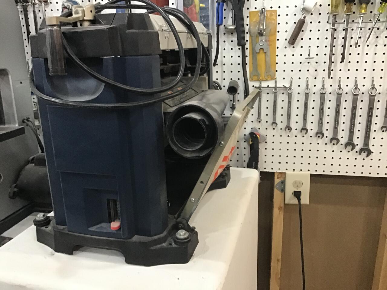

      Maybe a dumb question, but.... The Ryobi AP1301 planer I have has a 2.5" dust port. Is there a replacement that fits and works that will give me a 4" port?

        I have a 1300 model and this is the chip port that came with it. The big hole is 4" OD, but the opening is 2 1/2", so the 4" is just an adapter. I don't recall ever seeing any other one for these.

          Capncarl, when hooked to a shop vac, it works fine, when hooked to the DC it works fine, when hooked to the shop vac via ducting it jammed up. The AP1301 doesn't have a blower that I know of. It has the 2.5 inch port that side exits like what Jim posts, OR there is a flip open chute that will puke shavings straight out of the back of the machine. What that tells me right or wrong is that the 2.5" port is kind of at its limit when it does work. Just looking at possible options. Again trying to maximize efficiency of the system particularly at machine collection.

          Looks to be the same planer with a Craftsman Badge, it did have a fan, may have been the same fan as the motor cooling fan. It could have shed a blade or two and impedes the discharge. When operating properly it would spray sawdust like a show blower when not hooked up to dust collection.

        I've not had clogging issues with the 2 1/2" port and my ShopVacs, but I usually take light cuts, 1/8" at most usually and not more than 8" in width. I've always worried more about tearout than clogging. If I have a big reduction to do, I usually resaw down to near the final thickness and then plane to final.
