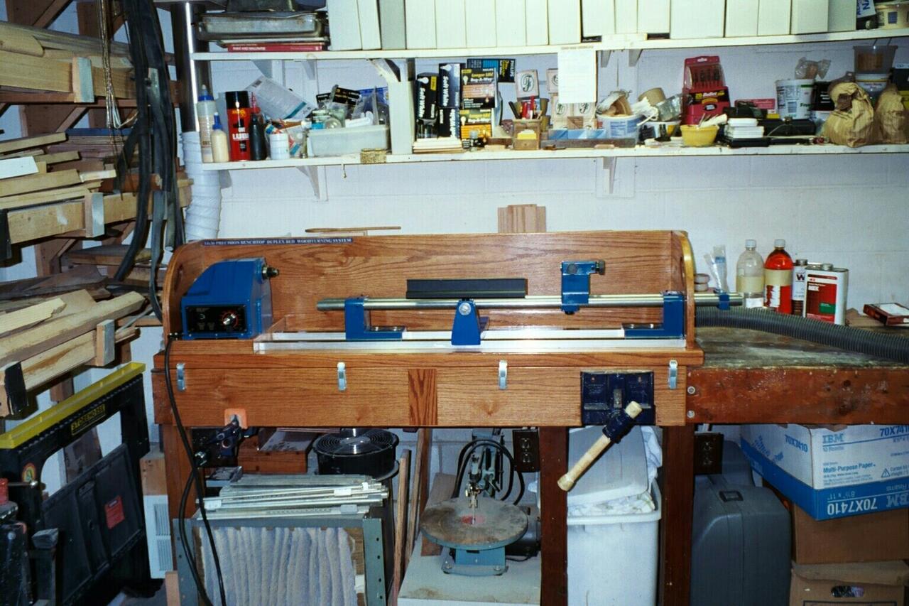

              My lathe also has a shopvac connection for chip collection. The torque box frame traps most of the turning waste so it's easy to just sweep them to the vac ports. I don't turn a lot so this works for me. Click image for larger version
Name:	Duplex Lathe Oper2.jpg

                Thanks Jim Frye for posting your dust hood / lathe pic.
                For anyone else participating in this discussion. Can you post pics of your updated / improved dust hoods / collection points and let us know how well they are working out for you?

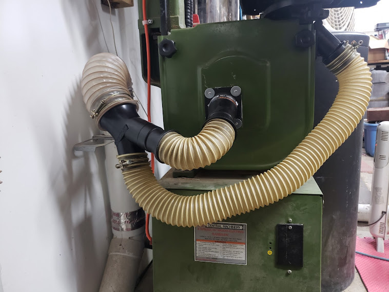

                On my bandsaw, I had previously made a dust port for 4" at the OE location by the lower blade guide, and it was horrible. just didn't work any better, and in many ways worse than the OE port. Sadly I lost the OE port, and ended up ordering one for a Jet 14" bandsaw as it looked to be the same thing, except the port size is actually fitting for 2.5" vac hose instead of 1.75 or whatever the OE was. I also added a port to as far down and left as I could go on the lower wheel guard.
                I haven't gotten much use out of the reconfiguration, but what I do is showing much less dust all around. I don't get a lot above table, but I do need to do something about that still..

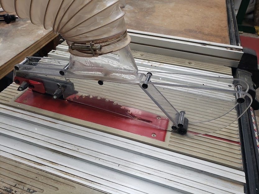

                  And another one. The BT3100 fitted with the Shark Guard, I swapped the 2.5" port back out for the 4". I originally swapped the 2.5" in because the 4" has a habit of sucking up thin strips...

                    Dave, your pictures aren't showing up the last two posts.

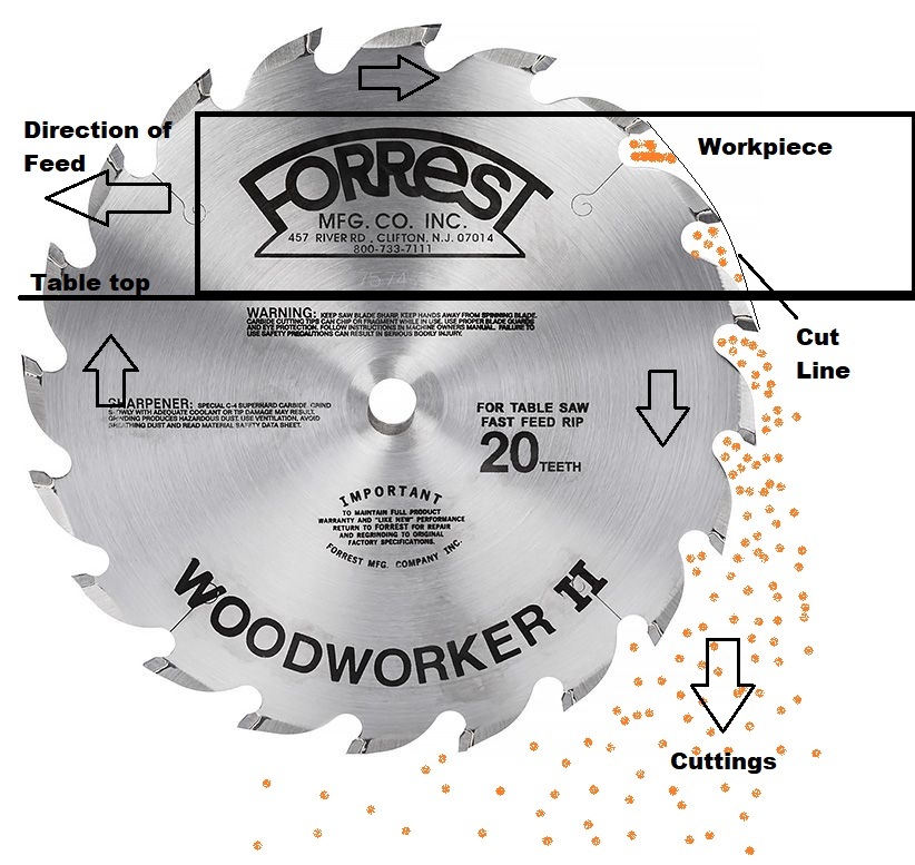

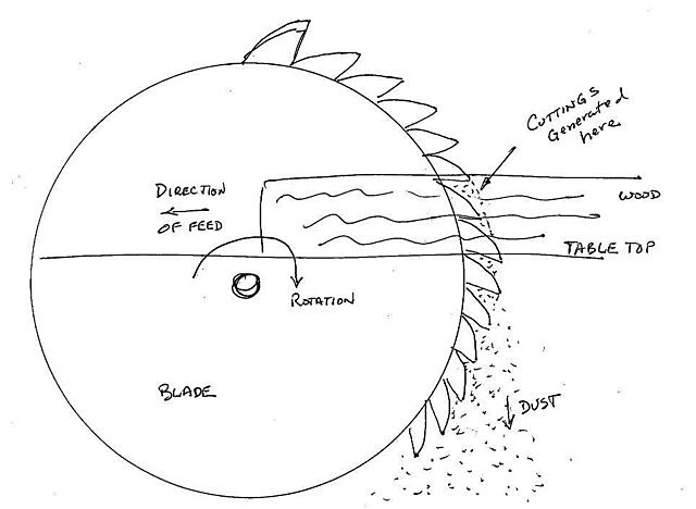

                    But I think your focus on the top collection of the table saw is wrong.
                    Look at how a table saw blade cuts... the blade turns forward and the teeth cut the wood. The wood is normally constrained by the sides of the kerf and the gullet between the teeth captures and pulls the cuttings in the gullet down until it is below the table and then drops them free on the side of the kerf, below the table top due to gravity and centrifugal forces. This results in the dust going into the shroud of the BT saws or into the space below the table where it falls to the belly pan if you have one.
                    In a cut where there is wood on both sides of the blade the only way a lot of dust is going to come off the top above the table is if the cuttings ride all the way around the bottom and back up the rear and are finally tossed above the table... gravity and centrifugal forces has to be over come for this to happen.
                    The only time I get a lot of cuttings on the top is when I shave off 1/16th inch or so to clean up an edge... in this case one side of the kerf is open so it throws a great deal of the cuttings to the left side of the blade onto the table top.
                    Click image for larger version  Name:	saw blade cuttings.JPG Views:	0 Size:	50.3 KB ID:	847605
                    New improved picture:
                    Click image for larger version  Name:	Wood cutting in table saw..jpg Views:	0 Size:	148.9 KB ID:	847635

                      I'll fix the images. It's a google photos thing. I am trying to avoid hosting my pics here but Google in a royal pain in the butt for photo sharing...
                      I am familiar with the concept, which is why I am keeping the 2.5" on the blade shroud, and the 4" on the belly pan, but honesty I don't care so much about the belly pan.
                      A bit contrary to your pic though, sawdust does come off the top of the blade, honestly not sure how, probably not getting left in the blade shroud as the blade spins, and I am just trying to keep from breathing it in. And as I mentioned, with the 2.5" port since the upgrade to the Wen impeller, it wil suck UP the hose hard enough it picks the blade guard UP away from the blade and away from doing its job. I'd rather move more air at less negative pressure so the blade guard stays put.
                      No matter the reasoning, I figure no real harm can come from running the 4" on top as long as I keep the 2.5" at the shroud connected...
