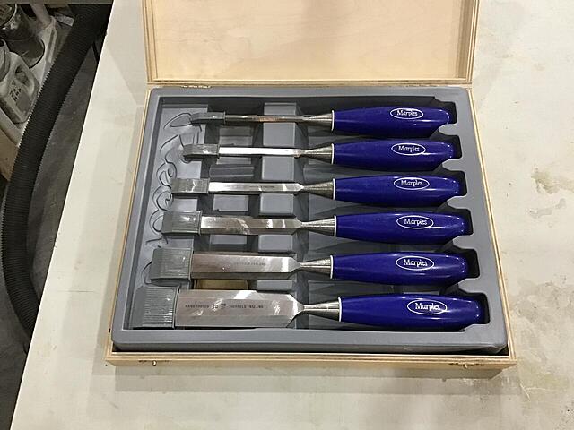

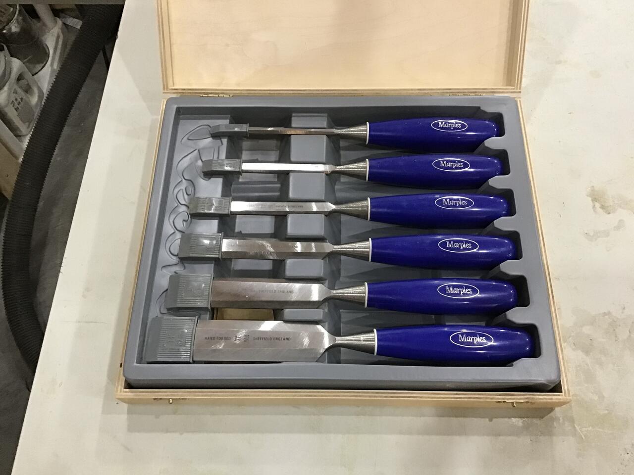

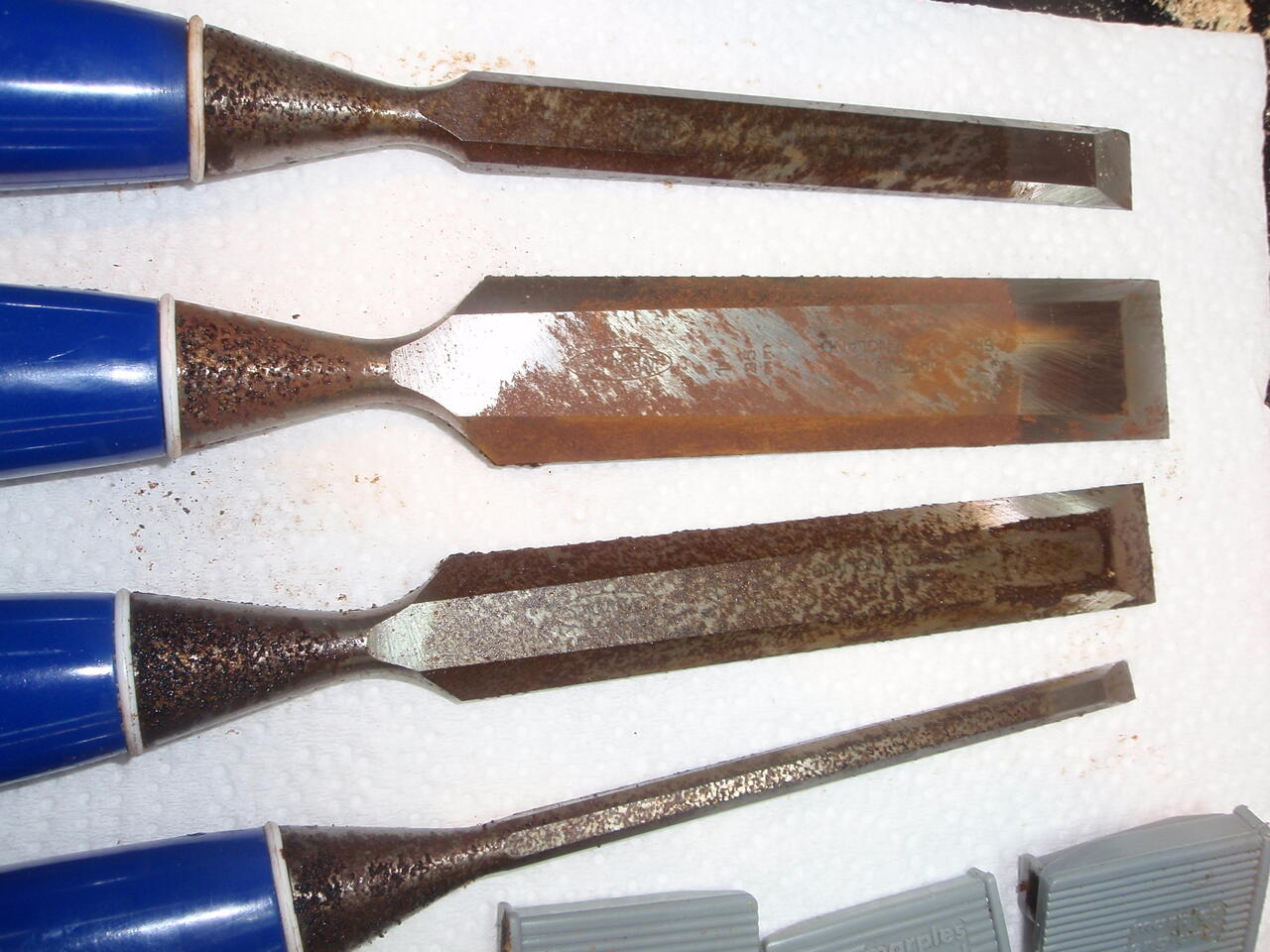

    I got these chisels a while back, I think they are the Pre-2008 English Sheffield-made Record Marples before they moved the production to Asia.
    Click image for larger version  Name:	image_27186.jpg Views:	9 Size:	237.7 KB ID:	847103

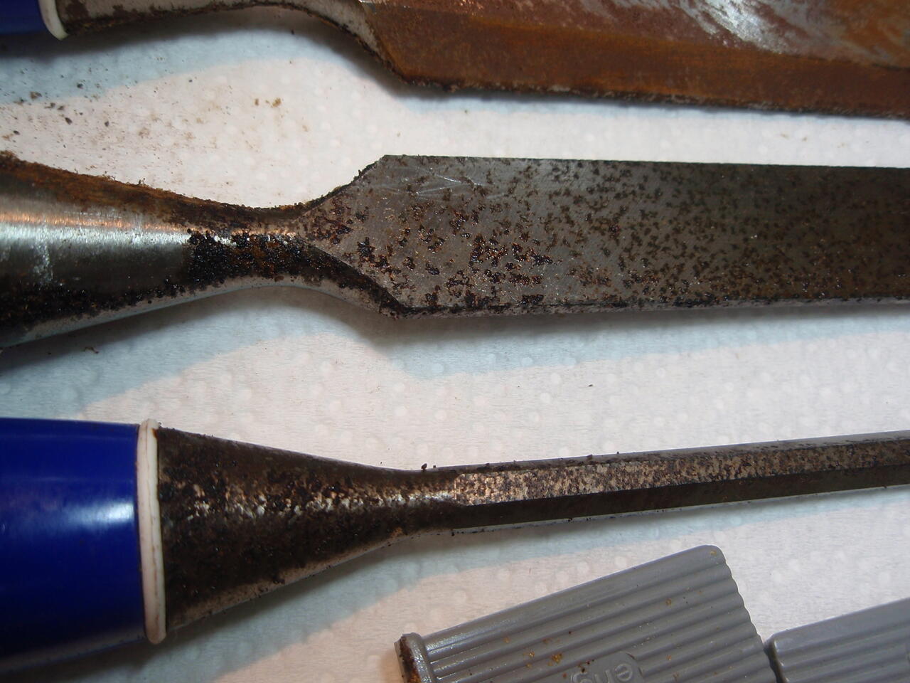

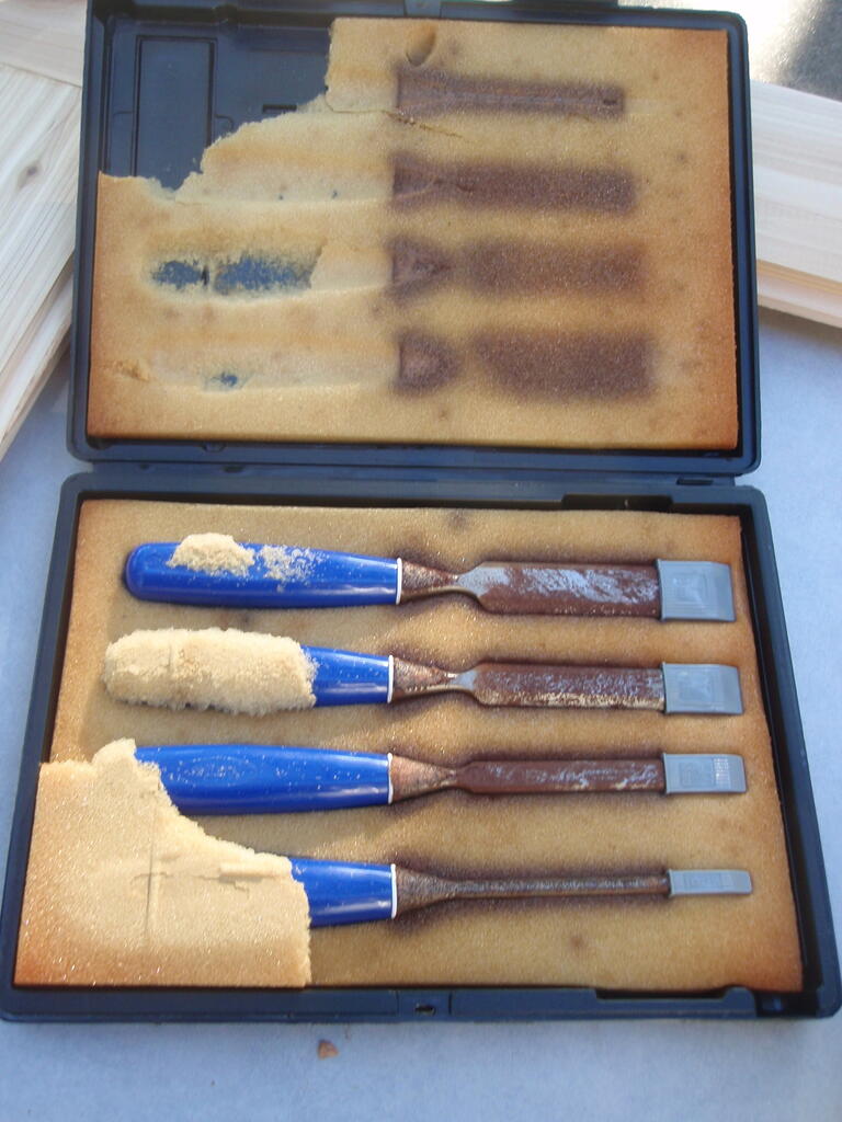

    I stored them in a nice foam lined plastic box, shown, which turned out to be a bad decision - either foam or the plastic outgassed and rusted the chisels all to ****.

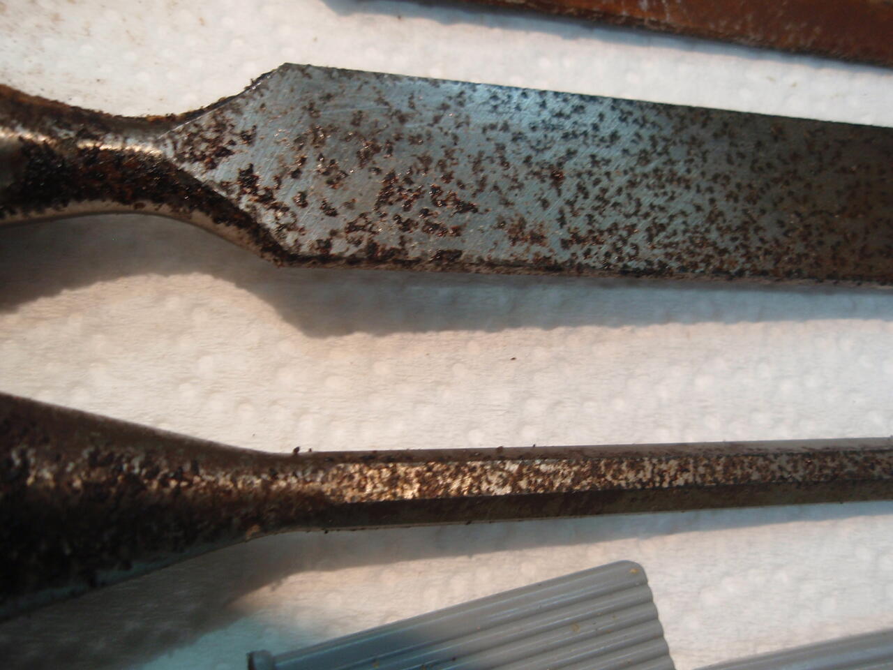

    I'm looking for some suggestions to de-rust these and perhaps polish these poor guys and turn them back into a badass chisel.
    What products, processes procedures would you recommend?
    Evaporust any good? I just ordered some.
    Click on the attachments for larger images.

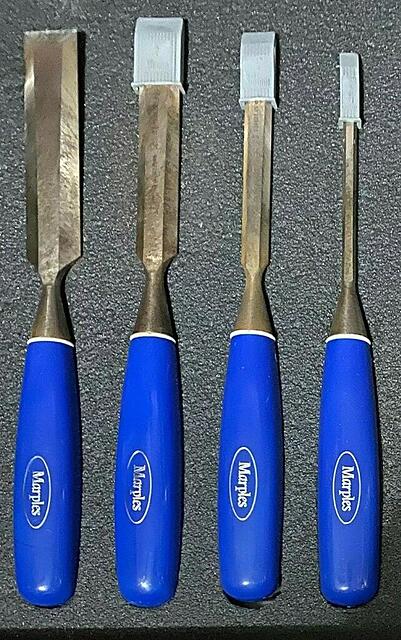

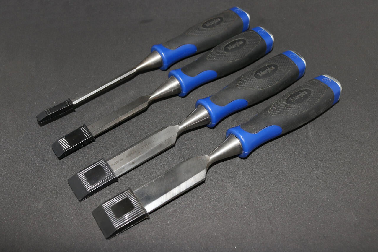

    This guy on eBay wants $199 for this set which I think is the same as mine. His picture from eBay listing, not mine
    Click image for larger version  Name:	s-l1600.jpg Views:	0 Size:	151.7 KB ID:	847108
    https://www.ebay.com/itm/22430810699...YaAnC7EALw_wcB

    I've had good luck with Evaporust... with one caveat: keep an eye on the items being de-rusted; once they are pretty much rust-free get them out of the Evaporust. If they are left in there way too long, the metal discolors to a darker color. Keeping the Evaporust warm, and occasionally stirring or sloshing it around so fresh stuff stays in contact with the tools, speeds things up. Some of that rust looks worse than surface rust. From the pics, it looks like the blade protector caps kept the blade edges fairly rust-free... at least they won't have rust pit damage.
    My dad has used electrolysis with good results to salvage garage sale hand planes. I've never tried it myself.
    What happened to your chisels sucks... if those were made in Sheffield it's a shame they didn't get along with the foam. Once they are cleaned up a bit, see if you can see the word "Sheffield" stamped in the metal.
    mpc
      • 3126
      I've been successful with mineral spirits, a 3M scotchbrite pad and some elbow grease. I generally use the green ones because that is what I have around the house.

          I think the real problem is that the foam is hydrophilic and sucked moisture out of the air. If you used that same foam for other tool cases, it may be a good idea to search them out.
            LCHIEN commented
            I was surprised. The box was one that expensive and sensitive electronic or optical components came in that was empty. It was foam padded and just the right size for chisels so after we used the stuff inside I put my chisels in it for safekeeping.
            Clearly whatever was in the foam released a lot of oxygen or moisture to attack the high carbon steels.

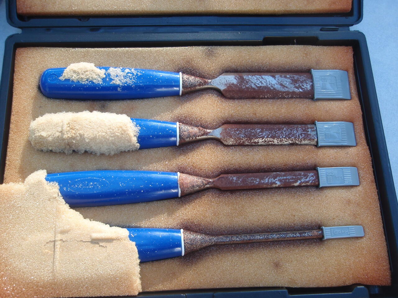

          When I inherited tools from my FIL, some were rusted from being stored in a detached, uninsulated garage. I removed the rust with some wet/dry sandpaper (600 grit and greater) and mineral spirits. I did final polishing on my variable speed grinder fitted with 2" wide cotton wheel charged with black and brown oxide. The Craftsman butt chisels turned out pretty much like new. The little block plane looked good for a couple of years, but has started to rust again. Here's my set of Marples. Notice the plastic storage separator. Also the stamping on the chisel irons.Click image for larger version

            Sad for you Loring. I have had things rust as well. A pink pencil eraser will remove light surface rust. I have not tried the chemical you plan to use so can't say but be sure to let us know how it works. I have used electrolysis for good effect on an old plane, but I would try less drastic means first. Other than being ugly as all get out I don't think it will effect function as long as you can keep the back flat. You will be grinding and polishing away the bevel with each sharpening. Reminds me of guns that have been stored in cloth gun cases, usually bad rust issues.

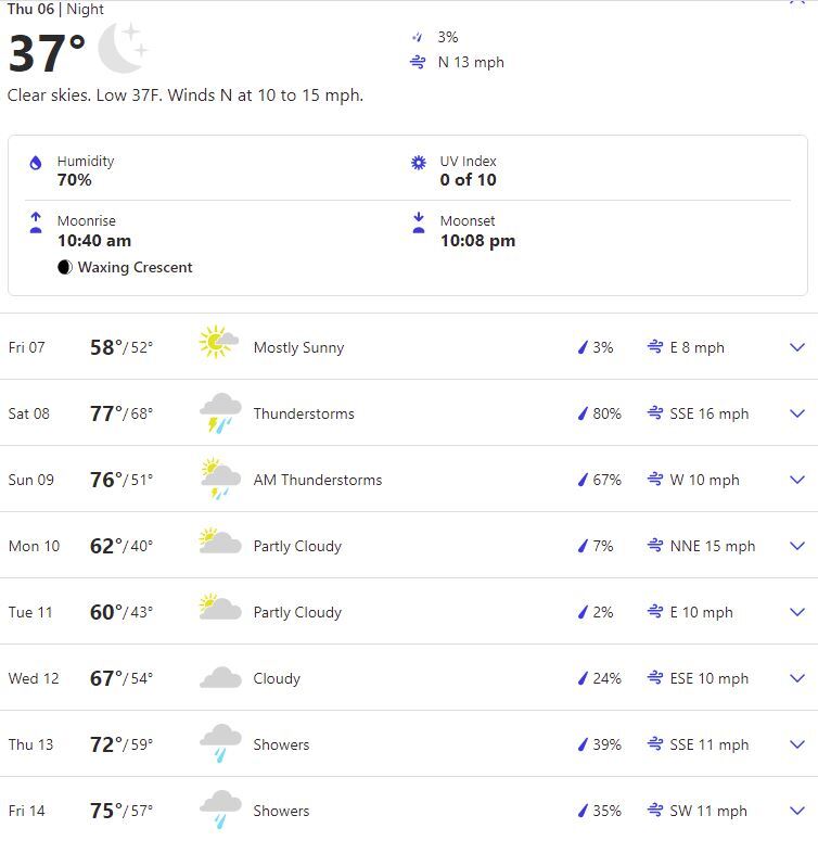

                    Maybe one window of opportunity Saturday...

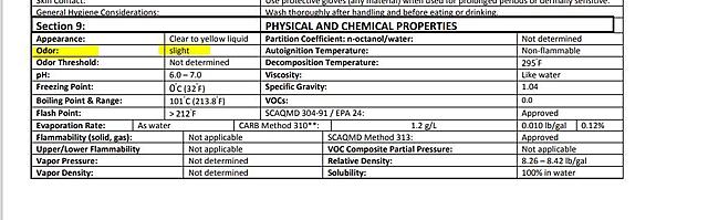

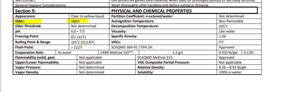

                    MSDS sheet not much help: "slight odor" what does that mean?

                            I've got a set of four Marples chisels that I purchased in January 2004 from Home Depot for around $30. These were about a year or so before Irwin switched to China, IIRC. These are not the "Record" chisels, as they have metal caps and oval-shaped handles. More utilitarian use I think, but the steel has held up fairly well considering I use rhem for general carpentry work. I keep them in a drawer in my shed and just wipe some oil on the blades after use. There is some darker spots on the blades, but no rust.
                            I also have a fairly decent set of Narex chisels which I keep in an adjacent drawer. After reading this post I went out to the shed this morning to check a few of the tools and found them rust free. But it is a concern with the high humidity that generally exists in this area.
                            In my last home the basement area was terrible, too much moisture and an extremely low ceiling. Anything down there rusted, even though I ran a de-humidifier almost constantly. I had some tools that showed rust and I tried electrolosis. That worked pretty well, but it turned the steel black. Still a mess to clean up and I was told that it could possibly weaken the steel. It might be worth looking into.
                            I've had a few other things get surface damaged because of long-term storage, even it the manufacturer's supplied case. Foam or flocking looks good, but after a few years of storage it can still be an awakening. I had a airbrush, kept in it's original storage case, that I found a real mess. Just this past week I went our the the shed to grab a plastic drafting triangle, which I found resting directly on the rubber-like draw liner, and it was stuck like glue. I had to pull it loose and and scrape it off the triangle with soap and water. I went back and lined the drawer with paper.
