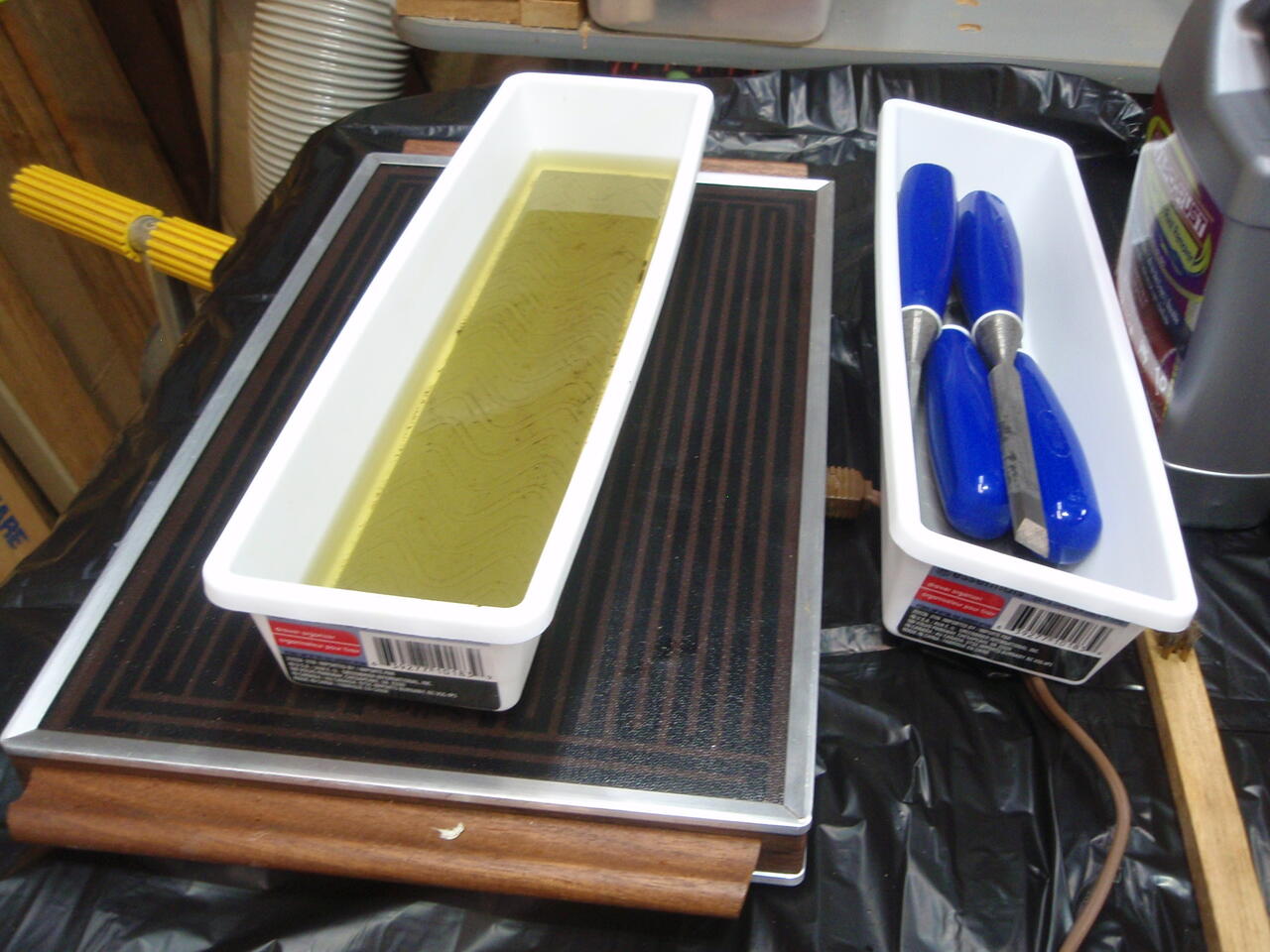

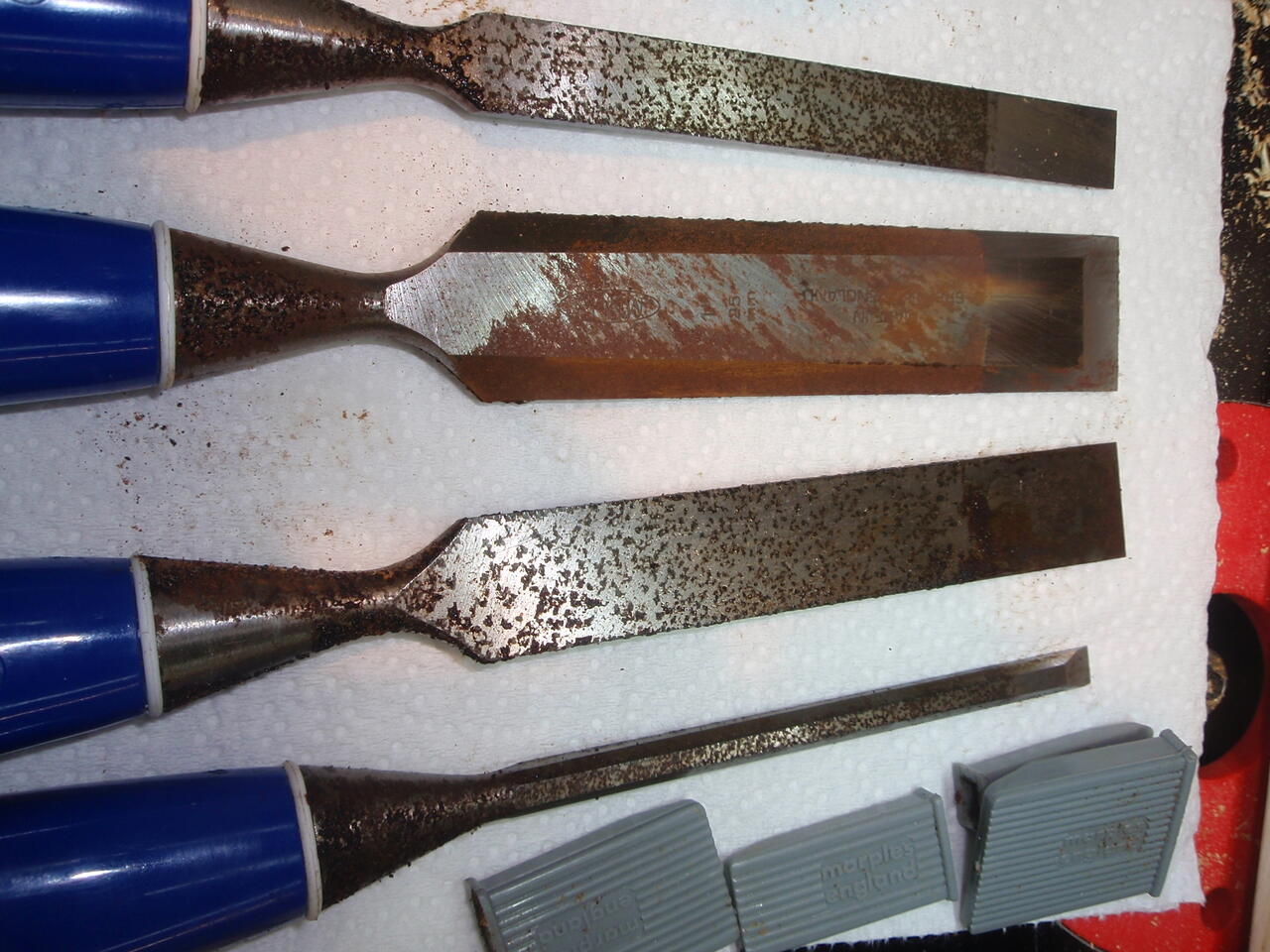

    I found a food warmer tray we've had for years but not used (the cord was still in factory windup).
    I plugged it in and it came up to 220 °F, a bit hot for safety as well as possibly melting the long thin plastic bin I was going to use. (PVS melts/softens a lot at about 221F/105C.) 275 watts. No thermostat, I suspect maybe self-regulating?/equilibrium.

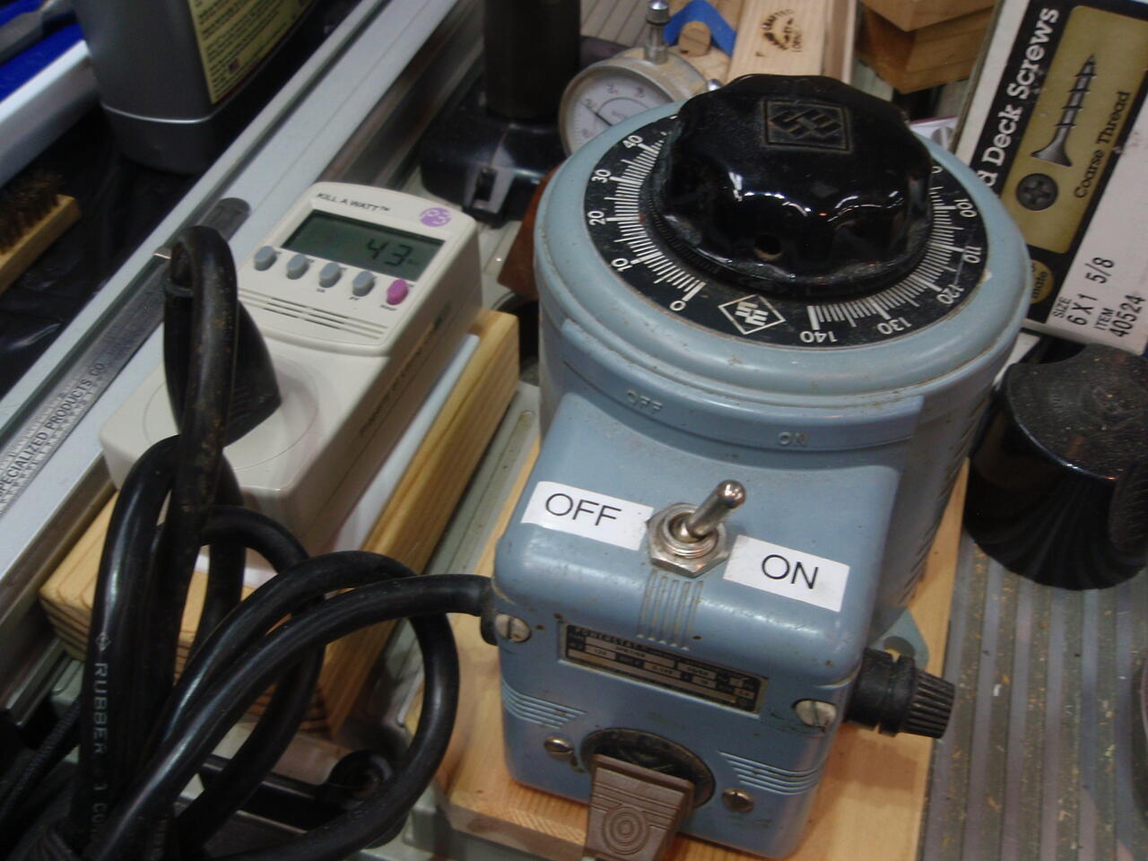

    So I put a Variac on it and tamed it to about 45 Volts and 41 W and it runs 130 F and the solution in the bin runs about 95 F. So it will keep it comfortably above room temperature and speed up the reaction a bit.

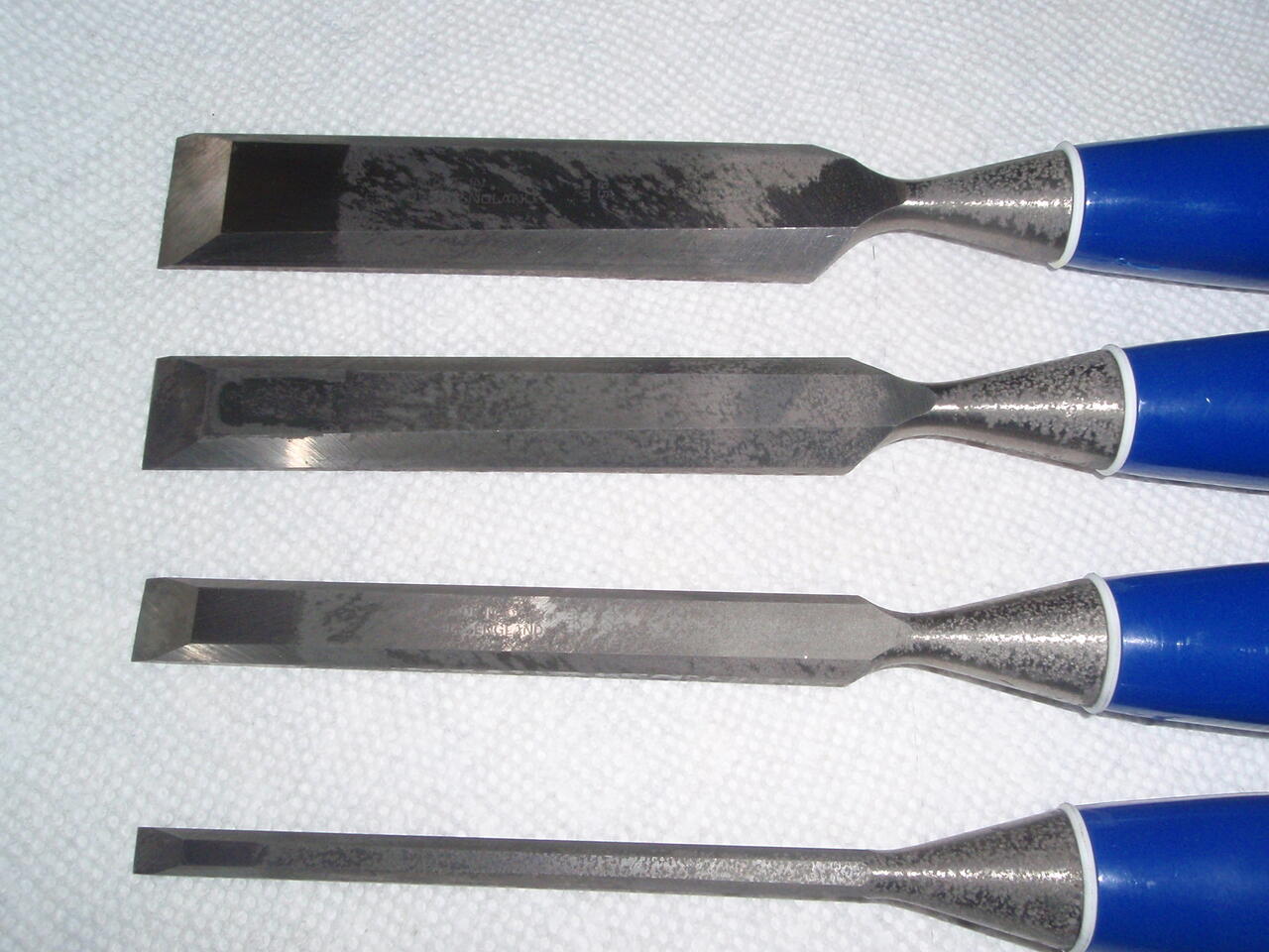

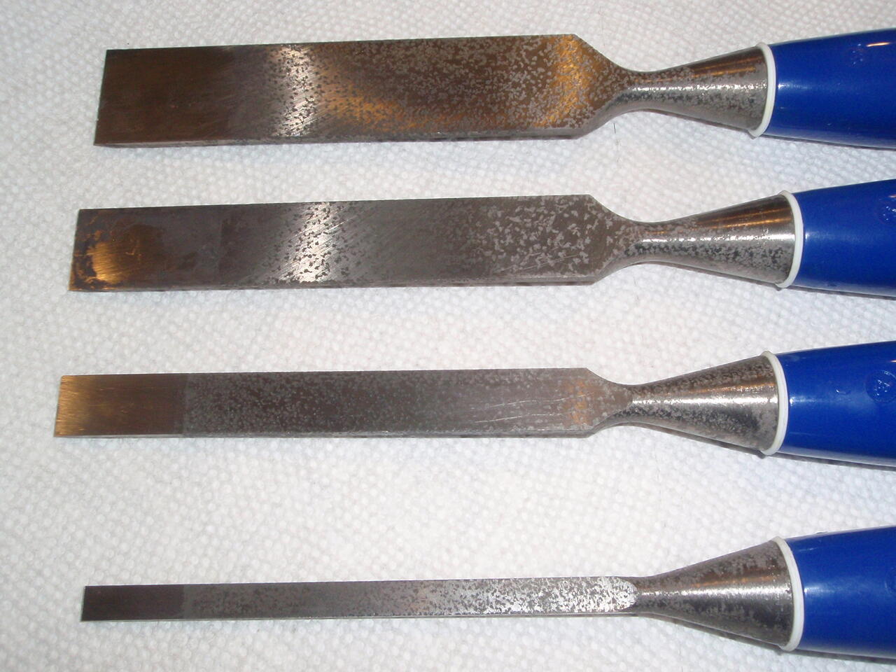

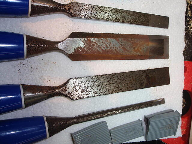

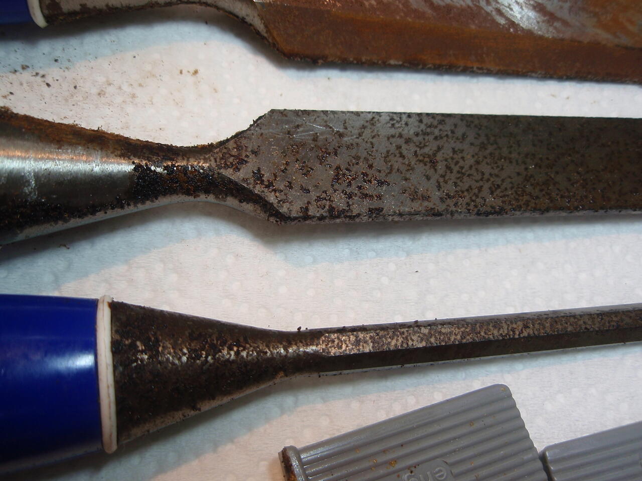

      So, three hours in Evaporust at 95°F and the ugly brown really rough stuff is all gone.
      There's gray splotches and spots where the brown was, that you can feel is slightly raised.
      What's the next step? Wire brush with dremel or a electric drill to see it it polishes up any ?
      Need some suggestions.

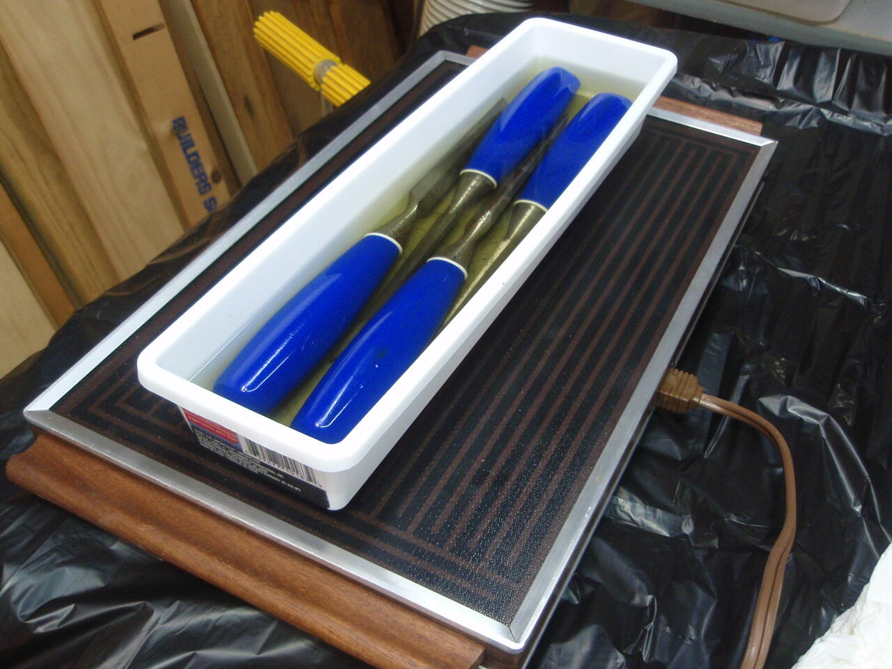

        3 hours later
        Before
        Click image for larger version  Name:	P1050590.JPG Views:	0 Size:	141.0 KB ID:	847264 Click image for larger version  Name:	P1050587.JPG Views:	0 Size:	180.2 KB ID:	847265
        After derusting in Evaporust 3 hours 95°F
        Click image for larger version  Name:	P1090625.JPG Views:	0 Size:	143.8 KB ID:	847266 Click image for larger version  Name:	P1090622.JPG Views:	0 Size:	154.1 KB ID:	847267

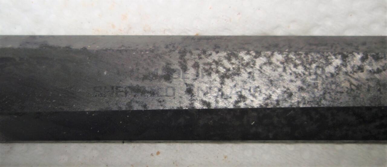

        Finally: Made in Sheffield England
        Click image for larger version  Name:	Made in Sheffield P1090616 cropenh.jpg Views:	0 Size:	60.6 KB ID:	847268
