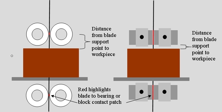

    There are a LOT of other considerations that have more import on how well the saw functions than the frame style, in my opinion. Guides for example: blocks versus bearings, which is better? Bearings have less friction but blocks can be positioned closer to the actual workpiece: The attachment shows a diagram I created recently as part of a bandsaw write-up I'm making for a couple friends of mine just starting out in woodworking.
    Click image for larger version  Name:	Bearings_versus_Blocks_Blade_Supports.jpg Views:	0 Size:	56.3 KB ID:	844272
    Bearings contact the sides of the blade at 1/2 their diameter while blocks are limited by the thickness of their mounting structure. Both styles have years of experience on different brands and both work well when properly adjusted. Laguna uses ceramic blocks on their well-respected bandsaws. Other brands - Agazzani and SCM - use bearings mounted sideways to grip the blade; the adjustment mechanisms are fine threaded shafts you turn by hand - similar to the Ryobi microadjuster for the BT's rip fence. They are really easy to use, not cheap, but really don't work well with the smallest bandsaw blades.

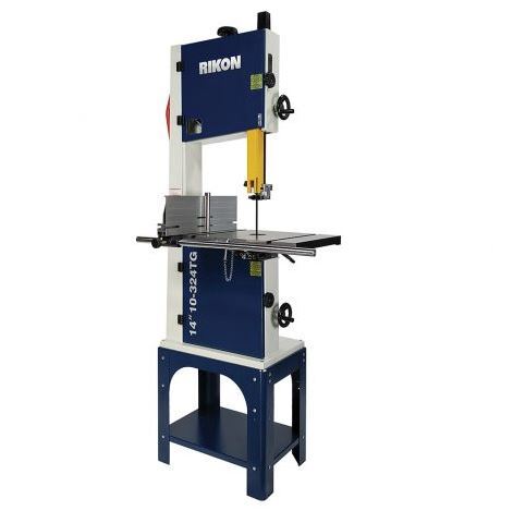

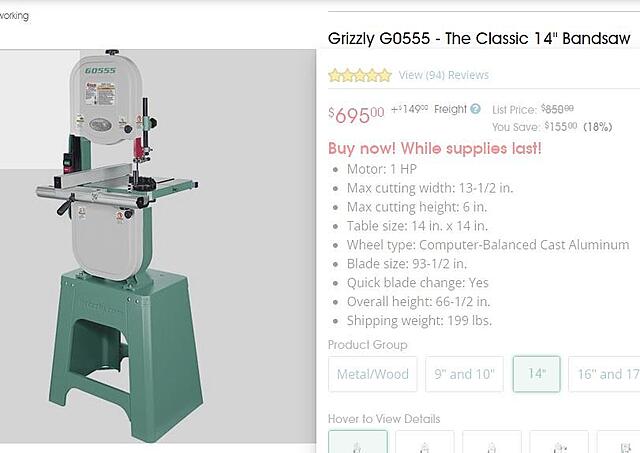

            If I were in the market for a bandsaw today (I haven't looked for 15 years)
            probably be down to GO555 vs Rikon 10-324 14" with maybe a quick look to see if I could swing a 17" saw.
            https://www.grizzly.com/products/gri...-bandsaw/g0555
            Click image for larger version  Name:	GO-555 bandsaw.JPG Views:	0 Size:	41.6 KB ID:	846491
            https://www.rockler.com/rikon-10-324...s-blade-guides $1199
            Click image for larger version  Name:	Rikon 10-324.JPG Views:	0 Size:	14.5 KB ID:	846492

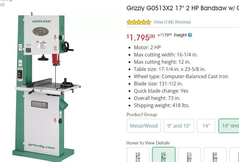

            https://www.grizzly.com/products/gri...unnion/g0513x2
            Click image for larger version  Name:	GO-513 bandsaw.JPG Views:	0 Size:	51.4 KB ID:	846493
            Sigh.... I feel like I am going to be using my 12" Delta for a long time.

              Current SALE pricing on the G0555 is $695.00 + $149.00 shipping.
