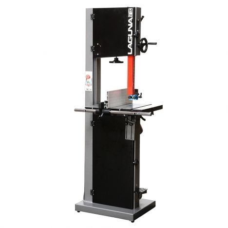

                      Increasing threshold? Considered Laguna? Just a little more.
                      Click image for larger version  Name:	55642-01-1000.jpg Views:	0 Size:	12.9 KB ID:	844264
                      Like the Ferrari of Bandsaws, Italian in origin.
                      https://lagunatools.com/classic/bandsaws/
                      https://www.rockler.com/laguna-14bx-...2b%3A1&linkID=

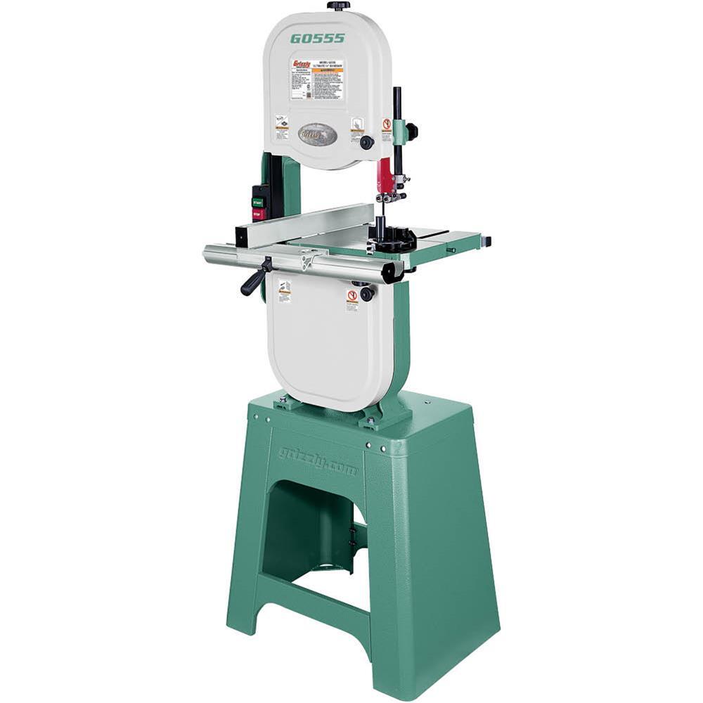

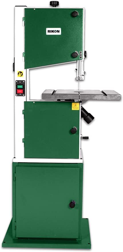

                            What the pros and cons of so called cast Iron BS (Delta, Grizz 0555, HF) vs European Sheet metal saws. (Rikon, Laguna etc)?
                            I know the cast iron ones can have their height extended by 6" with a riser block whereas Euro style saws are fixed cutting height (but usually start a little larger vertical capacity ) out of the box.
                            Cast iron:
                            Click image for larger version  Name:	G0555-t.jpg Views:	0 Size:	38.7 KB ID:	844268
                            Euro-style:
                            Click image for larger version  Name:	71qKfHfkYgL._AC_SY879_.jpg Views:	0 Size:	24.4 KB ID:	844269Click image for larger version
