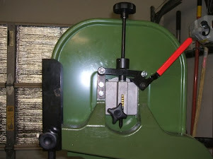

              Okay boys and girls, the tension release, cool blocks, and Cobra Coil are done.
              All the pieces and parts for the upgrade.
              The set of cool blocks in the OEM blade guide assemblies replaces the aftermarket Accura blade guide assemblies. The Accuras were nice, but were a pain to reset every time I swapped blades.
              The completed tension release assembly in the released position.
              The completed tension release assembly in the tensioned position.
              The tension release assembly was pretty straight forward just following the originally linked Photo HOWTO and using the Grizzly parts list as a guide as to how it should go together.
              The hardest part of the entire process was adjusting it once it went together...
              One step that I feel is VERY important that the originator of this mod did not mention in the tutorial, is that once you find the centers of where you want your holes, you really MUST center punch the spot you want your bit to drill to prevent the drill bit from skating on you.

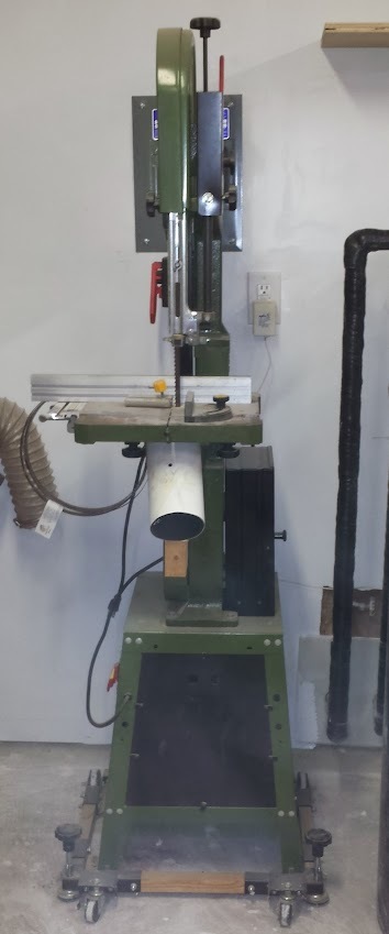

                            So I am I think 14 years into owning this band saw, and I think until the motor dies, I am DONE with modding it. Let me list fo the mods and agree or disagree you at least have an idea of what I put into my saw to get it where I am totally happy with it...
                            1. AccuLink belts replaced the OEM belts. The OE belts had a distinct hump to them that made the saw vibrate a LOT, these smoothed it out. Same thing with my drill press.
                            2. Central Machinery riser block kit. Good luck finding one these days they have been out of production at least 7 or 8 years...
                            3. Timberwolf blades, various sizs, not sure if tehse count as mods, but LOVE these blades...
                            4. Grizzly G0555 tension release mechanism. As detailed above.
                            5. Carter Cobra Coil tension sprint replaced the floppy OE tension spring.
                            6. Harbor Freight, whatever brand they call them, mobile base.
                            7. Rustoleum Hunter green paint for the base. Overexposure to a blow out on the water softener killed the OE finish on the base...
                            8. Accura Roller bearing blade guides. The accura upper guide holder does NOT fit the Central Machinery with its micro adjuster, BUT... the yoke for the bearings fits the Central Machinery part, so I swapped yokes and installed the rest and boy does it work great!
                            9. Jet 2.5" dust port in place of the OEM port.
                            10. 2.5" dust port in the lower wheel guard.
                            11. Carter wheel brush.
                            12. Urethane tires replace the OEM tires.
                            13. Rust removal and table polished via 320 sandpaper and WD40.
                            14. MLCS on the post relocated safety style on / off switch replaced teh factory switch that I have apparently been bothered by for at least 14 years...
                            15. And finally today, the Kreg Precision Bandsaw fence.
                            Once the motor has cut its last curve, or resawn its last bit of lumber, I am planning on upgrading to a higher quality 1.5HP model. Not sure of the brand, was leaning toward Dayton so many years ago, but there are so many good ones now I am not sure...
                            Early riser block, blades, tension mechanism installed, early attempt at upgrading dust collection tried, and jetissoned.
                            The tension release mechanism installed and in the detensioned position. I have since added tension / detension labels to allow me to see at a glance the status.
                            THe Hunter Green paint is on the other side of the stand, you can see the dust ports, kind of as well as the switch and of course the fence. I guess I could have used a better hunk of cable than an extension cord, but it was the right gauge, and it worked...
                            So that should in theory be the endo fthe Band Saw hot rodding saga that is way too many years in teh making, funny how life gets in the way sometimes.
