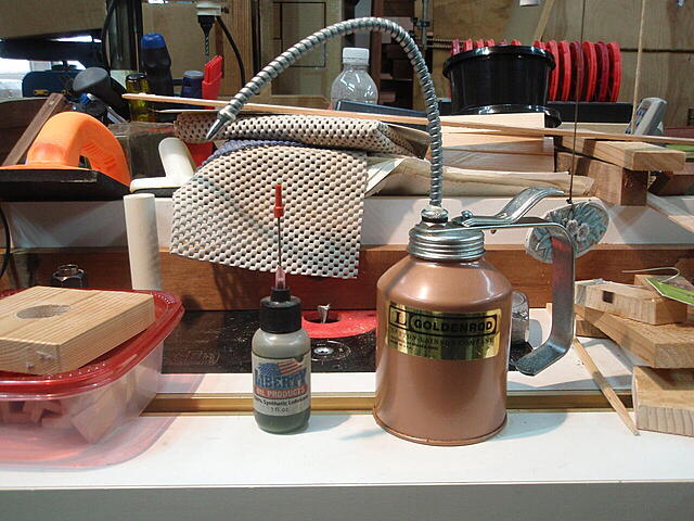

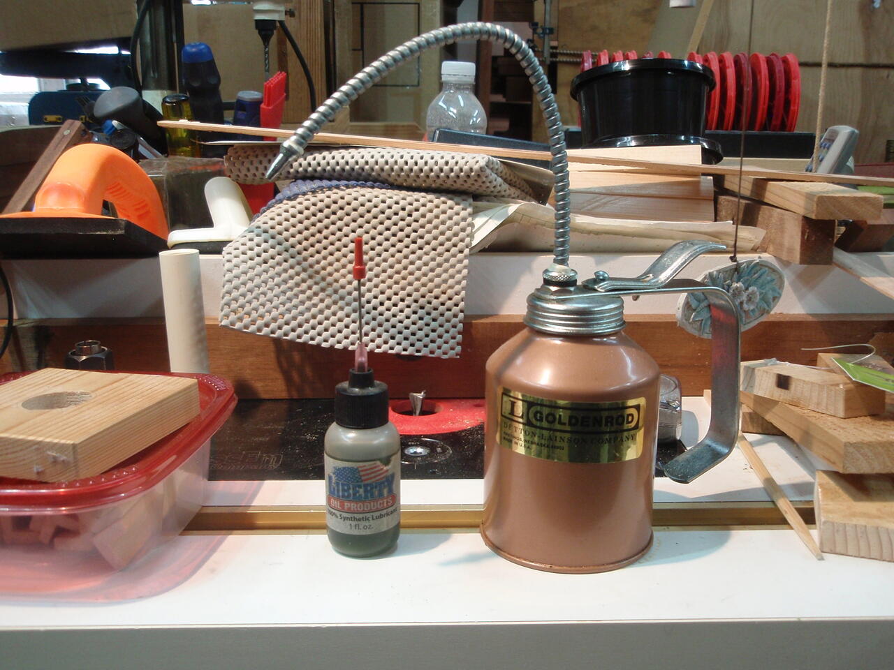

          Here are the two oilers I use now:
          Click image for larger version  Name:	fetch?id=838498&d=1580063863.jpg Views:	0 Size:	24.7 KB ID:	843772
          Click image for larger version  Name:	P4170327.JPG Views:	0 Size:	174.4 KB ID:	843771
          The gooseneck (12 oz, not a pint) pumps a big squirt of oil. It leaves a oil ring on the table when I set it down... seepage? Leaking? But it is good for lubing hard to get to bearings on big machinery.

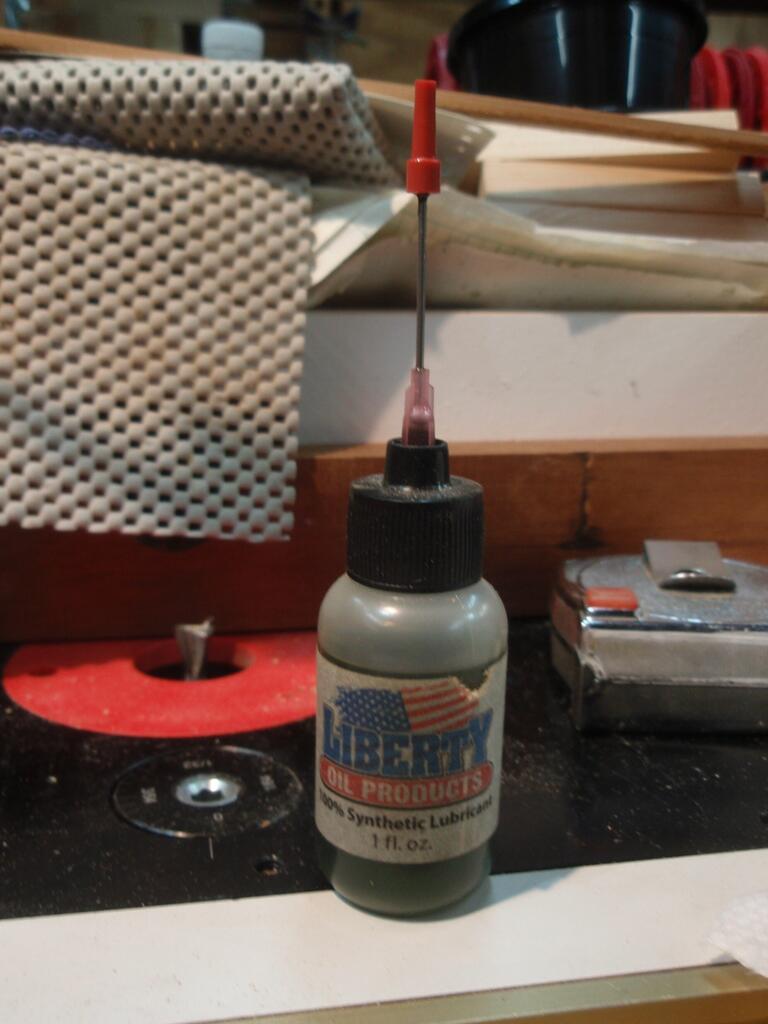

          The little bottle of liberty oil is great for precision applications - the long needle applicator and plastic squeeze bottle allow precise application of both volume and location.
          Both I think I got at Amazon; the big one comes dry. the little one with oil.
          I have a can of 3-in-one oil I used to fill the gooseneck oiler and sometimes use it too. Short reach but more precise control than the gooseneck.
