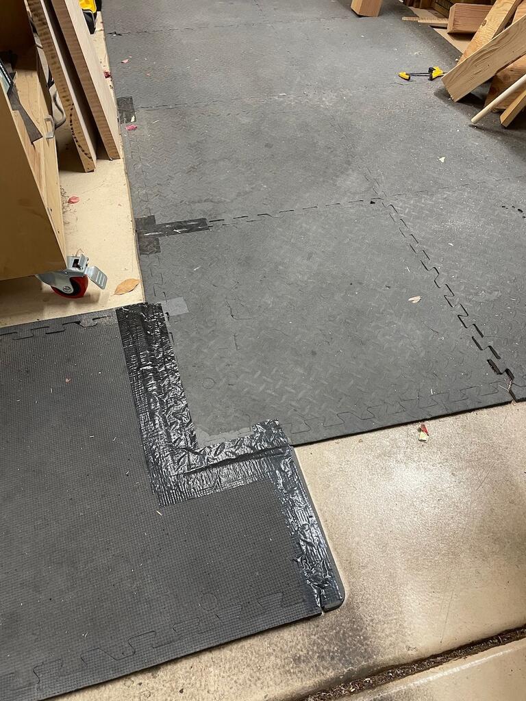

                            I have my entire shop covered in foam mats, and would never consider having hard floors without them. I don't sweep, I vacuum sometimes but mostly just use a blower to blow it all out. Works fine. They are HF mats I've had for at least 15 years and still doing just fine. About indestructible. The only minor annoyances are edges and edge strips separating, I just use black duck or gaffer tape as needed (they are different things, and yes "duck" is correct not "duct").
