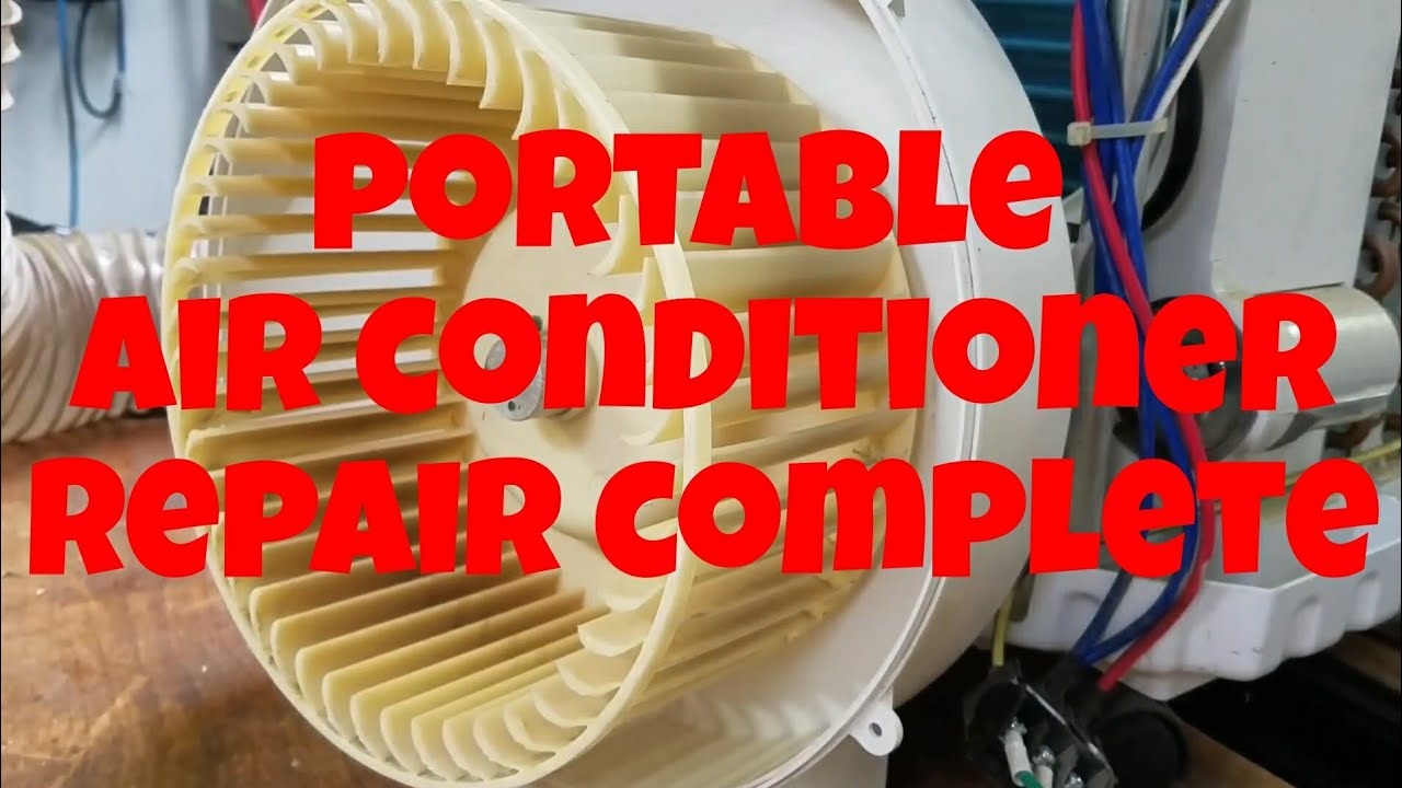

    It took far too long to get it done but the portable AC is working great. Got the fan blade glue back together everything lined up right everything tight the way it's supposed to be INRI assembled and tested it doesn't cool down as fast as I would like but it never did.
    Very happy that I don't have to scrap this piece of equipment at least yet. If I had it to do all over again there is no way I would do a portable unit. I would either boxing and duct a window unit or budget would permit I would use a ductless split system.
    https://youtu.be/2FPE54-5PCU
    Okay folks, here is the report for the day. Temps were into the lower 80s in the Clear Lake area yesterday, and rain, rain all day, so it was HUMID.
    I got home from work, the shop wall thermometer read 85 deg F, no clue what the RH was, but it was nasty sticky. I kicked the A.C. on at 5:45 P.M. and took the wife to the grocery store as we ran out of potatoes and bacon for a recipe we were going to work on (Bratkartoffeln mit Kraut). I left he AC on and ran out for about an hour and a half. I set the T-stat for 65 just wanting to see what the unit would do.
    When we came back, I realized the air by the unit was cold, the air by the bench, and miter saw bench was still stifling, so I turned on the air mover fan hung in front and above the AC from the ladder. (Odd rig, but it works). Went back into the house to work on dinner, came back out 20 minutes later.
    So 1 hour and 55 minutes after starting the unit up, the garage was COLD. The thermostat had shut the compressor off and I was simply running on fan at that point. the wall thermostat read 67 deg F on the other side of the shop from the AC unit.
    Assuming I remember to turn on the air mover fan at the same time, I expect, of course assuming this dumb thing doesn't try to grenade itself again at some point this summer, but I expect this to be sufficient for my shop through the summer, and given any luck in the matter, it should last a few more years, but I need to start planning, and budgeting.
