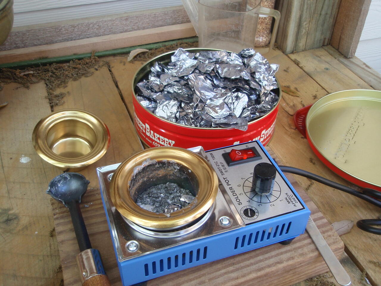

want to cast some lead fishing weights with wooden molds
    • 22060
    I guess a 3D printed mold won't work too well with molten lead...
    There are some people making lead casting molds of wood.
    I have a solder pot, some surplus lead. and some wood.

        I got a tiny ladle made for bullets.
        The sinker molds are 50-60 bucks and I'd have to buy two for the sizes I go through a lot.
        I'm thinking about a mold extension to make two sizes with one mold set, convertible.
        If the wooden ones work I will buy some aluminum bar stock and make some permanent ones. I am imagining the wood ones will char and wear out after some use.
        The economics is poor, lead weights are getting expensive but this is probably an exercise to see it I can do it. So far a $20 pot and a $12 ladle.
        But I recently spent $20 bucks for 50 lead weights on eBay.

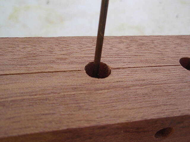

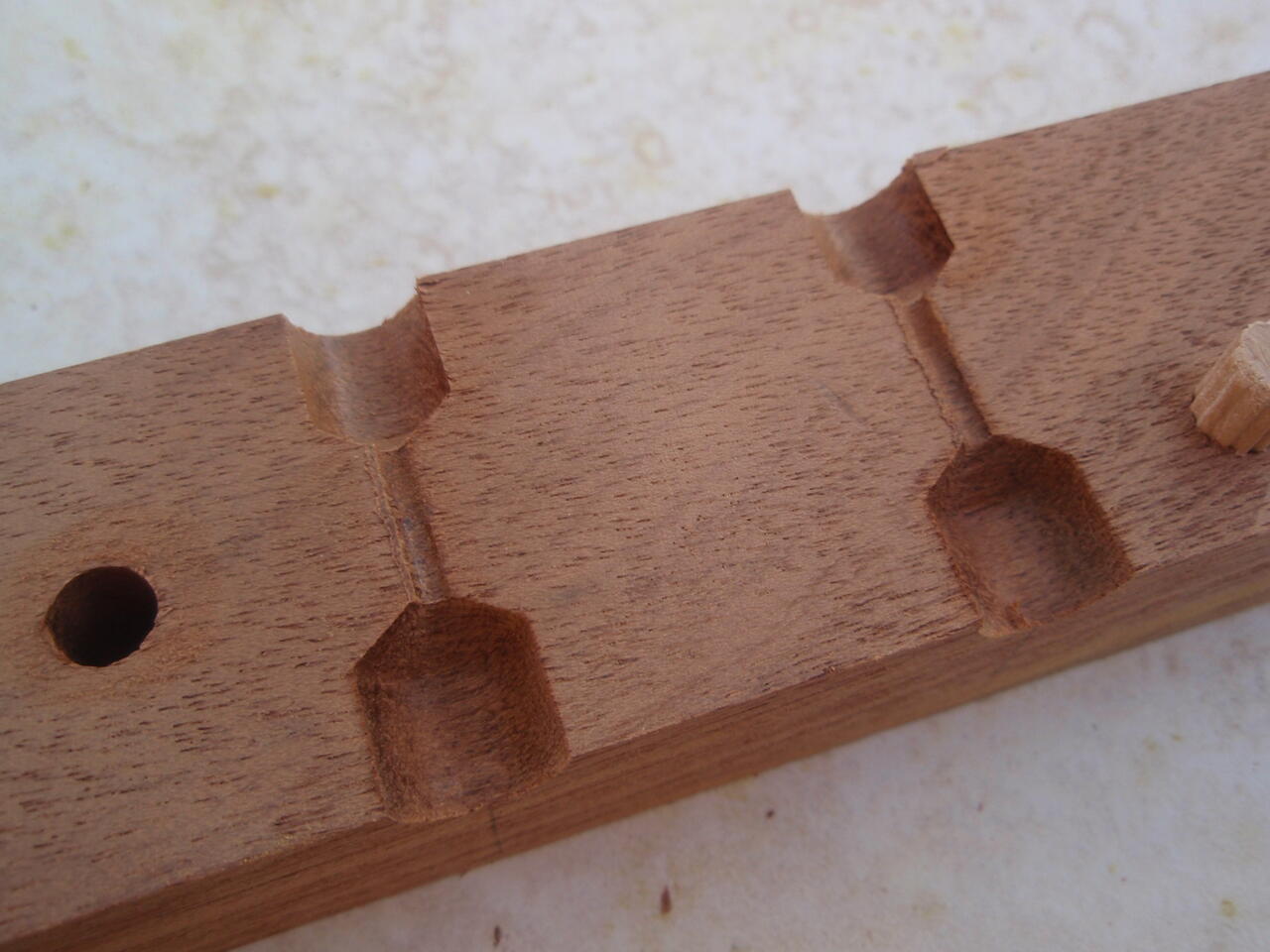

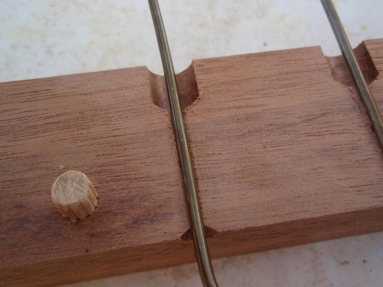

            • 22060

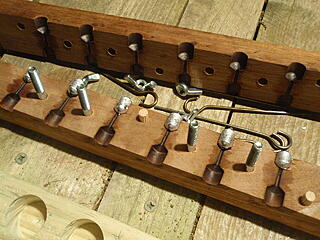

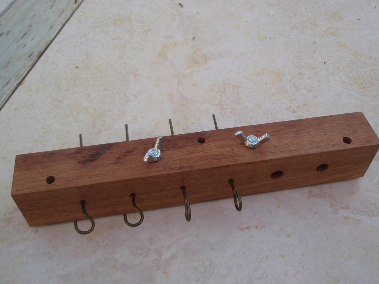

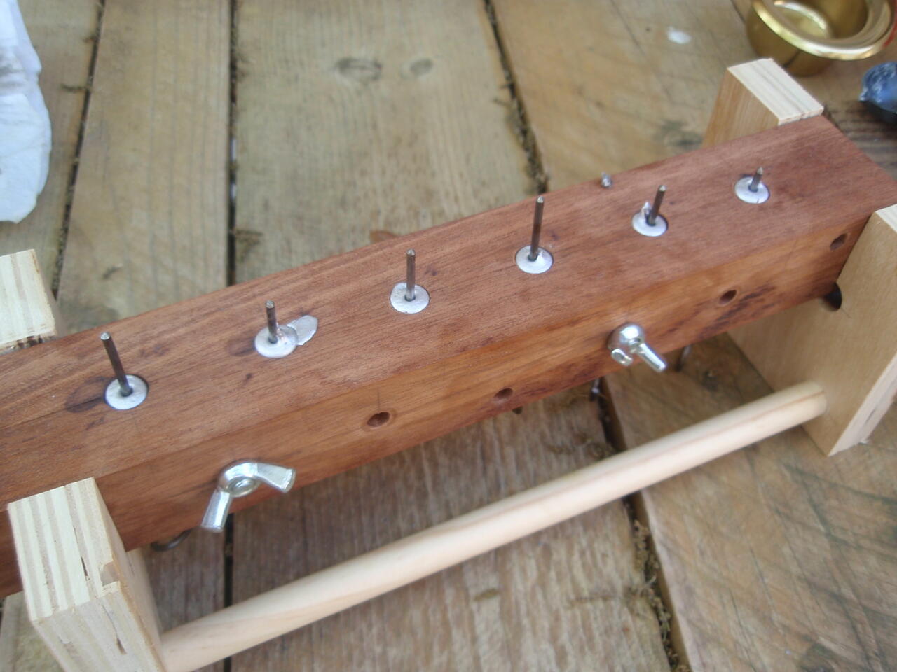

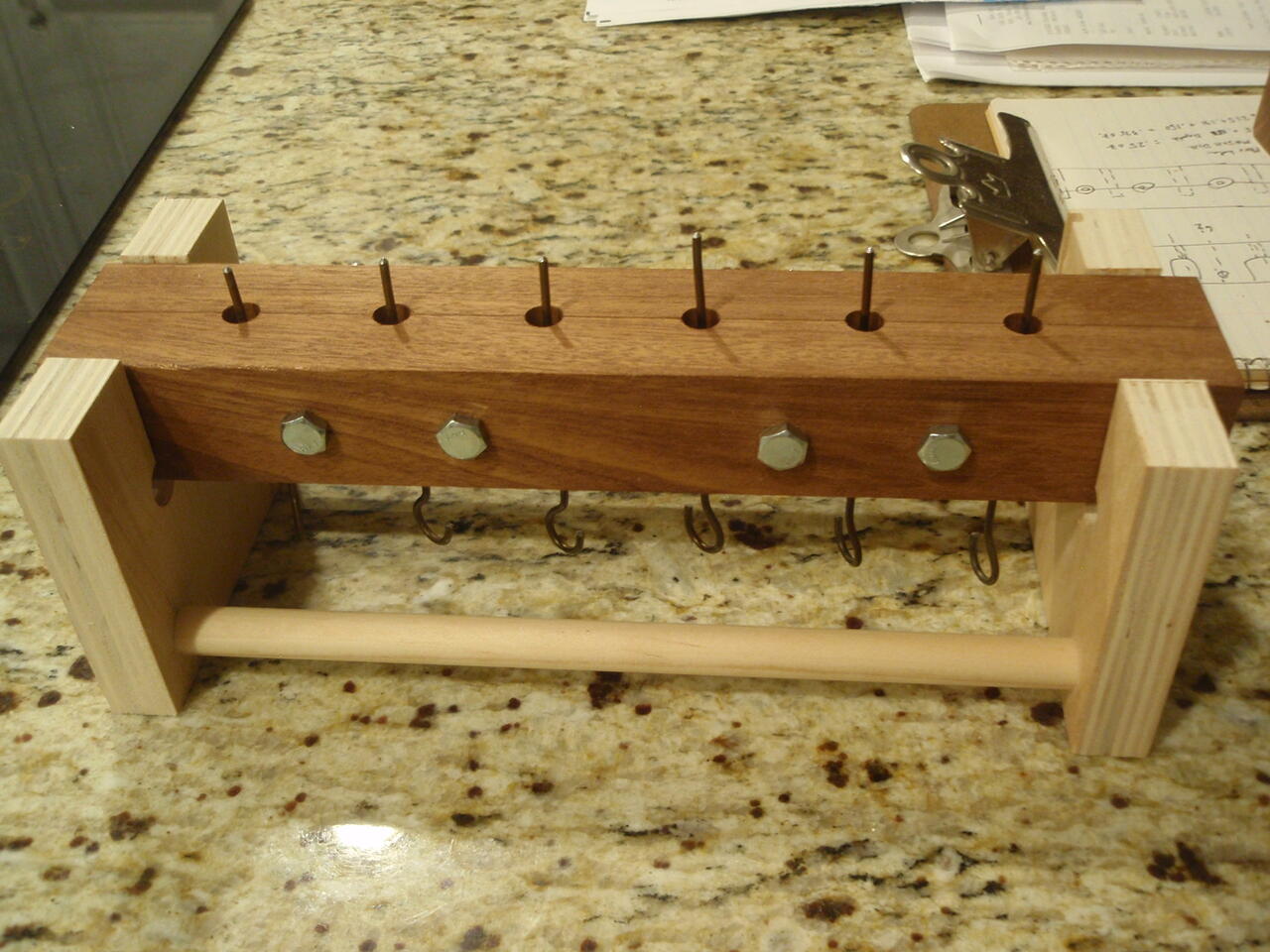

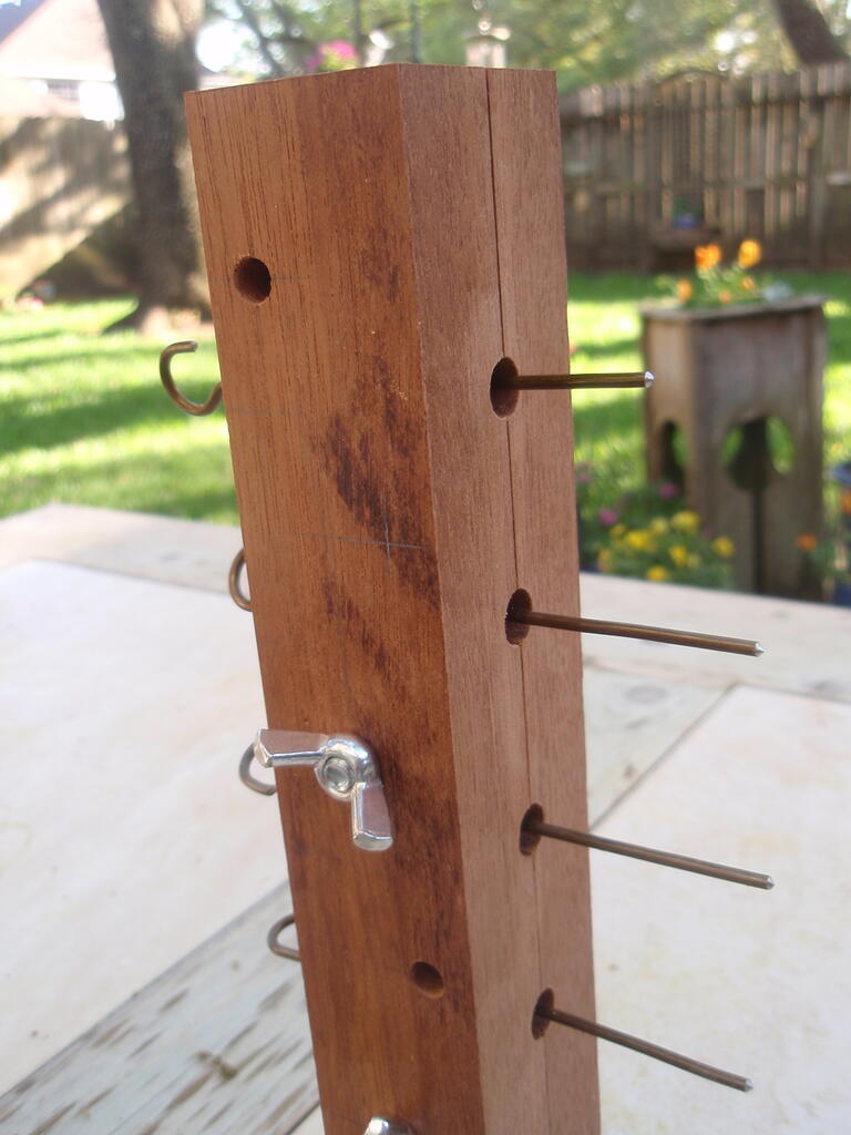

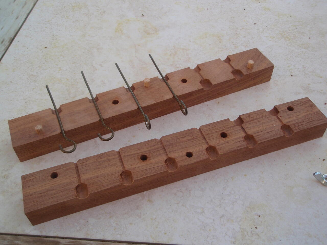

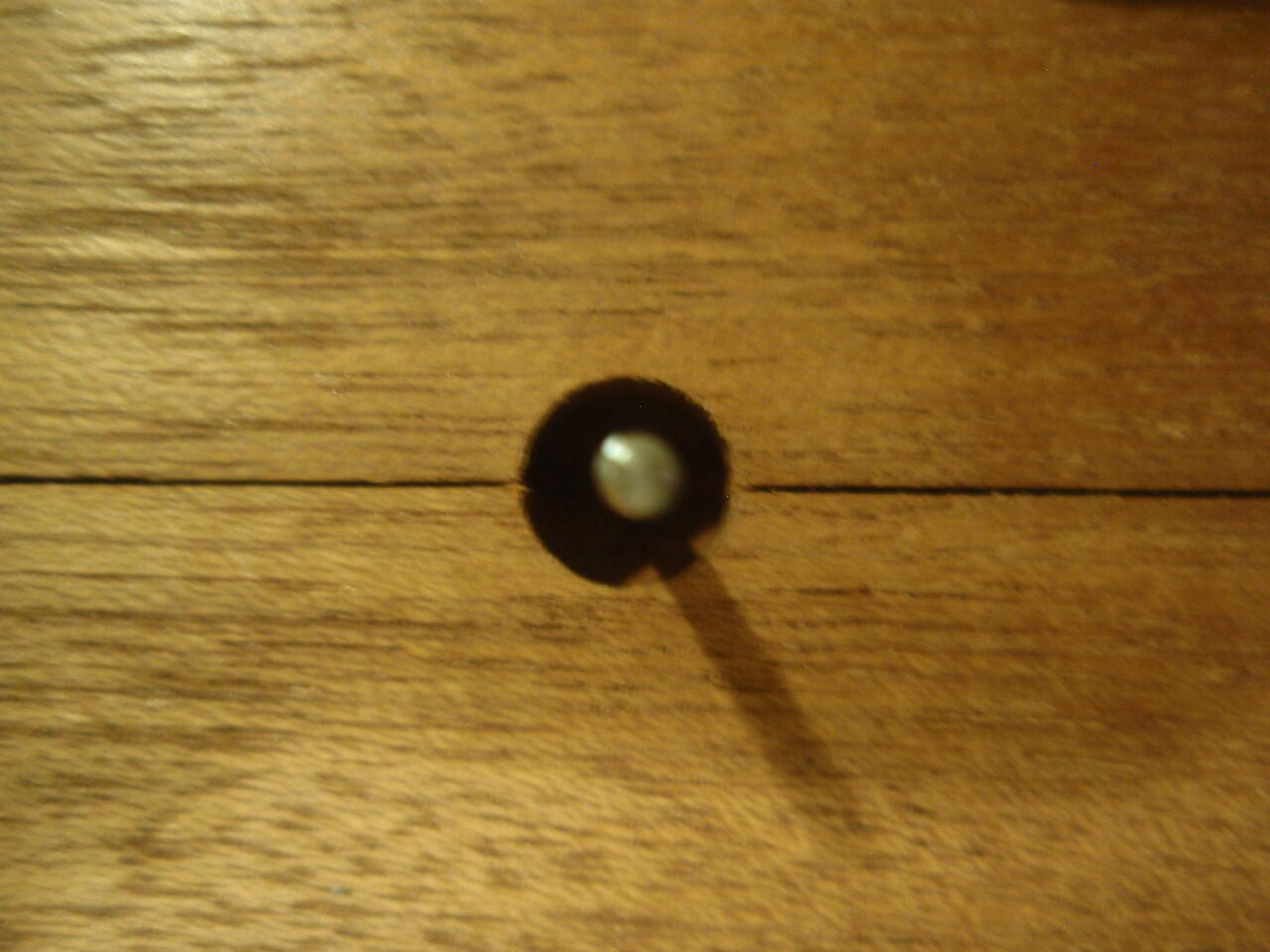

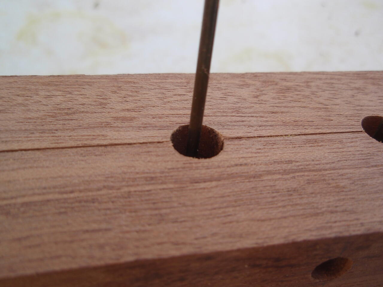

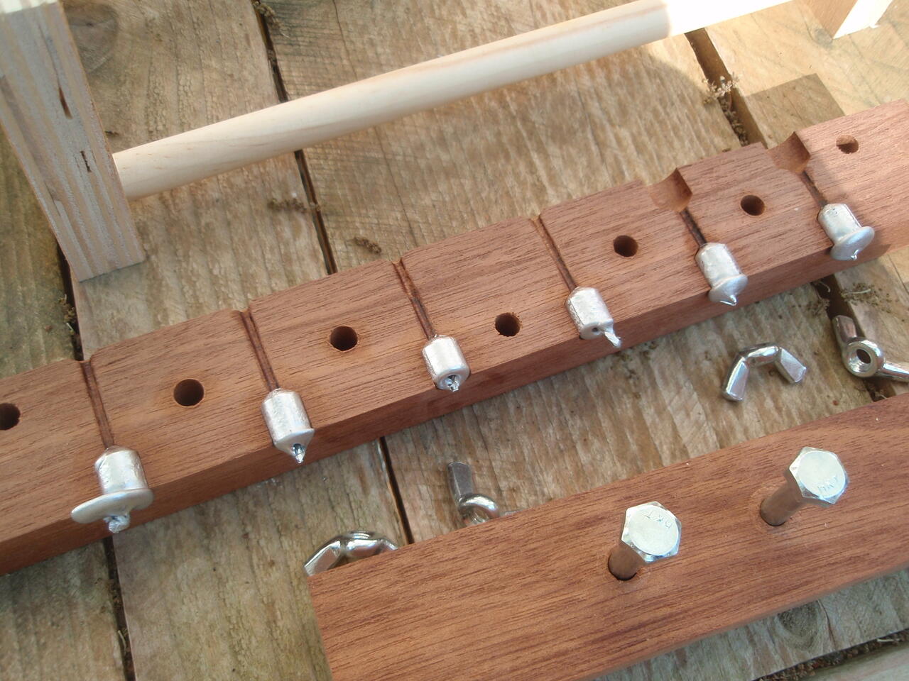

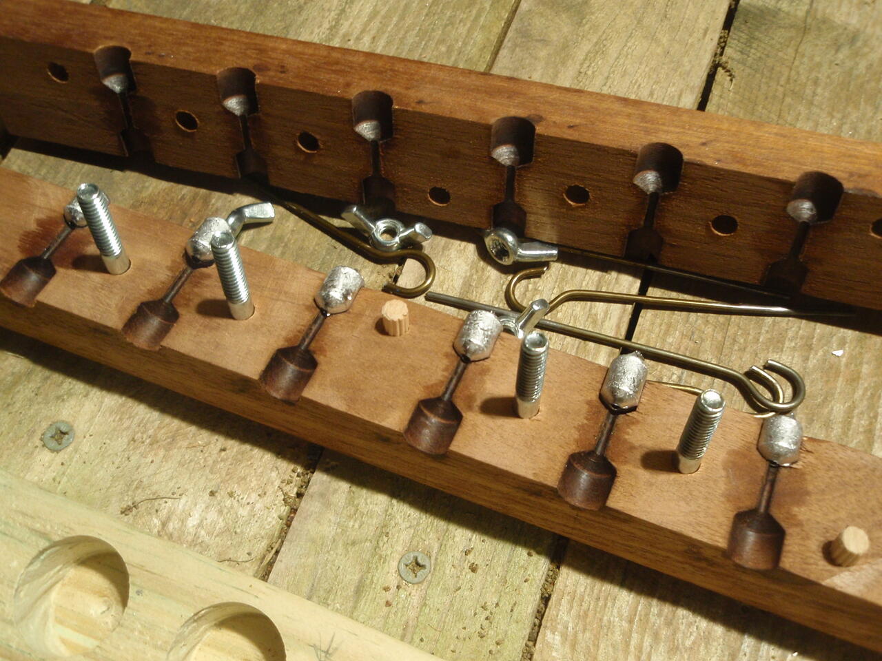

            Progress
            Double mold with 6 cavities on each side. (not all the cavities drilled on one side.
            one side up is for the smaller sinker. Turn it over and the cavities on the other side are for the next larger size.
            Draw wire makes the hole through the sinker.
            Probably needs two more clamping bolts before I use it.
            I hope my volume/density calculations are correct! Yes I accounted for the hole material loss.
            Click image for larger version  Name:	P3131159.jpg Views:	0 Size:	79.1 KB ID:	854523 Click image for larger version  Name:	P3131158.jpg Views:	0 Size:	94.4 KB ID:	854524 Click image for larger version  Name:	P3131156.jpg Views:	0 Size:	90.2 KB ID:	854525 Click image for larger version  Name:	P3131154.jpg Views:	0 Size:	109.3 KB ID:	854526 Click image for larger version  Name:	P3131153.jpg Views:	0 Size:	121.5 KB ID:	854527 Click image for larger version  Name:	P3131152.jpg Views:	0 Size:	117.6 KB ID:	854528 Click image for larger version  Name:	P3131157.jpg Views:	0 Size:	98.0 KB ID:	854529

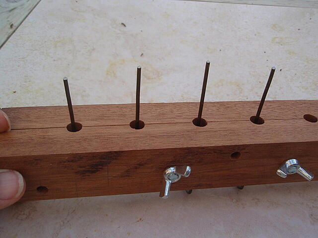

              • 22060

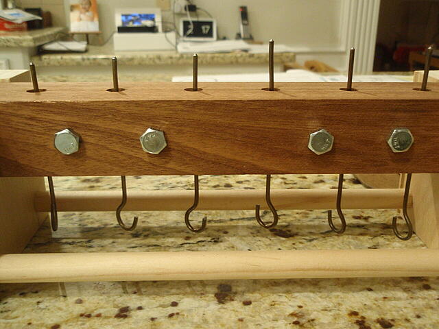

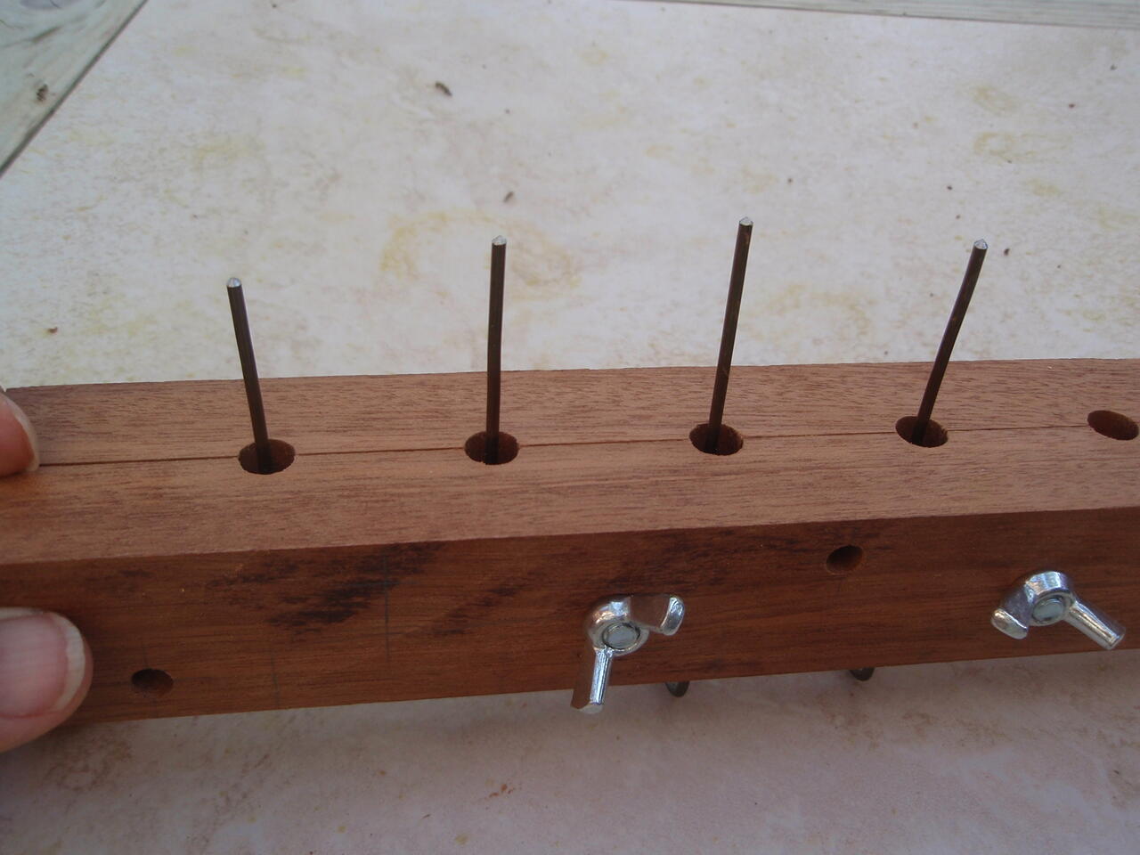

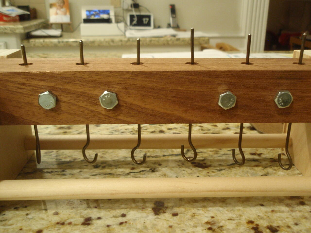

              All done. need to oil the draw wires so they come out easier (I hope) and get the lead and melt it during daylight tomorrow.

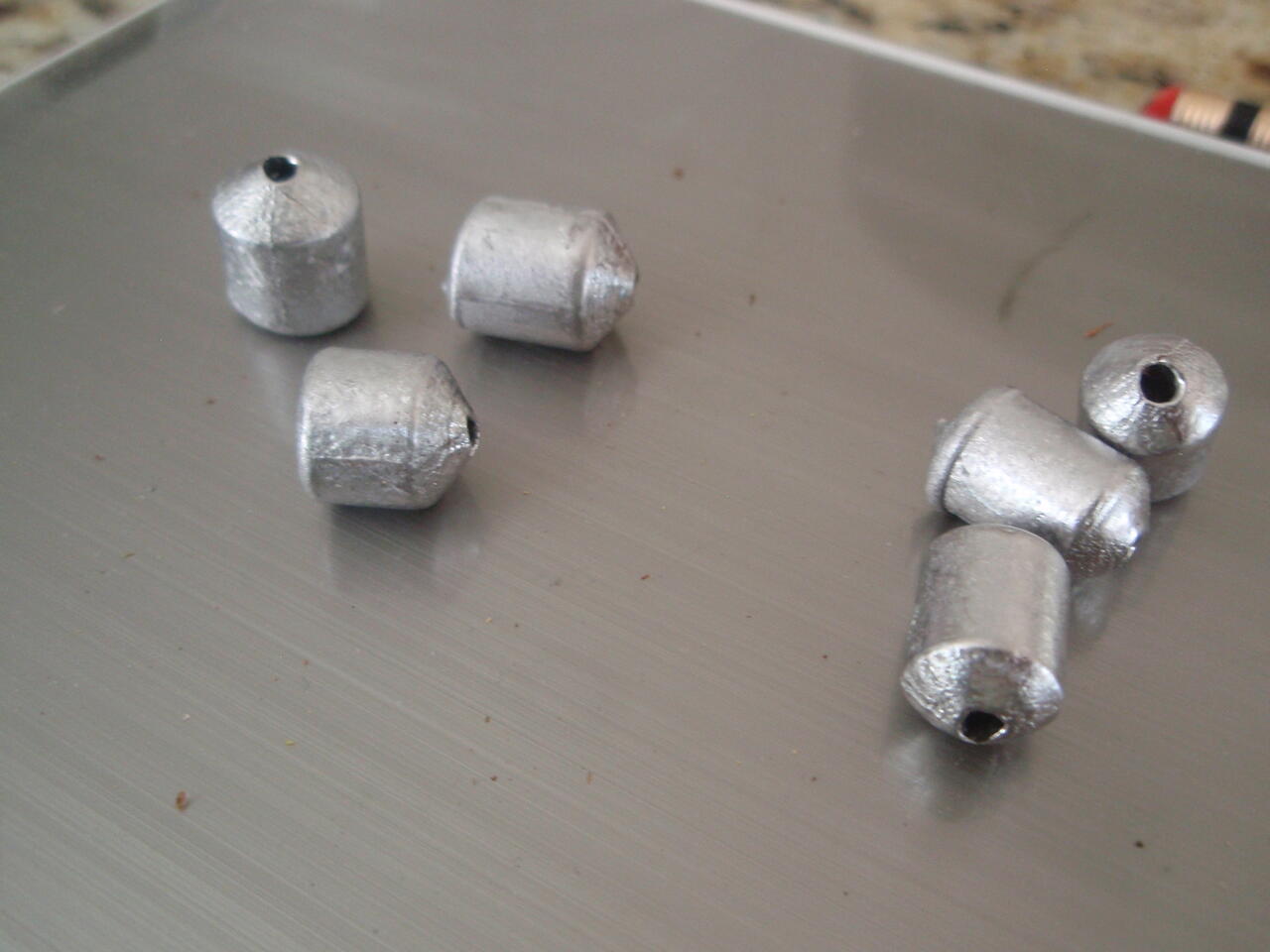

                  • 22060

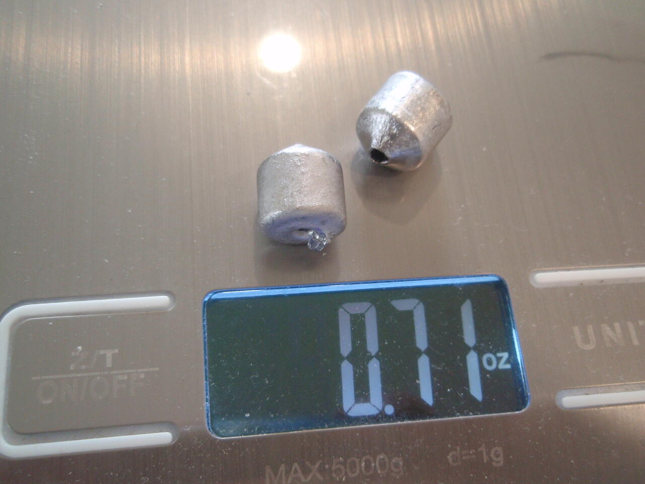

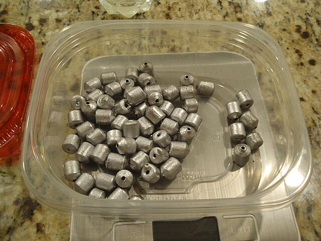

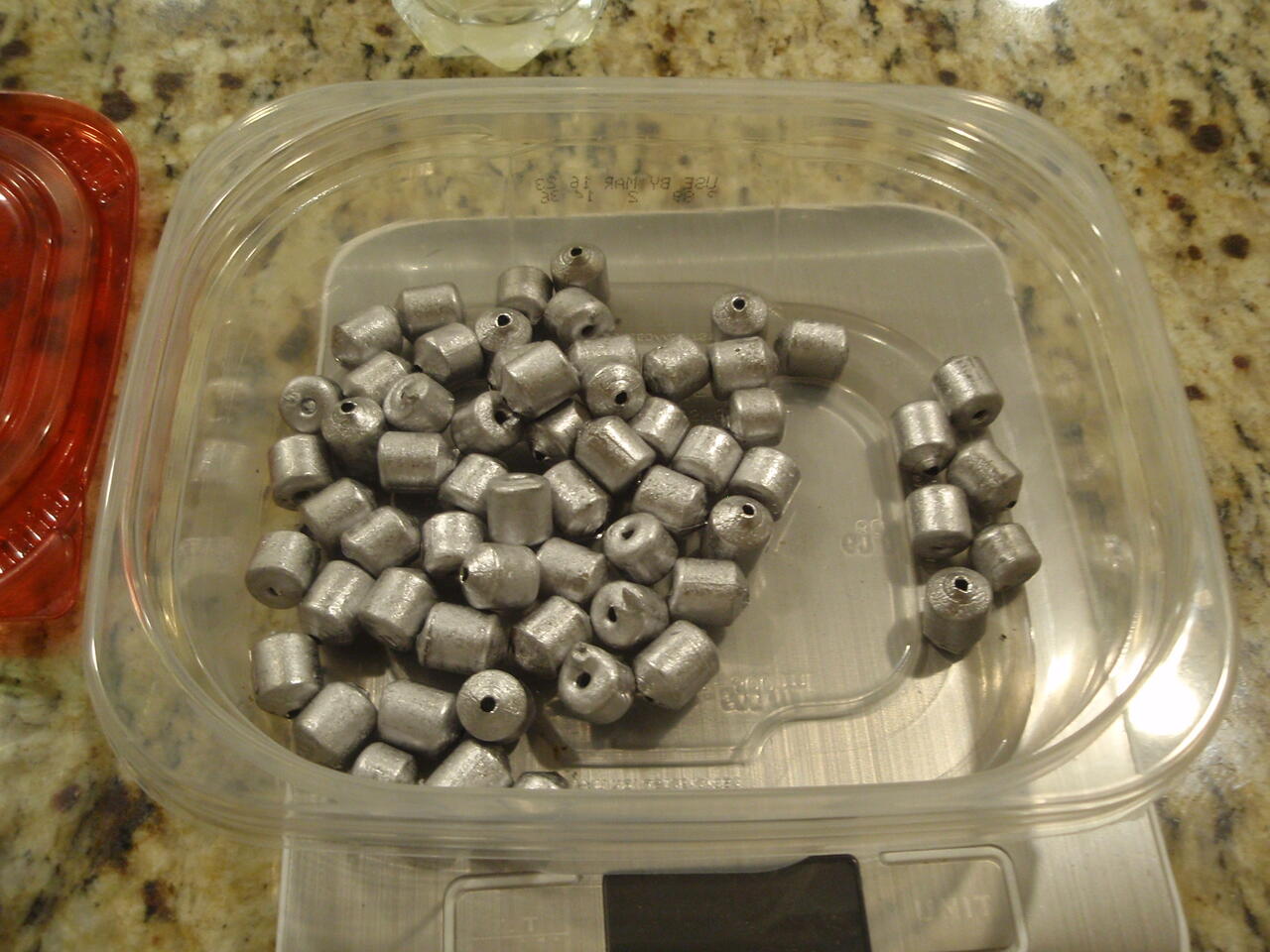

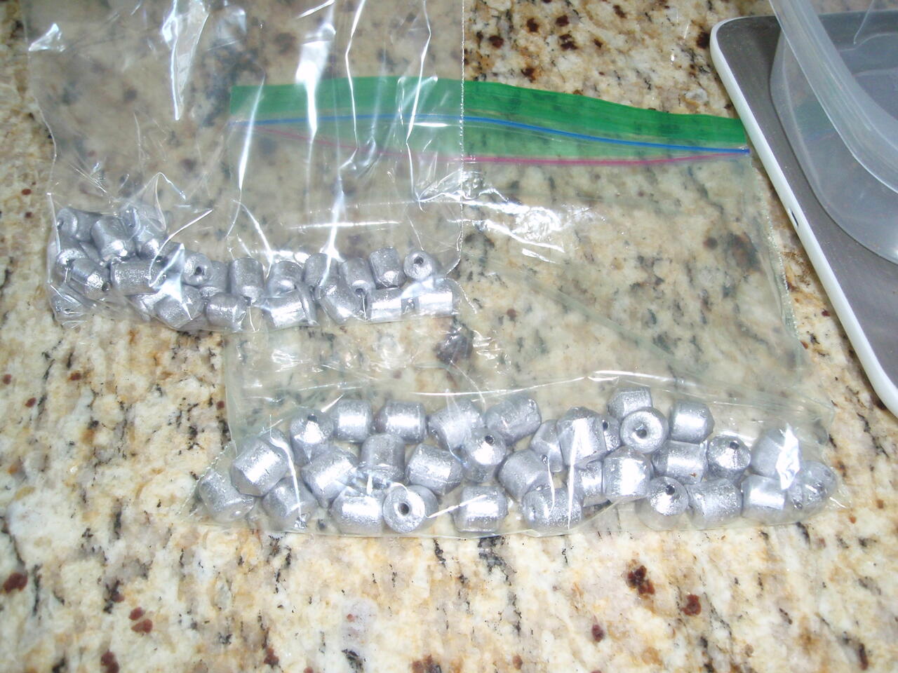

                  Success! Cast about 60 this afternoon. 2 sizes. The 1/4 oz averaged about 0.28 Oz and the 3/8 oz averaged 0.37 Oz. So it came out pretty close. Since the cavity is an open end I have to control the pour to the top of the cavity or else I get a mushroom top and a bit overweight.
                  Overall I was pleased with the clean smooth finish of the weights showing just a hint of the seam and no wood grain.
                  The lead came from a dentist friend of mine. they are the backing for the bite-wing x-ray films. They save them when they develop the x-rays. Surprisingly the foil has a lot of air fluff. You can see I used a fruit cake tin of lead foil, it only fills the little solder pot shown about 1/3 full. I think it took more than 2 full tins of lead foil to make 60 weights.
                  This was mostly curiousity to see if I could do it cheap. Ladle $12 (very important to control the pour on small weights) Solder pot $21 Lead free, wood free. misc bolts and nuts $4 but I keep a stock of them.
                  I think fishing weights are getting costly. I think I get like five 3/8 oz for $3 at the local sporting goods store. Running 40, 50 or 60 cents apiece. And you lose a lot of terminal tackle fishing on the Jetties due to snags..
                  Pouring is not too hard once you get the hang of it. I trim a little pour flash or a mushroomed end with some wirecutters and let it fall into the pot.

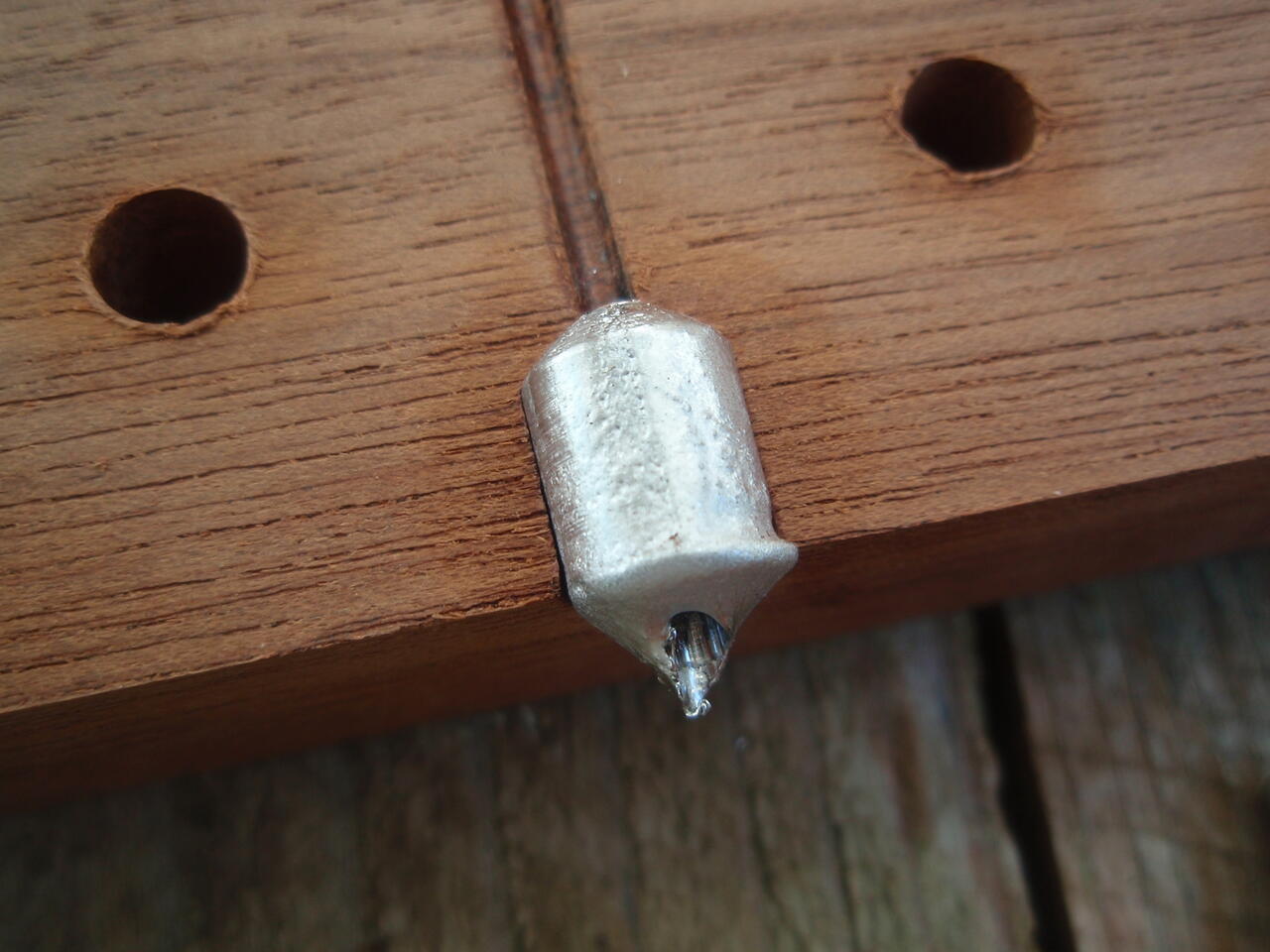

                  The hard part is withdrawing the pull wire from each sinker. I used steel coat hanger wire of 0.088 dia, Its hard to pull free of the lead. I have to clamp the mold down to the table. I use a T-handle on the pull wire loop I fashioned with the wire bending jig. And I oil the pull wire before each use. Its fairly laborious. Once the wires are extracted I loosen the mold clamping screws and the sinkers mostly fall free.
                  I wish I knew how to make the wires easier to release, that is so they don't stick to the lead for the .5" of engagement in the sinker. Needs a non stick coating I can apply at home that can stand 350 °C.

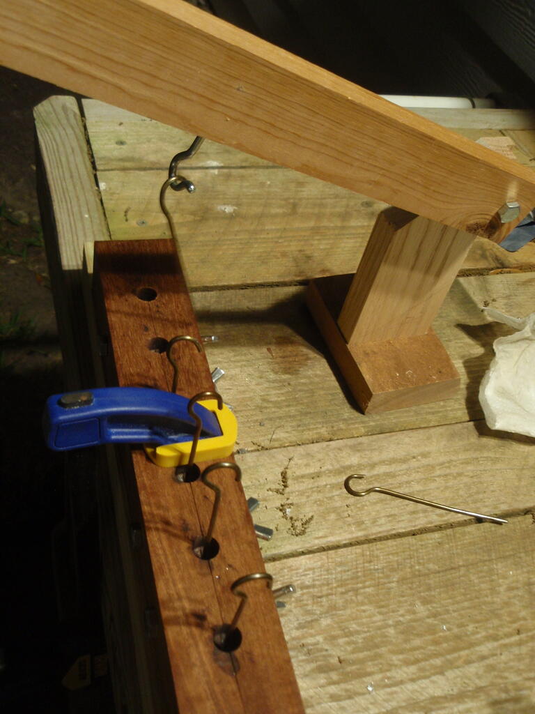

                      • 22060

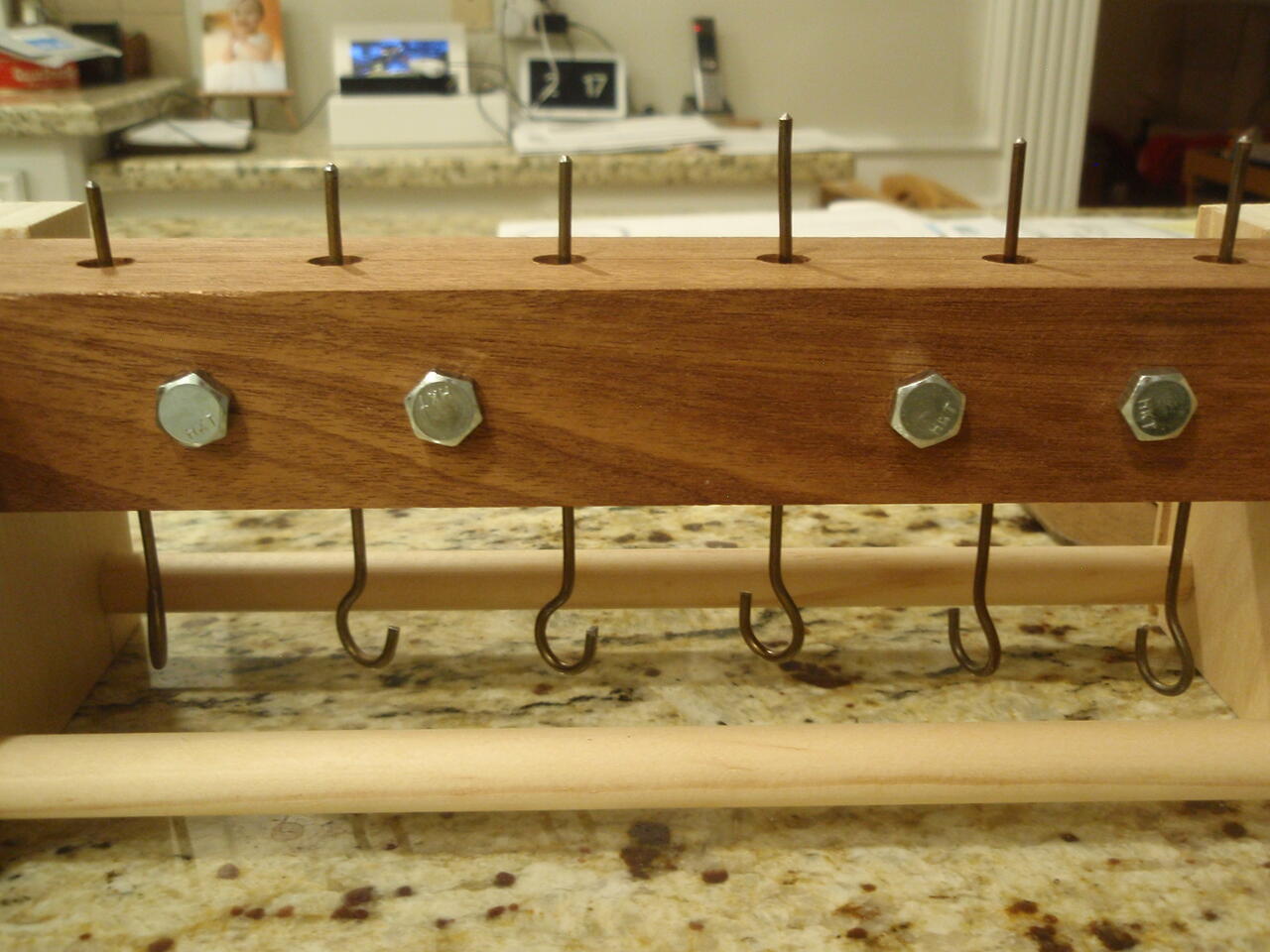

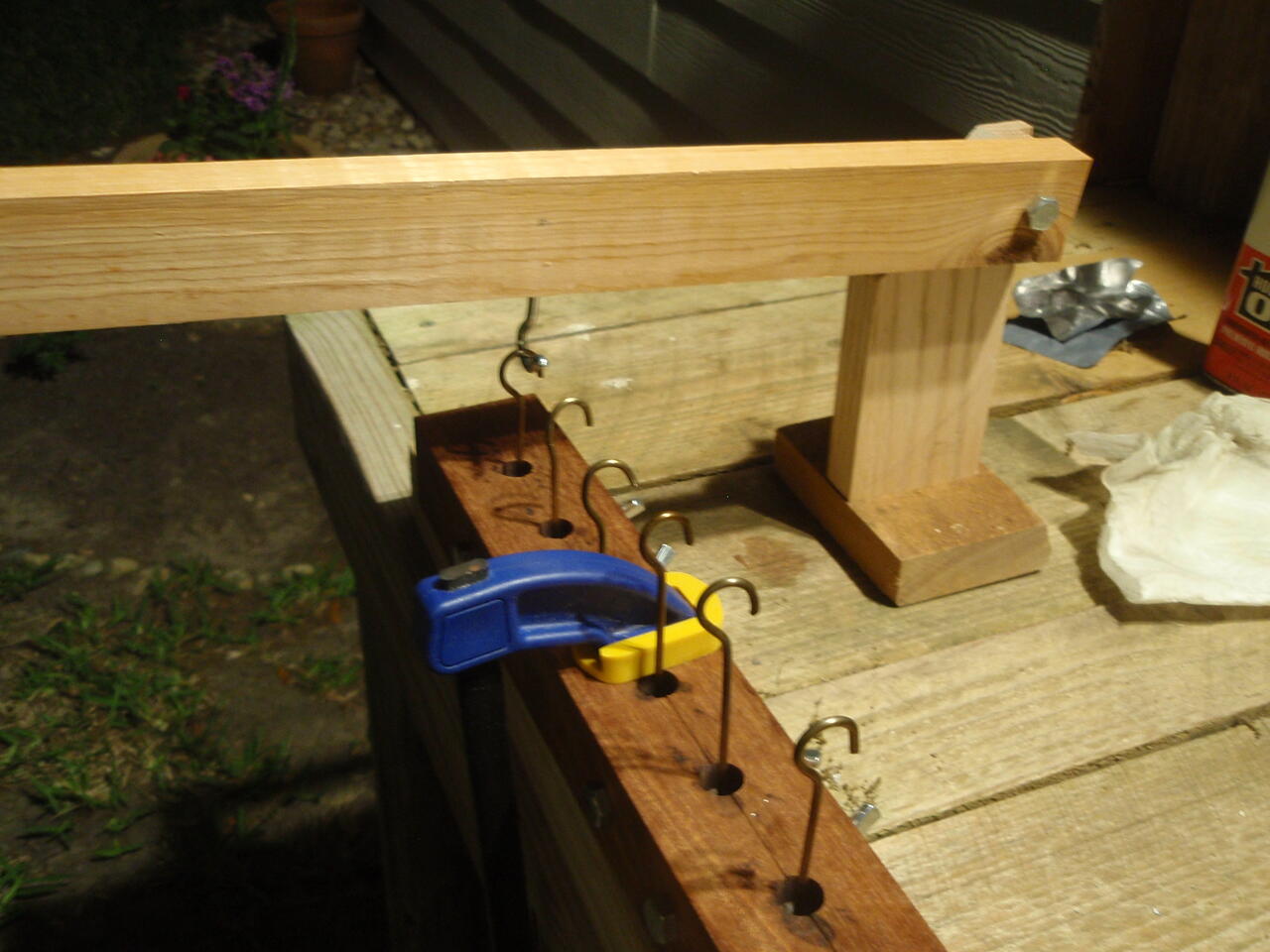

                      OK solved the pull wire problem.
                      First, oiling the wires each use makes them come out a little easier, but still takes a fair amount of force.
                      Click image for larger version  Name:	P3151183.jpg Views:	0 Size:	79.8 KB ID:	854607
                      Them I clamped the mold to the table and built an overhead lever arm that gave me about a 4:1 advantage. This worked great. And saved a lot of time and physical aggravation because I struggled to get them out without the lever arm. I lifted the left side of the lever with the fulcrum over the table and it came out slowly with a reasonable and controllable force instead of pulling as hard as I could and then having it yield suddenly and unpredictably..
                      Click image for larger version  Name:	P3151181.jpg Views:	0 Size:	122.4 KB ID:	854606
                      Click image for larger version  Name:	P3151182.jpg Views:	0 Size:	95.2 KB ID:	854608
                      I made about 130 sinkers today after I got the process tuned and the wire extraction working.
