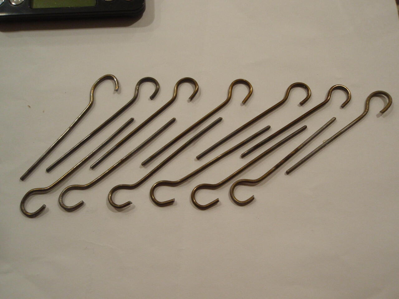

    Figuring out how to machine a molding jig in the right order and incorporate the pull wires and have everything accurately aligned was fun and informative.

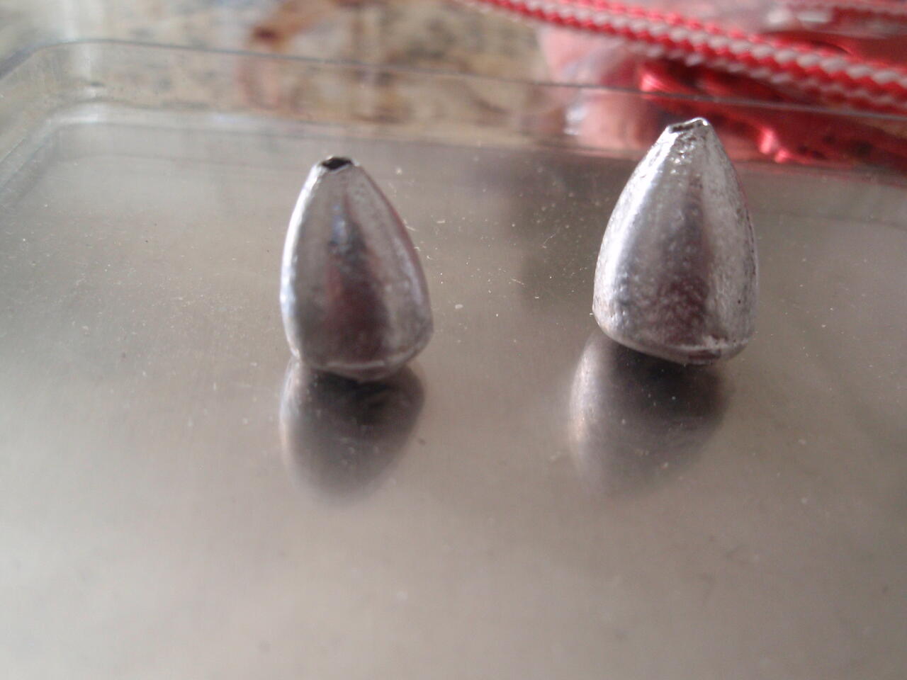

      One last thing, I found a spade shaped bit set intended for masonry I decided would make some cast bullet shaped weights (see post #9 in this thread for picture of commercial bullet weight).

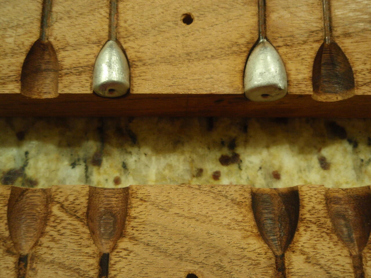

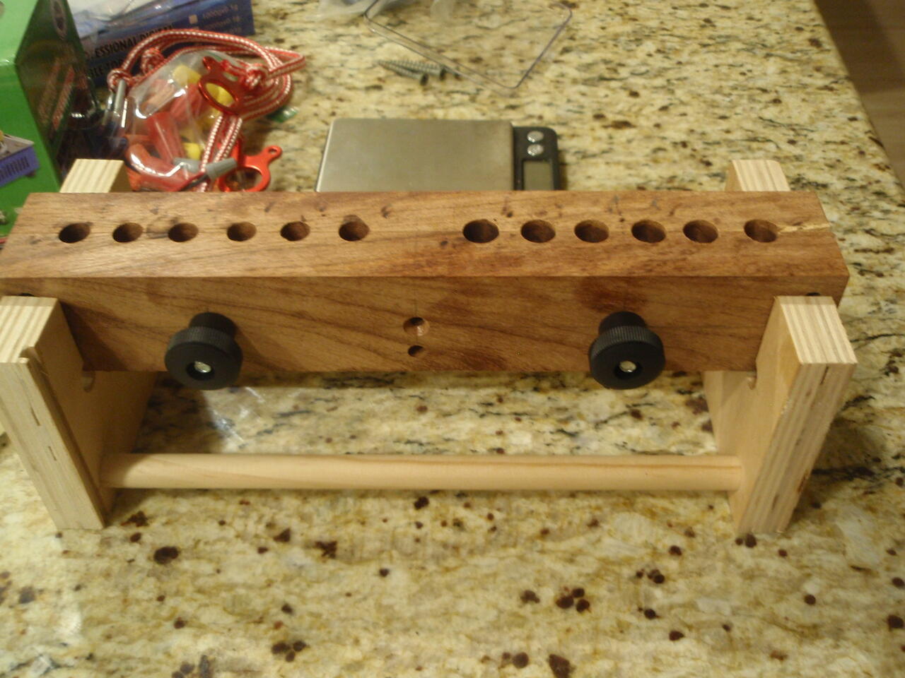

      Made a new mold, using what I learned from the first and doubled the density so a 11" mold could hold 12 - six each 3/8 and six 1/2 ounce bullet weights with the through hole.

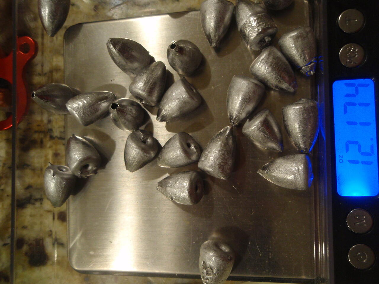

      I didn't know the exact profile so I cast a sample a bit smaller than I thought and then calculated how much deeper I had to go knowing the delta weight per inch because I did know the diameter once past the curved part. I ended up averaging .37 and .47 oz for the 3/8 and 1/2 ounce target sizes so that worked OK.
      Had to make another set of draw wires
