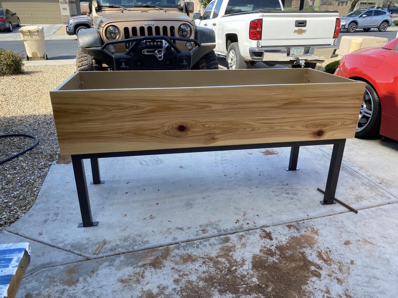

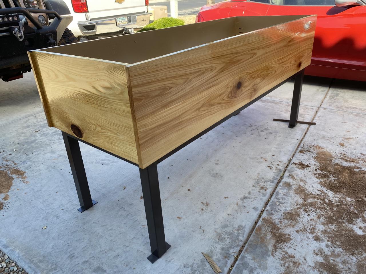

    Elevated planter
    The top is solid Cypress with the outside finished in three coats of tung/varnish/solvent mix rubbed on, then three coats of marine urethane sprayed on. Inside it's got three coats of a PPG primer/sealant. The bottom of the box is made from pressure-treated lumber. The base is just generic steel tube, primed, then painted with a bronze/black hammer finish paint. Looks spectacular in the sun. It will be an herb garden at my friends' house.

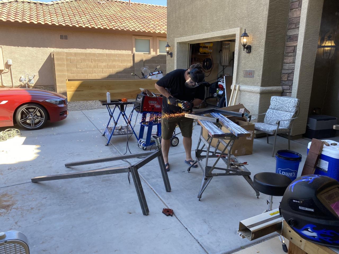

        The snow here was almost melted and it snowed again today ... and you're wearing shorts!
        Sorry about my weather meltdown. The planter is beautiful and the Cyprus is stunning. I'm certain your friend will love it.
        • Carlos
          • 1893
          • Phoenix, AZ, USA.
          Hah, that was my friend working on it. I was wearing jeans. They day started at a chilly 68. Brr.

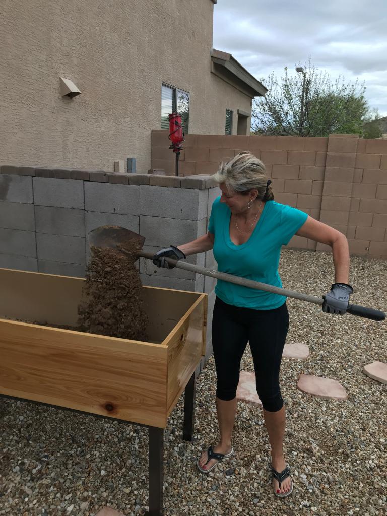

            His wife is filling it as we speak. Mix of dirt and garden soil, we've heard is the best fill for herbs here. At our house, we did raised planters on the ground and just tilled in some garden soil and manure. They grow like weeds.

              That’s a lot of dirt to fill the planter. It shouldn’t move around!

                I see you have some kind of reinforcement in the corners.
                I'd consider dado joints to ensure it can handle the weight.
                That's a lot of dirt.
