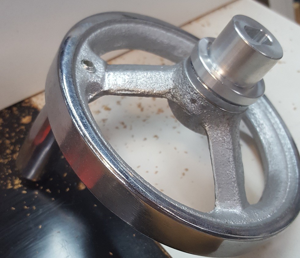

      Unfortunately the BT3 designers chose a odd shaped non standard shaft end for the crank.
      No commercial crank fits, But you can buy equivalent cranks for$10-20 bucks, don't pick one oversize because the handle will interfere with the rip fence handle when you least want it to.
      There is a fairly easy adapter to fit the shaft to a 1/2" dia. ID crank handles. Shown here on a Grizzly handle I bought, too.

      I documented one I bought commercially for the day when and if my OEM handle breaks. But I have not had to use it.
      https://www.sawdustzone.org/forum/di...dapter-drawing
      Someone should be able to make one 3D printed, but it would still be plastic.
      I figure by having the spare parts on hand I can dodge the bullet.

        There are 3D printing vendors that will print in metal, if one prefers. There are also online vendors that will machine parts from metal. Since there is an existing drawing, it should not be difficult to have the part made in metal.
