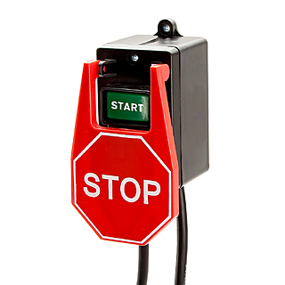

      When I had a switch fail on mine many years ago and the replacements were backordered, I hardwired my saw to on and plugged it in to one of these available from Rockler. I eventually put in the real replacement switch. This is now on my radial arm saw which has had a wonky switch since the mid 80's.
      https://www.rockler.com/safety-power-tool-switch

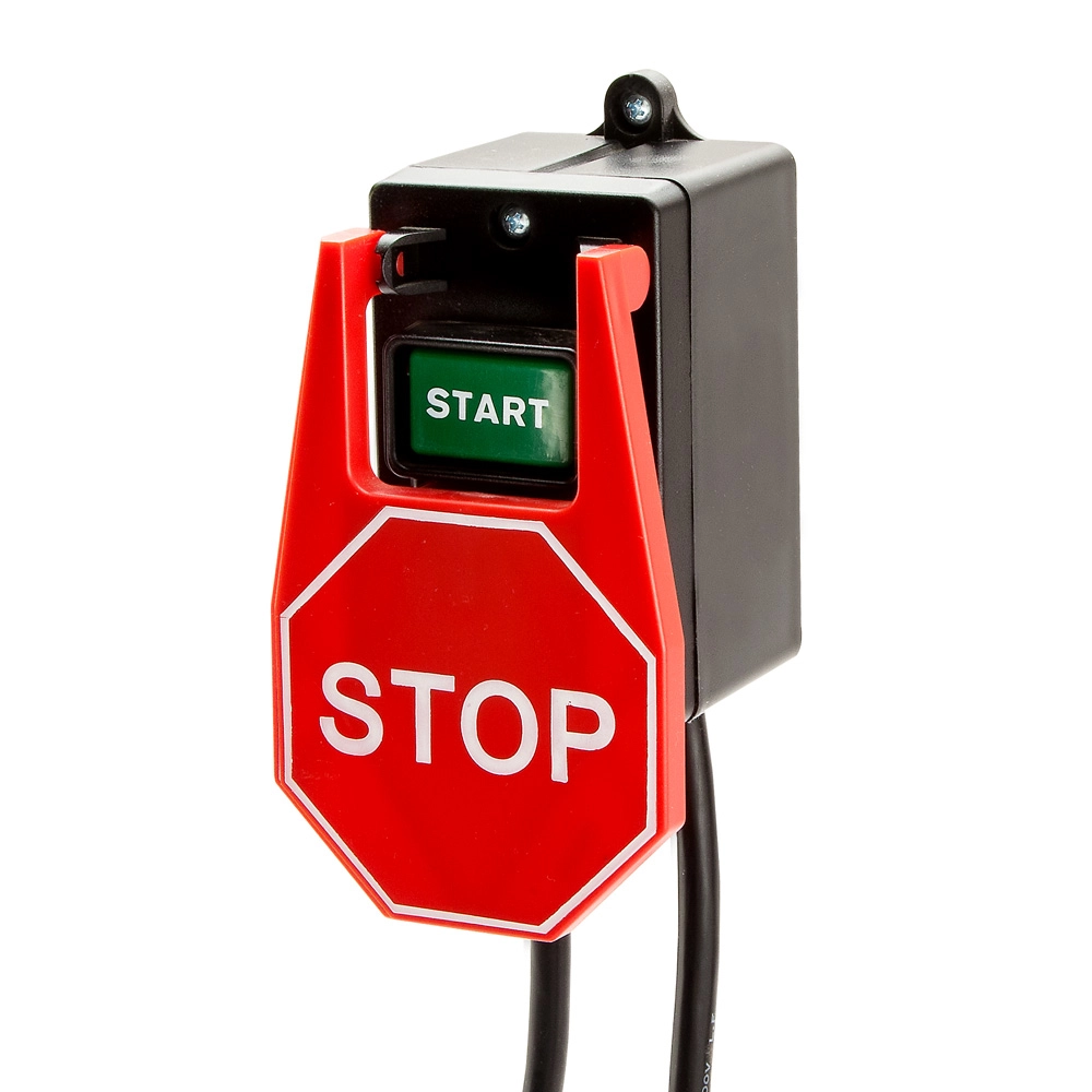

        • Another thing you can do is get a power tool switch. Just search replacement power tool switch on Amazon, make sure you get one rated for 15A and has a safety lift to turn on, big red press to stop paddle. You can wire it into your saw to replace the switch with some modification or mount it in an external box. some people mount them to the underside of the front rail. Maybe some extension wiring of an appropriate gauge (14 ga. or larger diameter)Click image for larger version  Name:	image.png Views:	0 Size:	651.1 KB ID:	863580

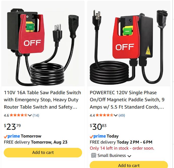

              if you want a switch with improved safety, then get one of those magnetic tool switches.
              They have the feature that when you turn it on it electromagnetically (with its green switch) it latches in the on position and turning it off (with the red switch) releases the electromagnetics and switches off.
              The safety feature is that if power is interrupted then the electromagnetics is also released and the switch will go to the off state and not pass power until the green start button is pushed. It will not fire back up when power is restored at the circuit breaker or the power company. In other words it shuts the machine to the off state if there is any power cut off from outside sources. Including one that kills the lights. You can be fumbling around in the dark but don' have to be afraid the lights will come on and the saw will bite you.
              THe standard switches stay in the on position after a power failure and will start right up when the power is restored, if you are ready or not..
              Here at Amazon I found three types, one a box you can wire in, one with male and female cords you can plug into, and one you can mount in the panel.
              Click image for larger version  Name:	image.png Views:	0 Size:	165.5 KB ID:	863588
