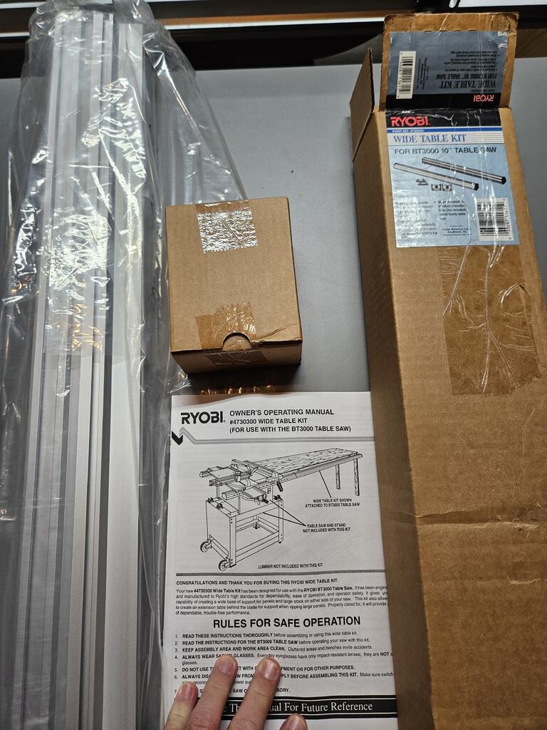

          Hi everyone. As a new member, I wasn't allowed to reply right away. I finally Googled the right terms and found pics of the rails for the wide table kit. I assumed it would be an entire table, like the folding one I have attached on the back of the saw. So, knowing what to look for, I dug through more stuff from dad and found the extension rails!! Now, I just need a bit more space around the saw. The box was never opened.

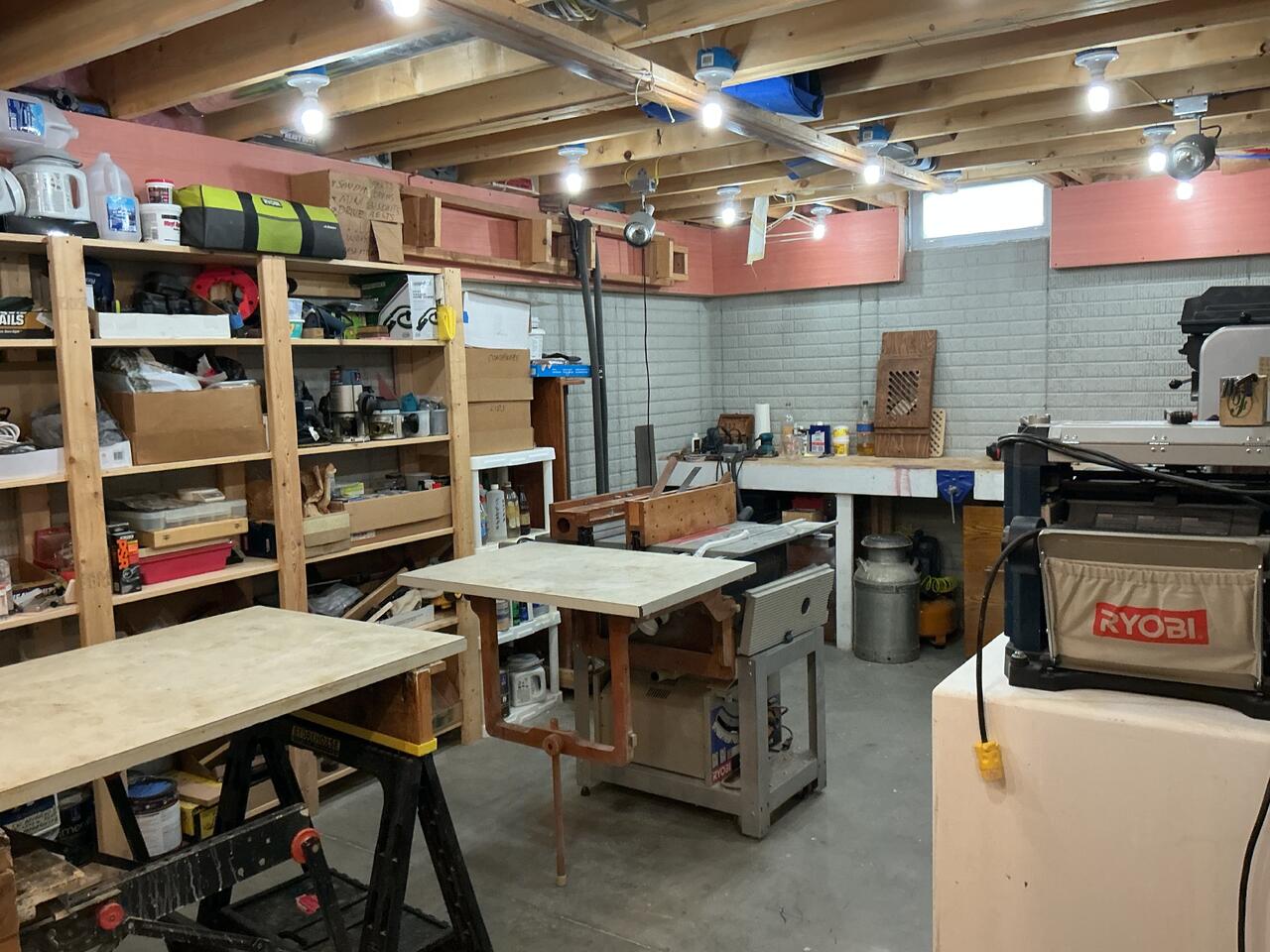

              This is how I do wide sheet goods on the BT3000. The system will handle 48 inch wide stock as designed. The setup in the first picture was used to crosscut 60 inch wide stock. I also have a moveable 30 inch by 48 inch table located behind the folding outfield table for long work pieces. But to reduce sheet goods length, I use a hand held circular saw, a guide, and some 2x4s laid on the floor.
              Click image for larger version  Name:	IMG_0097.jpg Views:	0 Size:	76.0 KB ID:	863480 Click image for larger version  Name:	IMG_0087.jpg Views:	0 Size:	181.2 KB ID:	863481

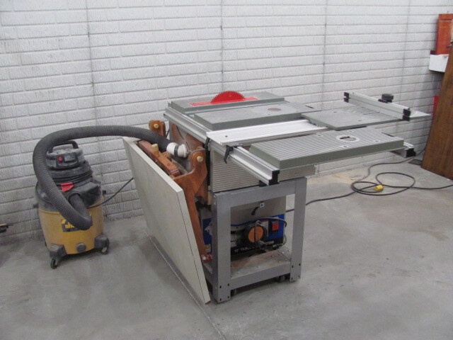

                Use the site's SEARCH feature to look up posts on the wide table kit and various infeed and outfeed tables folks have posted over the years. What I used to use on my BT3000 with a wide table kit when handling plywood sheets is pictured on post 9 of this thread:
                MPC's infeed and outfeed tables
                I used flat bar stock and square tubing material to make brackets that fit into the bottom T-nut slots of the BT3's fence rails. These can slide left/right to match whatever size panel I was trying to cut. Their length is such that, when folded, they hang down from the rails without touching the floor so I can still roll the saw around. I still have these but I don't use them anymore. Why not? Like others have said, sometimes it is better to cut big sheet goods using a different tool. There is an old adage in woodworking: "sometimes it is better to take the tool to the work than to take the work to the tool." Trying to manhandle large/heavy workpieces on BT3 saws, other benchtop saws, and most contractor table saws can be difficult/dangerous. The stock BT3 fence isn't long enough when trying to rip long sheet goods; it is easy for the workpiece to drift or rotate a tiny bit... that is enough for it to bind on the back of the blade and create problems including damaging the saw. Having to lift/support a large/heavy sheet at the start of a cut is risky as well: your attention is now divided between trying to hold the sheet flat and parallel to the saw tabletop and against the rip fence as you feed it. Hence my original infeed tables. They supported the weight of the sheet and provided an area I could walk into as the cut progressed so I never had to lean over at an awkward/dangerous angle. And the outfeeds supported both parts of the cut workpiece.
                The wide table kit includes parts to join the extension rails to the original rails; these use the T-nut slots along the bottom and inside faces of the rails. My large infeed and outfeed tables also use the bottom slots so the Ryobi parts would sometimes get in the way. I didn't have them originally... like others have posted you can use flat bar stock and screws to make your own rail jointing gizmos. I did that for a while and then made wood + aluminum channel versions that fit inside the rails; countersunk screws from the outside of the rails into these pieces lock the rails together. This kept the slots free for my infeed and outfeed tables. See my posts in this thread:
                MPC's rail jointing pieces
