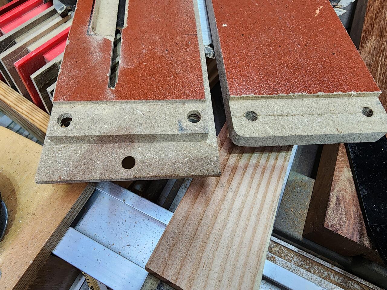

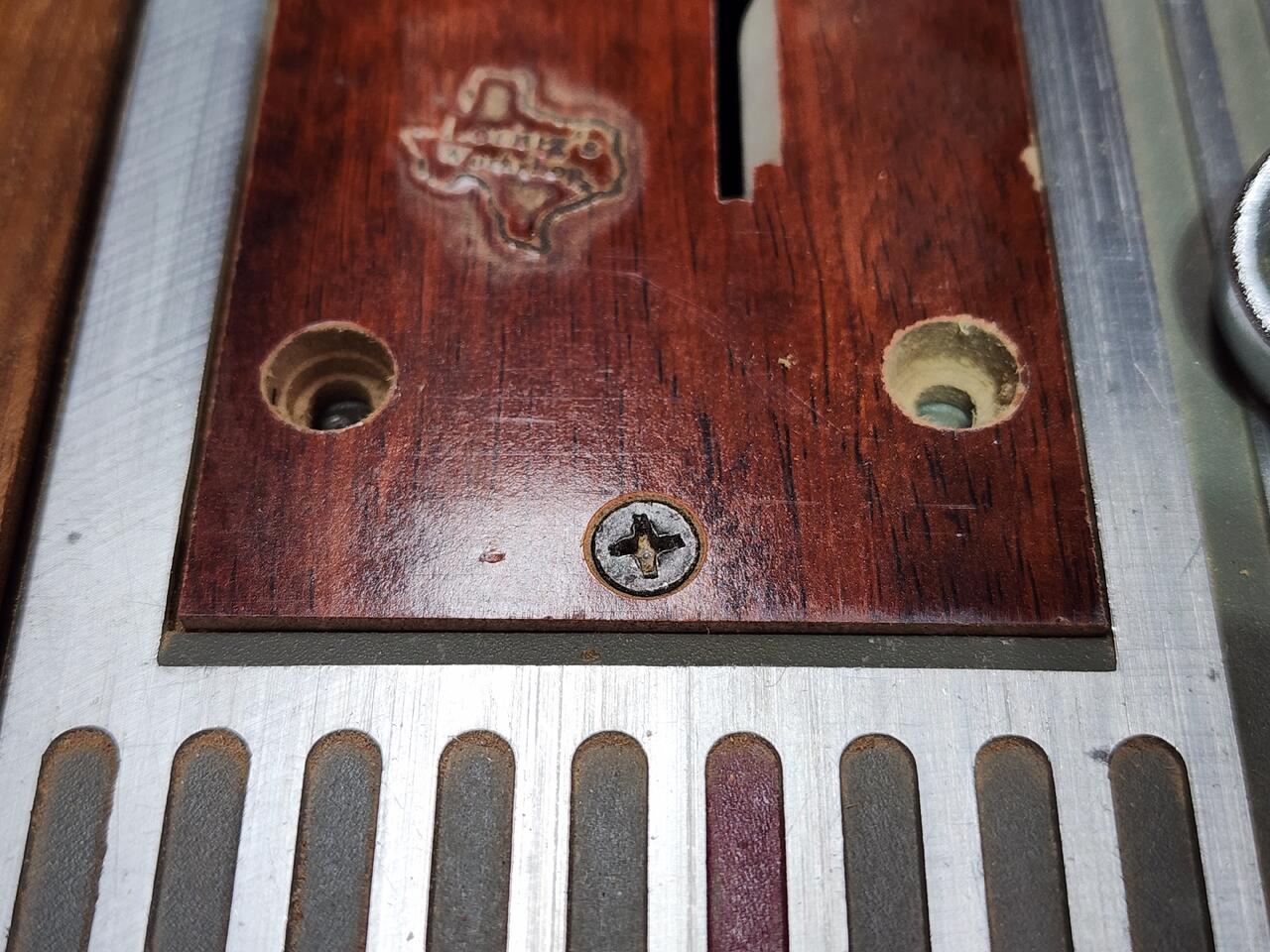

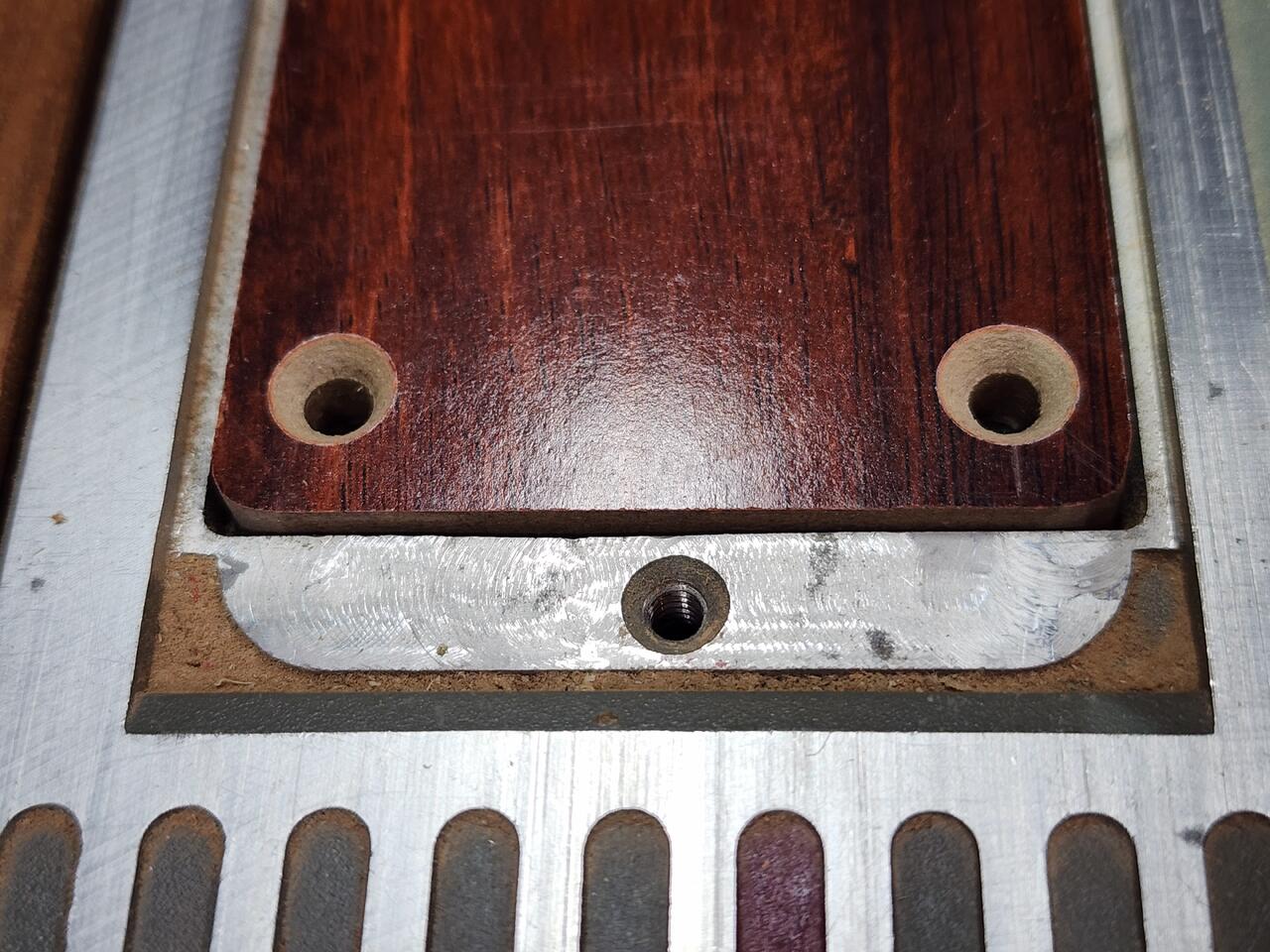

    New ZCTP.
    Click image for larger version  Name:	20260216_230823.jpg Views:	0 Size:	174.8 KB ID:	862706
    Used the four hole mounting pattern

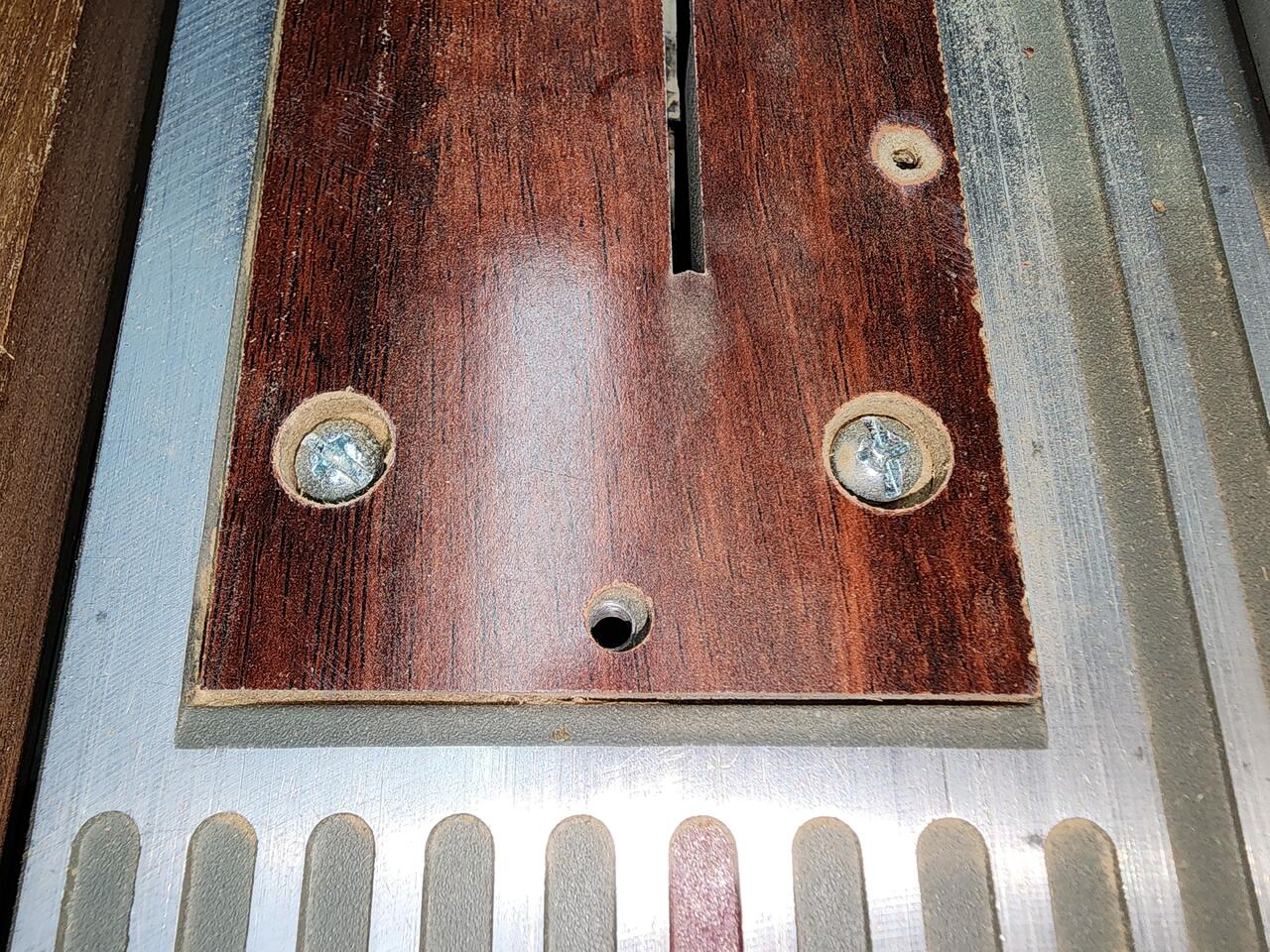

    Click image for larger version  Name:	20260216_230840.jpg Views:	0 Size:	332.9 KB ID:	862709
    made more than one.

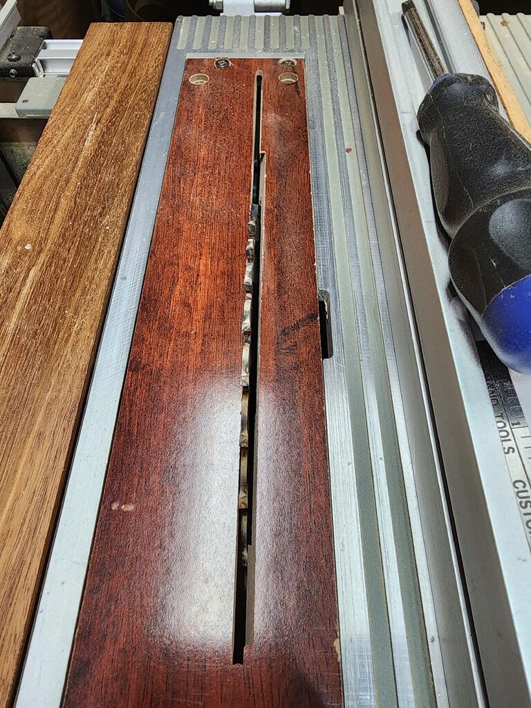

    Click image for larger version  Name:	20260216_230942.jpg Views:	0 Size:	228.6 KB ID:	862707

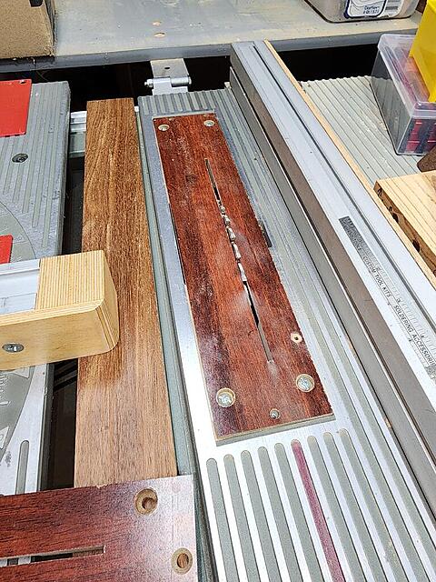

          I tilted the blade 15° and raised it into the zctp. Results in a small opening to the right of the blade, which can be ok since thin cutoffs usually happen to the left of the blade.
          I couldn't tilt the blade more than 30 degrees, not sure at this point why. And I will need to bevel the area for the riving knife. P.S. The blade is hitting something on the ZCTP past 30 degrees; it goes to 45 without the ZCTP in place.
          Final thought - the slanted opening to the right is a chance for a thin cutoff to wedge between the ZCTP and the blade... bad.

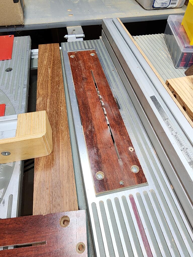

          Click image for larger version  Name:	20260220_182354.jpg Views:	0 Size:	191.7 KB ID:	862715

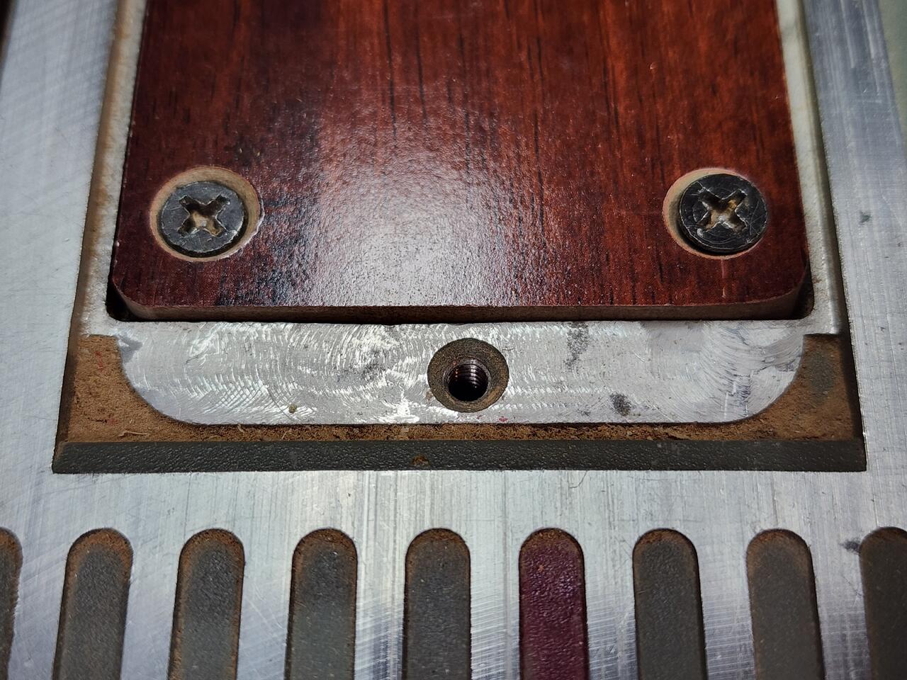

                  More thoughts on ZCTPs for the BT3x00 saws.

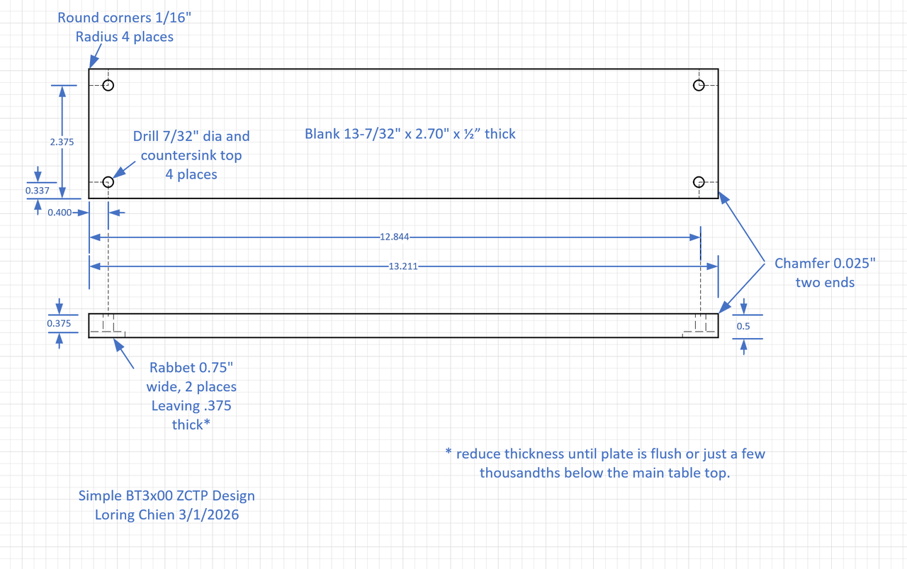

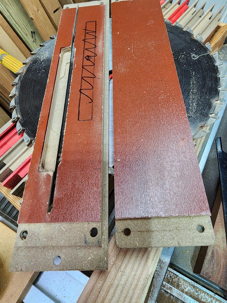

                  The profile of the replacement plastic ZCTP is kind of complex to make and machine and you have to keep some tight tolerances and trial and error to get it to sit flush with the saw main table. I have this thought for a vastly simplified ZCTP. In the picture below, on the left is a wooden plate that matches the plastic ones sold by Ryobi. It requires a rabbet down both long sides, a rabbet across the end and a second rabbet above that.
                  Click image for larger version  Name:	20260301_155406.jpg Views:	0 Size:	281.5 KB ID:	862744
                  The one on the left is a prototype of a simplified ZCTP. As you can see, the sides are flush cut and the end requires just one rabbet (identical on both ends). Much simpler to build. And it eliminates countersunk screws in the very thin ends which distorts the ends and leads to their failure.
                  The lack of the extra rabbets causes some depressions in the table top.
                  Here is the fit of the full plate:
                  Click image for larger version  Name:	20260301_155530.jpg Views:	0 Size:	191.4 KB ID:	862746
                  and here is the fit of the simplified plate:

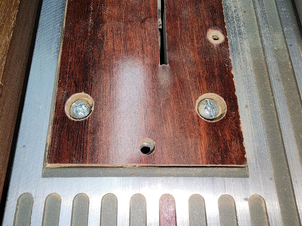

                  Click image for larger version  Name:	20260301_155247.jpg Views:	0 Size:	210.5 KB ID:	862743
                  The difference is, you have to use the four hole pattern, and you get some thin and shallow recesses circled in red, about 1/10th of an inch deep.
                  I think it won't matter, there are small depressions between the grooves on the top and the length is much shorter or thinner than any workpieces will be to fall in. Shouldn't be a problem.
                  Click image for larger version  Name:	image.png Views:	0 Size:	1.92 MB ID:	862747
                  Click image for larger version  Name:	image.png Views:	0 Size:	230.7 KB ID:	862748
                  Construction notes:
                  You still need to be pretty precise with this to fit. I dimensioned the hole locations from one corner - I found it pretty difficult to countersink for flat head screws. Better to drill the hole a little oversize (1/4") and counterbore .18" deep to cover a round head screw; gives more wiggle room.
                  The four-hole mounting bosses seem to be exactly 3/8" below the top surface of the table. What I did was get close with the router (13/32") and then use a small rabbet plane to knock off a little bit until I could slide a straight edge from the table to the ZCTP without catching.
                  The drawing indicates a small chamfer on the leading edge of the ZCTP; I don't have it on my pictures but I will put one there to ensure that workpieces don't catch as they are fed to the blade.
                  Don't forget, if you plan to gut the slot for the blade that the blade comes within 1/4" of the table top when lowered to the bottom; you need to route a groove leaving about 3/16" thick material over the blade if planning to raise the blade to cut the ZCTP so you don't trap the blade and break your belts!!!
                  The material I used was some laminate wood flooring someone tossed out. Half an inch thick, laminate over some composite wood stuff.
