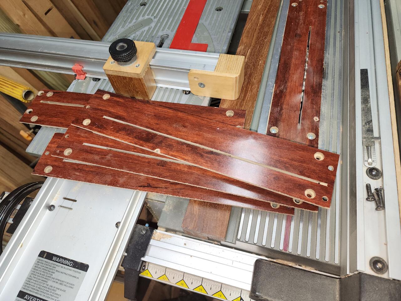

    New ZCTP.
    Click image for larger version  Name:	20260216_230823.jpg Views:	0 Size:	174.8 KB ID:	862706
    Used the four hole mounting pattern
    Click image for larger version  Name:	20260216_230840.jpg Views:	0 Size:	332.9 KB ID:	862709
    made more than one.
    Click image for larger version  Name:	20260216_230942.jpg Views:	0 Size:	228.6 KB ID:	862707

          • 21968
          I tilted the blade 15° and raised it into the zctp. Results in a small opening to the right of the blade, which can be ok since thin cutoffs usually happen to the left of the blade.
          I couldn't tilt the blade more than 30 degrees, not sure at this point why. And I will need to bevel the area for the riving knife. P.S. The blade is hitting something on the ZCTP past 30 degrees; it goes to 45 without the ZCTP in place.
          Final thought - the slanted opening to the right is a chance for a thin cutoff to wedge between the ZCTP and the blade... bad.
          Click image for larger version  Name:	20260220_182354.jpg Views:	0 Size:	191.7 KB ID:	862715
