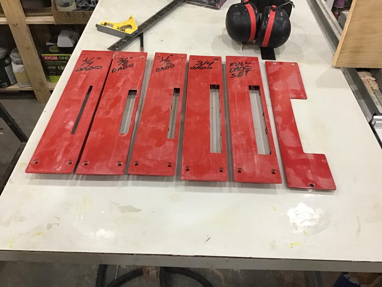

              A long time ago, I scored a bunch of blank Ryobi ZCTPs, so over the years, I've cut several for common dado setups. The plate on the right is the factory steel dado plate which I've never used. The underside of the plastic plates have been filled with leftover epoxy from other projects. This was done to stiffen the plates. I cut the slots longer than the exposed portion of the dado stack to provide some airflow space for the stack. I use an 8" Freud Super Dado set.

              This brings back an unpleasant experience I had with these ZCTPs. I mounted a blank one to cut a slot for a new thin kerf saw blade. With the blank plate screwed in place I started the saw in preparation for slowly raising the new blade up through the plate. Unfortunately, I hadn't completely lowered the blade and it was firmly stuck in the underside of the new ZCTP. The motor spun the drive shaft, the belts didn't move and melted completely through in seconds from the friction. Stupid human trick number XXXXXX.
