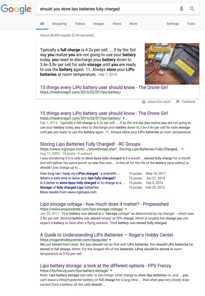

          Here's a start for your research:
