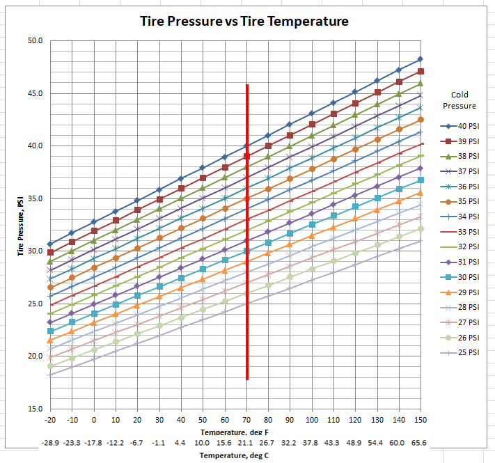

                this SDZ post I posted a chart of how car tire presures vary with temperatures. approx every 12 deg F makes a PSI difference.
                https://www.sawdustzone.org/forum/di...ature-my-chart
                Click image for larger version  Name:	image.png Views:	0 Size:	105.3 KB ID:	863525

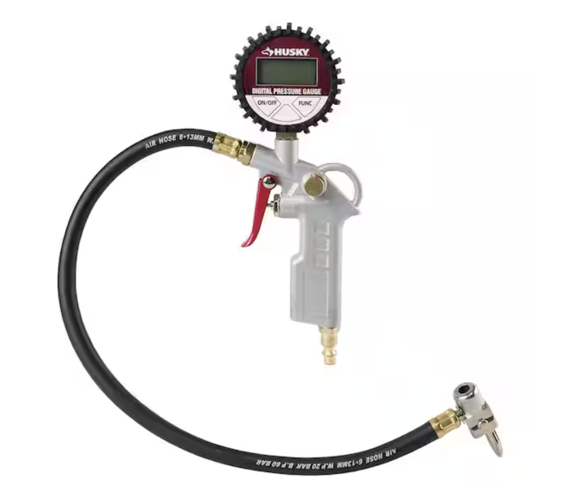

                    I got something like this for my garage air compressor and 50 feet hose.
                    Once you clip it to the tire it reads the pressure you can add air with the lever or you can let air out with the button or reversing the lever.
                    While the air is flowing it reads the hose pressure before the valve, but release the lever and it reads the tire pressure directly.
                    Very useful. They sell analog gauge ones but the scale is usually 150 PSI and hard to read for car tires around 30. The digital one has 0.1 PSI resolution.
