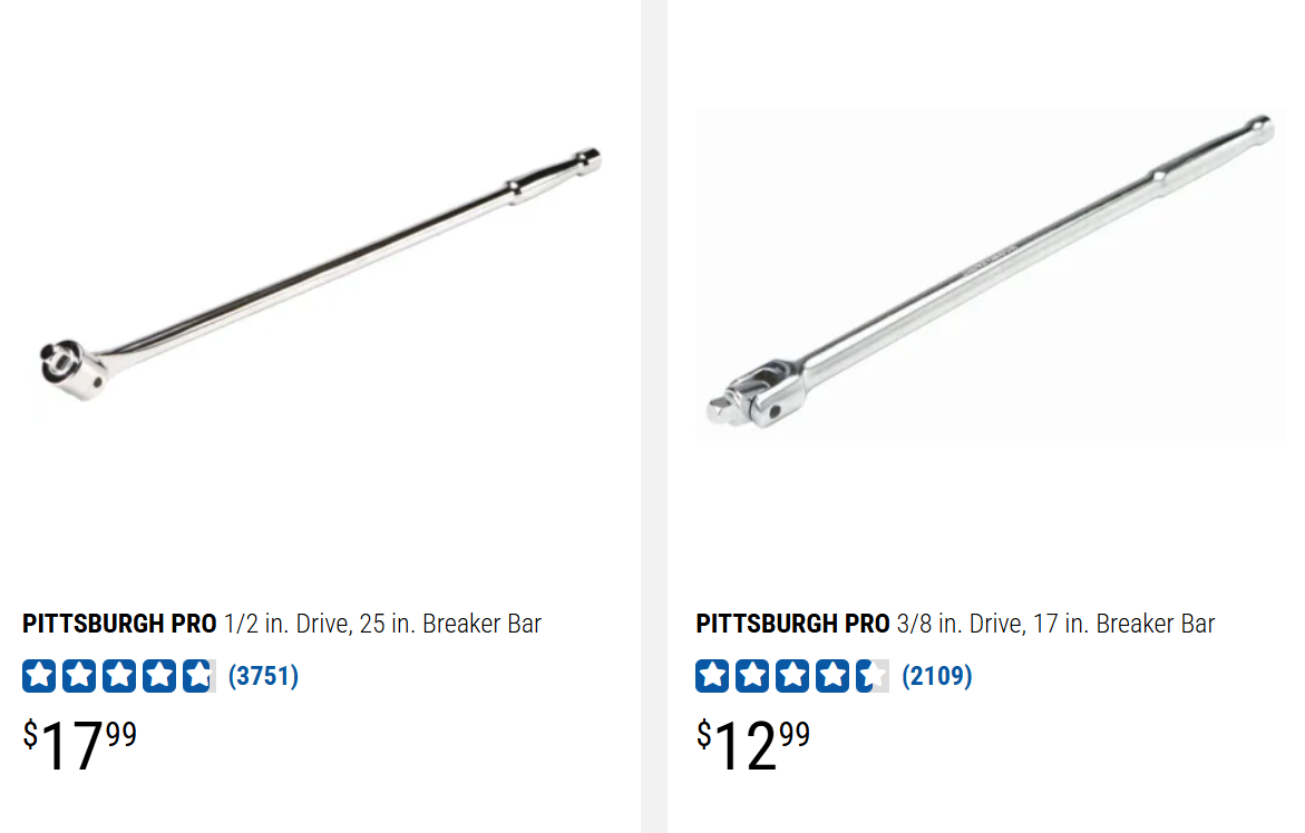

    Is that better than a 24 inch breaker bar?
    I think I have a 3/8 drive and 1/2" drive from HF, they were cheap on sale at one time.

      The diversity helps. Yes I have a couple of breaker bars, 3/8 and 1/2". In some cases there is just not enough room for a breaker bar. In my specific case, which I will begin in an hour or so, the area only allow only a 4 to 6 inch swing at the end, and the YouTubers use ratchet wrenches, which I have because it would take forever to use open end or boxed end and limited space for sockets. So a ratchet extension on a ratchet wrench would be ideal. The placement allows adjusting the length to the best length available for breaking and loosening the nuts.
      I don't yet have the two tools I posted above, but I am going to put the new shocks on the rear this morning. It would help but I will find a way to "break" the nuts from the bolts.

        Mathematically, a 25 inch bar is 4.167% better than a 24 inch bar
