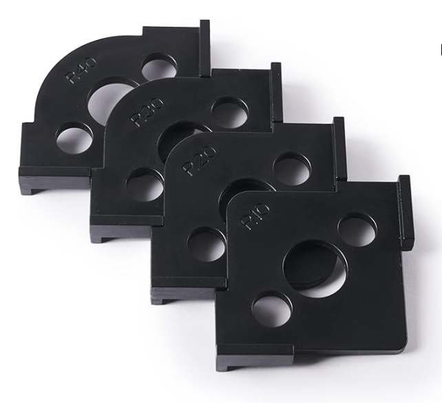

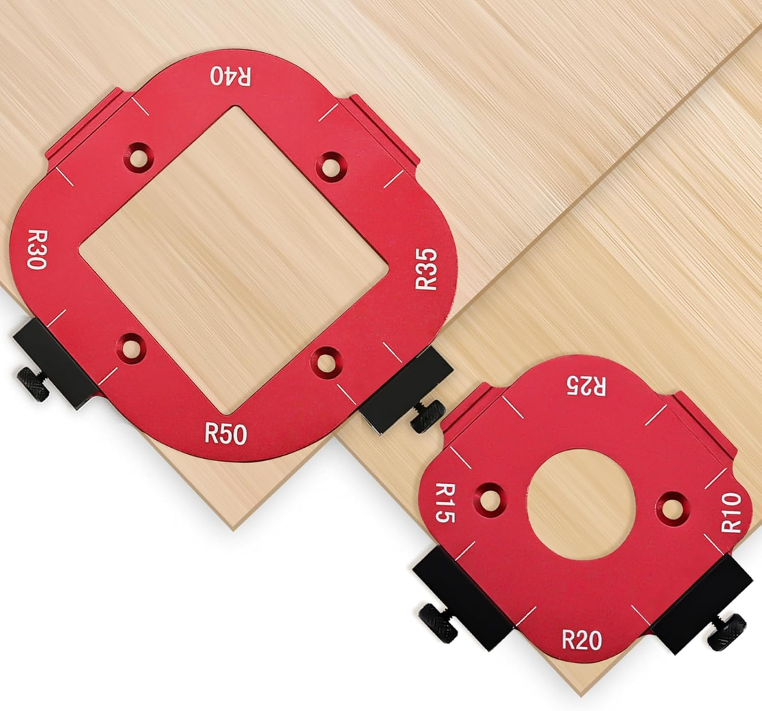

    Okay I got stupid browsing Temu...
    I was ordering something I needed, and they gave me a free pick of 4 things. One of those things I am NOT going to Temu link because Temu.... But these gizmos...
    https://amzn.to/47Xkbs4
    I figured they would make easy work of the corners of the replacement countertops for my RV, you know to keep from mashing a hip into a pointy corner at 3:00 stumbling around to the toilet kinda stuff...
    They take a countersunk screw to secure to the workpiece, and are supposed to basically let the bearing of your flush trim bit ride agaist it as you route away the corners...
    I don't want to put extra holes in my workpieces even if it is just the underside...
    Would carpet adhesive tape be strong enough to hold them securely while being able to cleanly remove after use?
    Oh for anyone interested. I have settled on Red Oak plywood for the countertop. Corners rounded, edges bullnosed, then any gaps filled, sanded, and smoothed, then I will start on the cutout for the sink and the stove...
    The workpiece is cut to size, my next step is the corners thus the question...

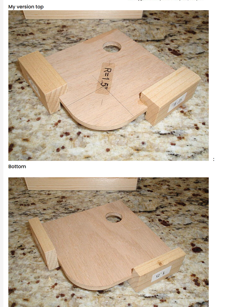

    **** I even made some in the DIY thread.
    #52 in this thread. https://www.sawdustzone.org/forum/di...-part-ii/page3
    Easy to make if you just need one size.
    If you want to buy something quick, Amazon has these sets for $12+ that have the edge built in.

ID:	861922Looking at the pictures again, On these, are the black items removable edge guides that are moved and fastened for each corner? In that case if you use the edge guides you don't need to tape or screw them down. And the edge guides give better registration ensuring that you won't get a small step in the edge from misalignment.
            capncarl commented
            Can’t tell, but it looks llike the black items hook onto a cleat on any of the 4 corners. I can’t see why a longer “black item” couldn’t be crafted or procured that would allow the template to be clamped to the workpiece on its flat surface.
          So yes, the black bits are the edge guides. For my application the R20 is appropriate, although SLIGHTLY large the R15 is just too small...
          The little thumbscrews adjust the edge guides in / out so you can insure flushness at the outer edges. I am trying to just keep the template from slipping once secured. I use the carpet tape with my plastic signmakers templates with no issues, just not sure about these since the are aluminum.
          My method with the signmaker templates is wipe the worksurface and the backside of the template with isoporpyl alcohol to remove dust and any oils before applying the tape. Guessing that should remain the same. Just wanting to be safe without making extra holes in this thin countertop....
            • 22109
            I assume R20 means radius 20 mm (close to 3/4") making the diameter about 1.5"
            Much of that Temu woodworking stuff is metric dimensioned and marked scales.
              LCHIEN yes, radius in MM so R20 is a radius of 20mm. So ~3/4" which is what I am looking for. Not huge, just not pointy.
