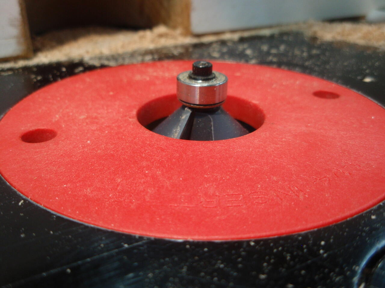

    I keep a 45 degree chamfer bit mounted. I lower it below the table top so as not to catch things on it as I frequently set work on the router table temporarily.

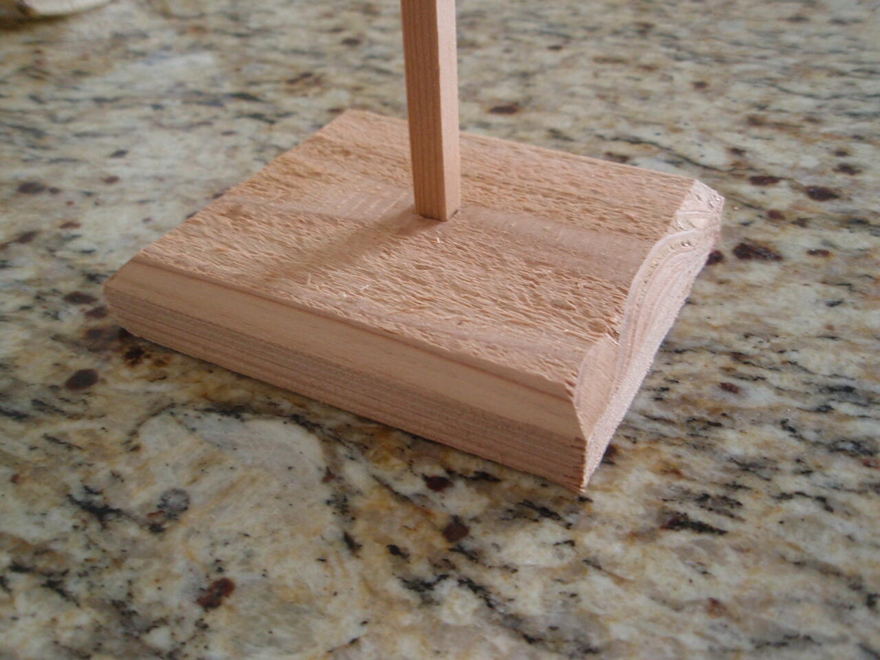

    Why? So I can put a quick professional looking finished edge on many things really quickly. I use the chamfer because I can readily adjust the size of the chamfer by raising and lowering the bit. Roundovers look nice, too, but you have to have a different bit for each size of the roundover, big items need bigger roundovers so there is no universal sized roundover I could use. Also the setup for a roundover is more critical, have to have the height just right to get the smooth edge without the "beading effect", although a proper beaded roundover can look nice, too.

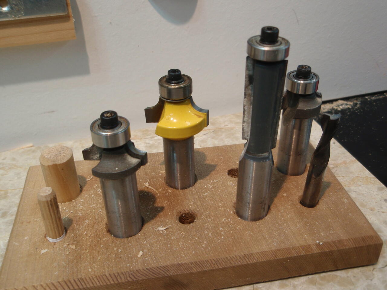

    I also keep a ready set of most popular bits handy... 1/4" spiral downcut, 1/4" roundover, flush trim, and the 45° Chamfer bit
